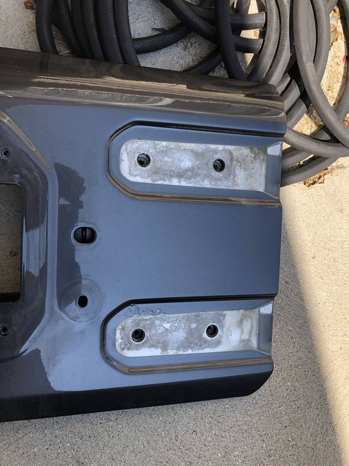

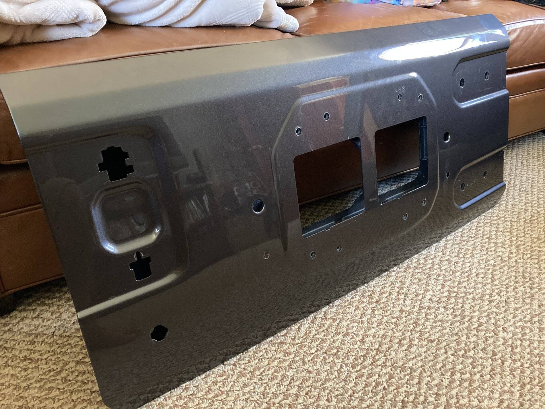

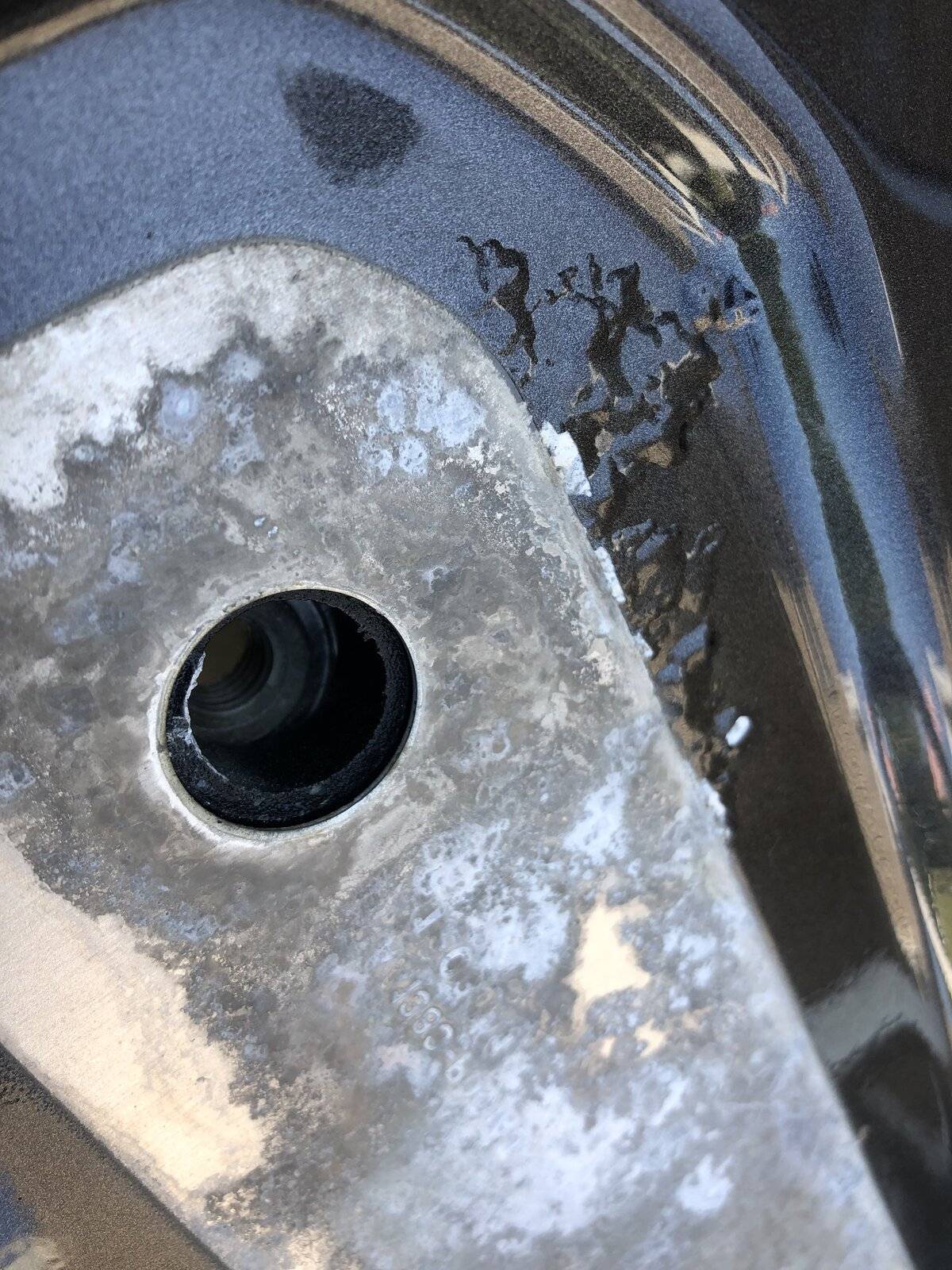

Had to replace my tailgate before they had a chance to fix (don’t ask). This is how bad it was. You can see upper hinge just starting. I am convinced all JLs will all do this at some point It starts at bare aluminum to paint interface.
This is what it gets replaced with. - done the RIGHT way! No factory shortcut of hanging PRIOR to paint.
goes to dealer for all door hinges Wednesday.
Won’t necessarily fix anything because bubbling has been documented at other places rather than just around the hinges

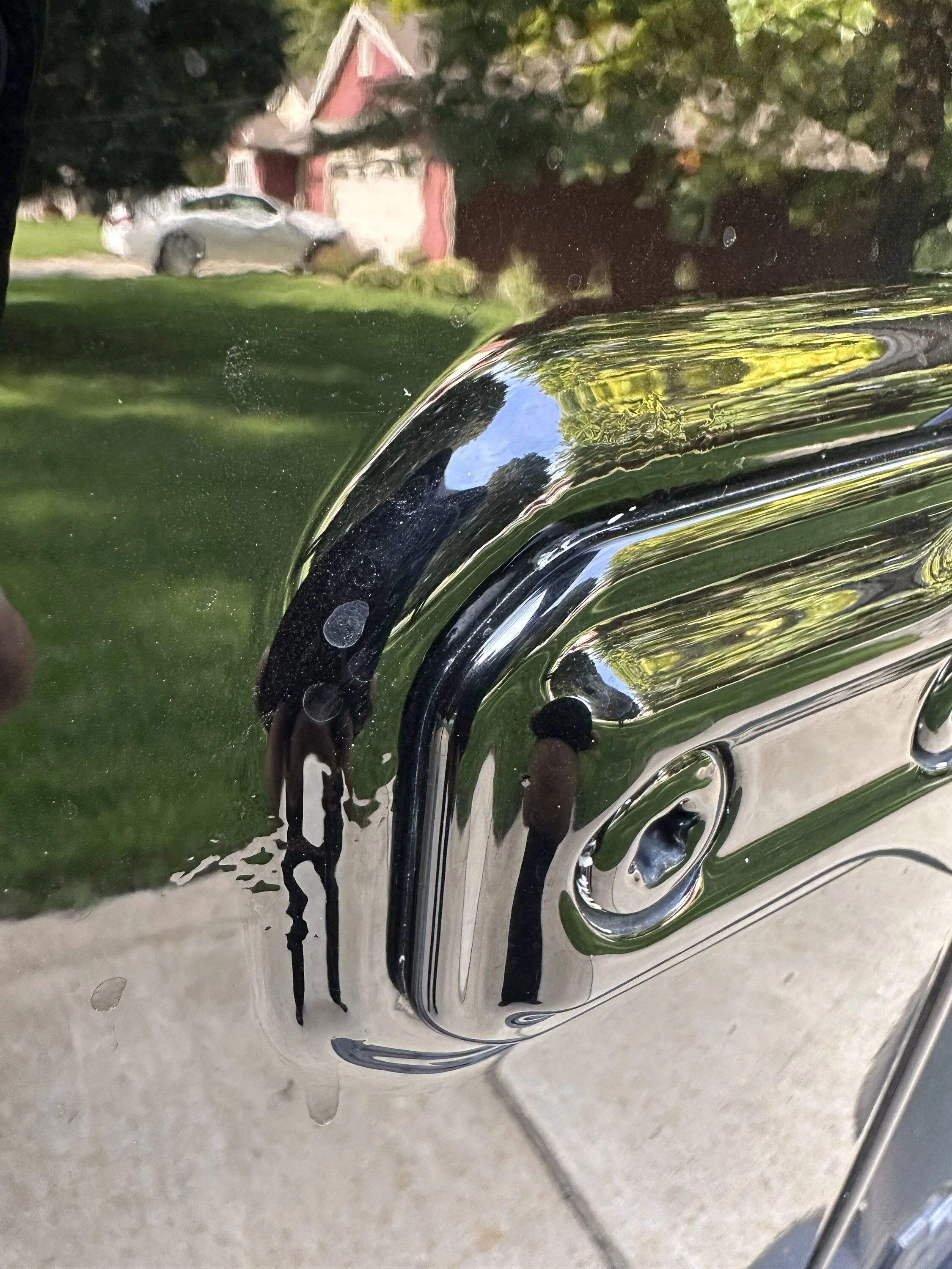

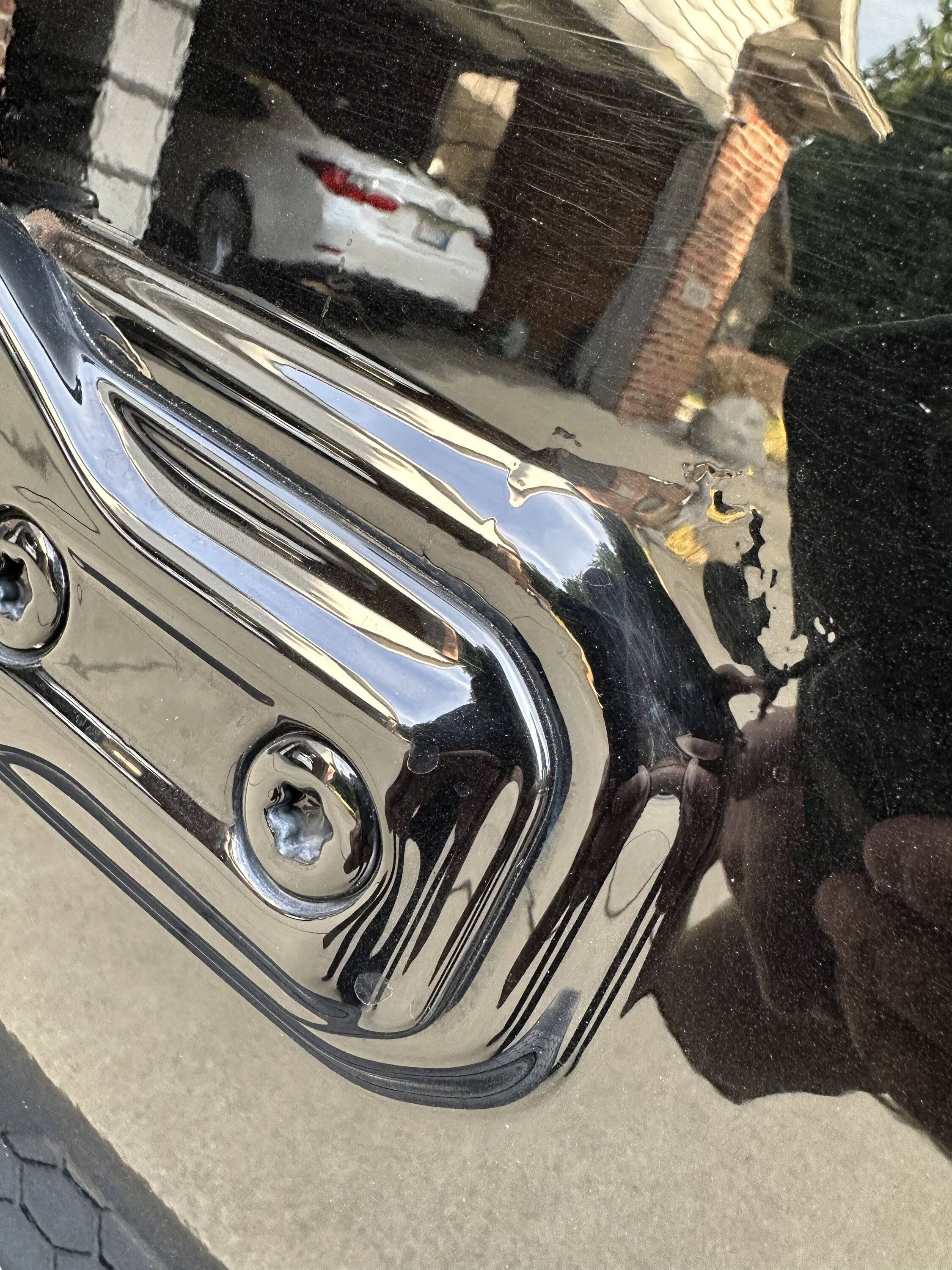

Literally Sick to my stomach. 5 months of not giving a crap @JeepCares!
2020 JLU Black and Tan. Noticed galvanic corrosion at 29K miles while waxing in June. All aluminum panels, all hinges, tailgate, hood, and door base… My Jeep is falling apart. Never off road. A business professional daily driver and kept immaculate. @JeepCares no they do not!
Far too much interaction with FCA/Stellantis for a post to convey, but went to file a claim the following day per Stellantis on June 7th. Was chastised by the dealer for “how little $ they make on these repairs. They would get to it when they had time.”
Coming from a manufacturing family of 40+ years, I was already aware of what it was and what was causing it. Yet Stellantis reps claimed I was one of the first they’ve heard of (lol). Service bulletins dating back to 2013 show otherwise. Class actions show much worse. Many FCA brands are affected for over 10 years and they continued to profit off lazy/faulty manufacturing.
By mid-July no claim filed and on my 4th rep from FCA/Stellantis. Tried multiple other dealers (originating dealer) and they wouldn’t help. Promises from Stellantis that they’d keep trying the dealers. No dice. Nov. was the earliest I could get a paint “fix” (if approved). Would not talk panel replacement. Dealer said “no way.”
Much research, and some panels are being replaced. Some aren’t. Painting will not correct the pitting and it will return unless new OEM parts (properly prepped and primed) are used. Raw aluminum with steel bolts are part of the issue, but all doors and all aluminum panels are affected in my vehicle, not just hinges. Horrible, shotty prep/paint work, period.
Disgusting treatment and denial of the issue. I reached out to the IN BBB, whom FCA refuses to work with (hmmm). Was getting nowhere with Stellantis, so I reached out to my AG office and they accepted my claim (to mediate). Stellantis immediately called to cancel my claim. This nightmare started over 5 months ago. Months of ignoring me and our AG letters. Only building my case for me, Stellantis. But @JeepCares - lol! Legal it will be then. Anyone know a good IN lemon law attorney?
I’m so done. Bought many, many Jeeps and Grand Cherokees over the years. Toyota/Lexus just gained a customer for life.
Trying to correct (mask) over and over, with the same parts/process and expecting a different result = insanity.

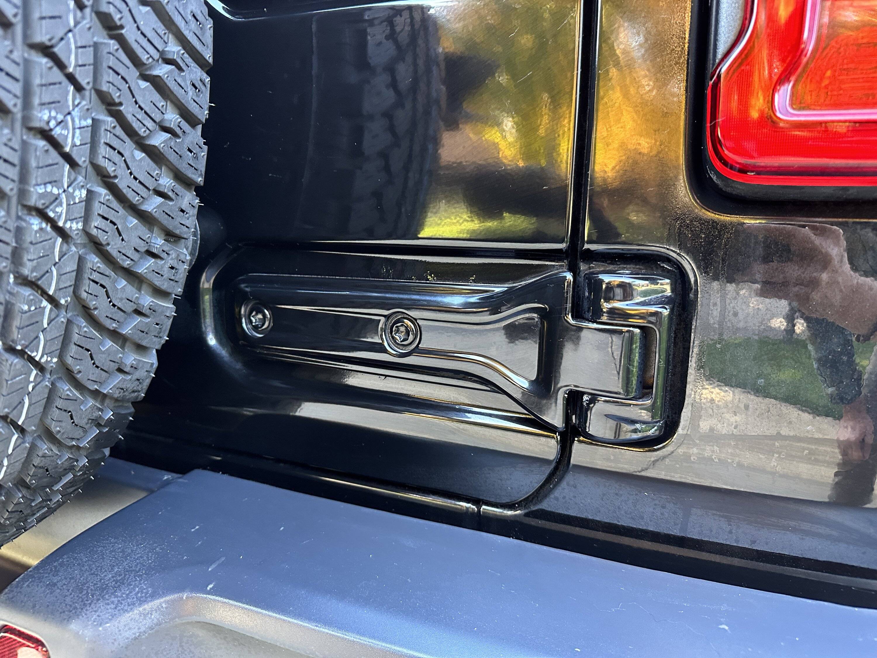

If Jeep has not confirmed a fix , then there is not one .
I doubt you will ever see a confirmed fix as that is an admission of guilt. What I did post here regarding my 2023, 392, is that there are now .015" gaskets between the hinges and aluminum skins. Whether they painted the surfaces first is anybody's guess. I am not inclined to start removing them. On my hood, which is steel, there isn't a gasket, however, I'm hoping that they at least painted the surfaces before assembly. The 2022 models I looked at did not have that .015 gap.
