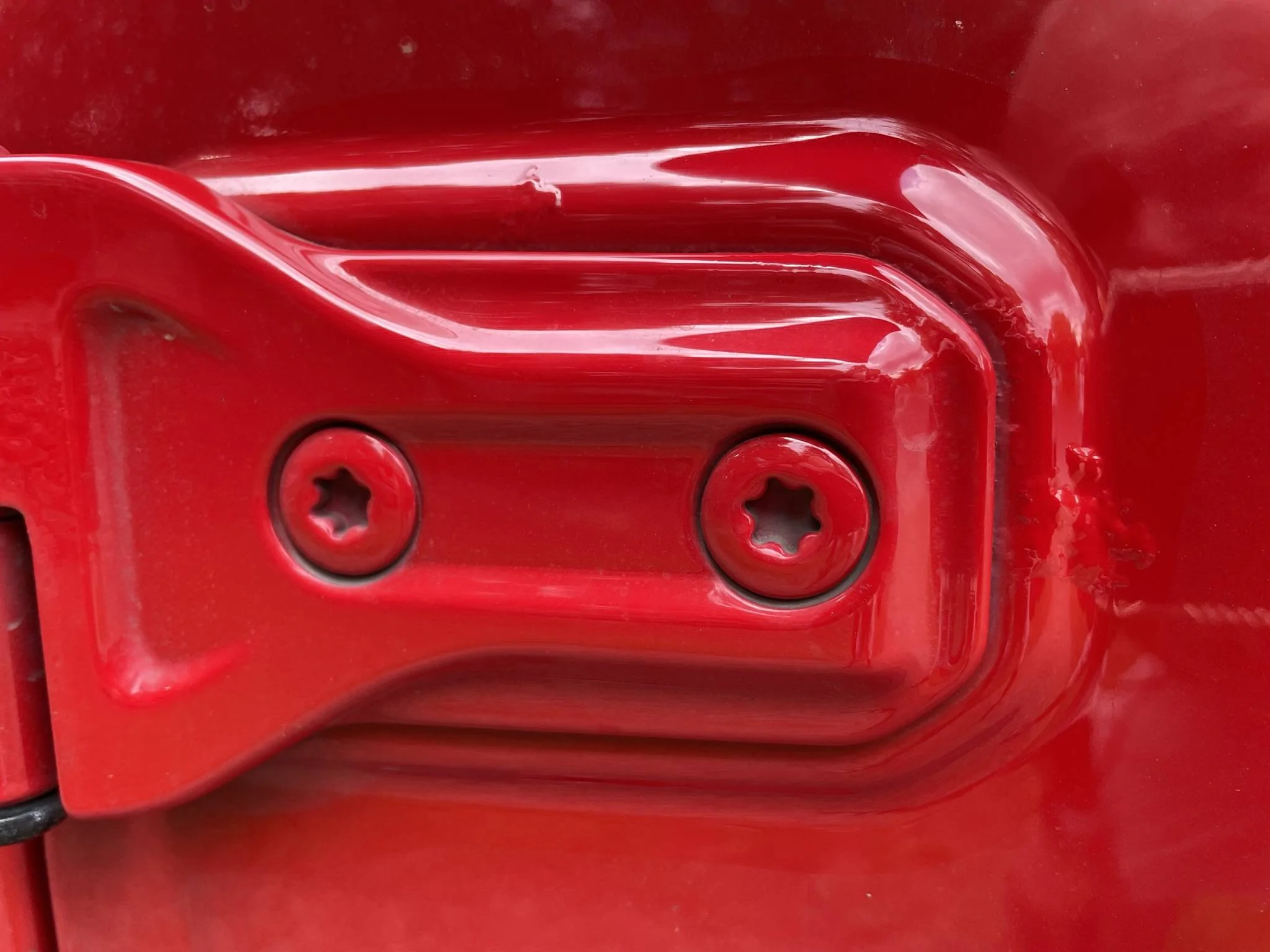

Yes, mine look the same as most. It's corrosion underneath the paint blisters, sooner or later they will POP and look even worse.Washed the jeep over the weekend and noticed small bubbles in the paint at one of the rear door hinges. I am over a year and have roughly 27k miles.They are hard underneath and the paint is not loose and pretty sure they were not there last time i washed the vehicle. It cant be rust under the paint since the doors are aluminum. All other hinges are fine. Has anyone seen this issue?

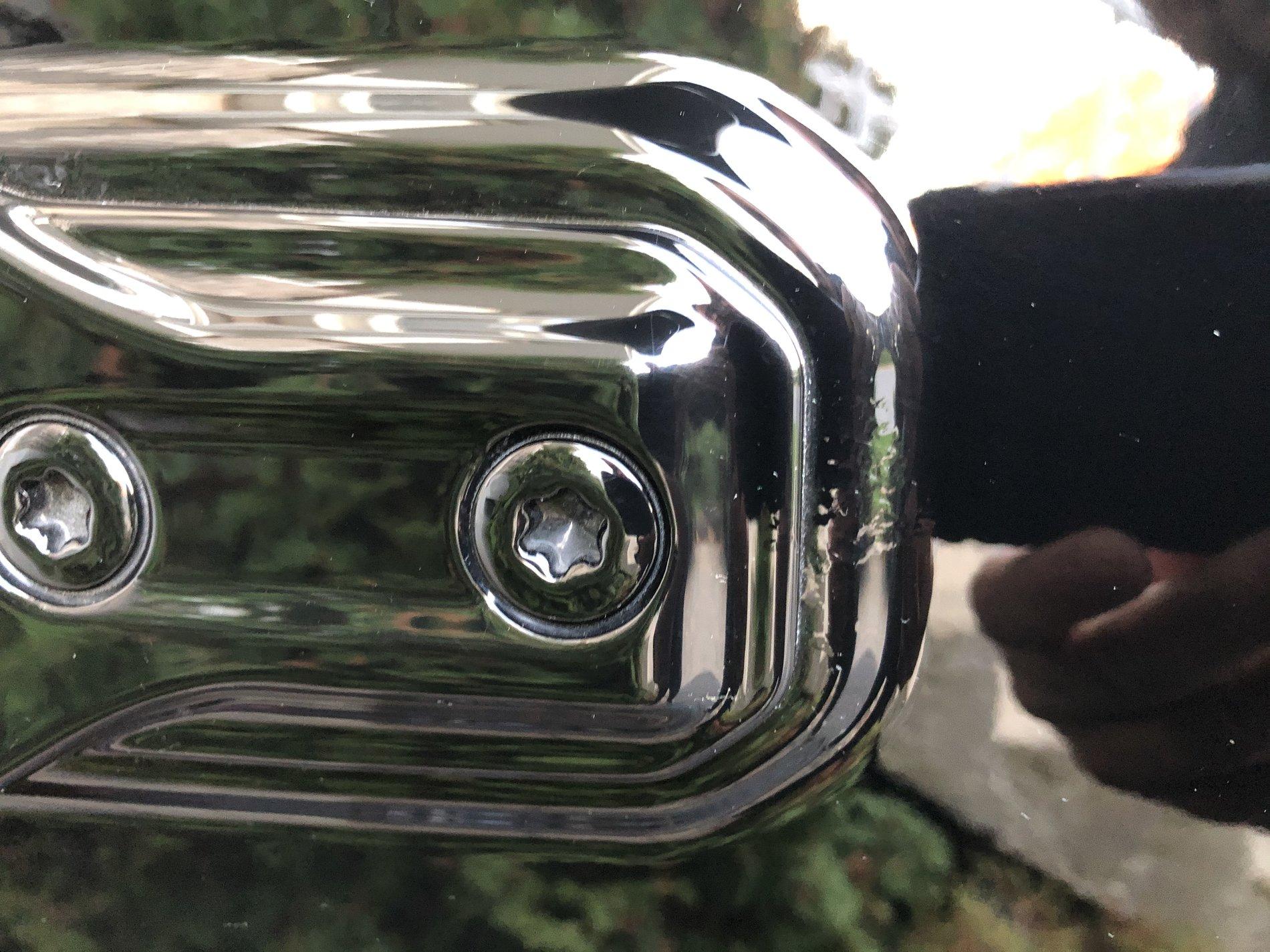

I checked my 2019 and the hinges are aluminum but the bolts are steel. So the connection remains unless they use a different bolt or an insulator.Here’s mine. I wonder how does the dealer preps the aluminium prior painting, to ensure that it doesn’t reoccur???
I wonder if installing Derlin hinge bushings would break the conductivity thus reducing the corrosion/ oxidation???

What's the explanation for the windshield frame bubbling? Aren't the hinges, bolt and frame all made from steel? How would galvanic corrosion be the cause if this is the case?![]()

Unfortunately, even if the frame is steel, the hinges are most likely aluminum same as the others.What's the explanation for the windshield frame bubbling? Aren't the hinges, bolt and frame all made from steel? How would galvanic corrosion be the cause if this is the case?

I wonder if removing the hinges, spraying with iron remover, cleaning the holes out and reinstalling the fasteners would work? However, this doesn’t solve the issue of the aluminum door, aluminum hinge and steel bolts….What I am seeing in the photos - and on our own 2018 Wrangler JL - looks like galvanic corrosion.
I believe the cause of this corrosion may be due to step(s) skipped in the manufacturing process.
When aluminum is machined (holes drilled for the door hinges, etc.) the steel cutting tools leave microscopic bits of iron on the surface of the aluminum. If not removed those bits of iron can create corrosion with the surrounding aluminum. Paint and primer will not stop this as it occurs UNDER the paint and primer (as we see in these photos). A gasket between the door and hinge may not stop this either as the problem is in the surface of the door panel itself.
Machined aluminum parts are typically cleaned with an acid bath called "pickling" which removes any iron particles from the surface. A "passivation" process is then typically applied to prevent corrosion before finally being primed and painted.
Since FCA previously made these door and hood panels out of steel they may have skipped the pickling and passivation steps (either to save cost or inadvertently) as those steps are typically not required with steel parts.
If this is the cause of the corrosion then FCA has a really big problem. Fixing it properly requires stripping the paint and primer down to bare metal; cleaning with acid, then washing, priming and repainting. That is a HUGE job that would have to be done on millions of Jeeps.
