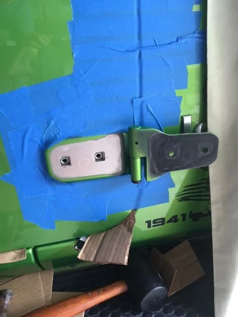

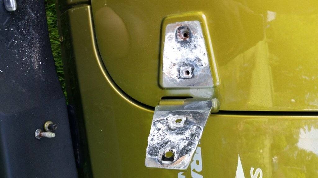

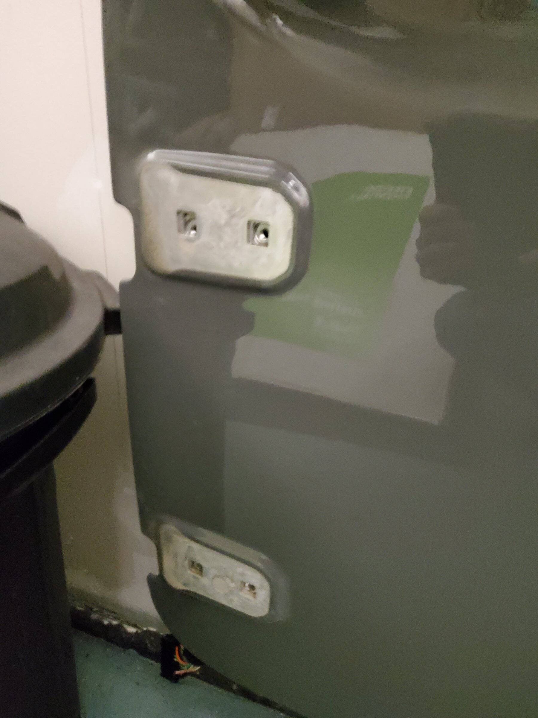

I wonder if removing the hinges, spraying with iron remover, cleaning the holes out and reinstalling the fasteners would work? However, this doesn’t solve the issue of the aluminum door, aluminum hinge and steel bolts….
Remove the hinges, coat the mating surfaces with something such as 3M undercoating etc or make a clear gasket from a PE milk jug. Then clean and coat the bolts with something which will insulate or possibly some spray galvanizing. The only potential contact beyond that might be whatever the bolts screw into. If it's a nut use an insulating washer. If not a nut you'll need to figure something out.
BRuby
Nov 28, 2019
754
897
Chilling or working out at 60+
JLUR Benz Porsche-M Subie-M
I go back to this post. If this is a steel nut not galvanized and not isolated from directly touching the aluminum door panel - you will likely get galvanic corrosion no matter what you do.
My speculations are that what looks to be rust on the nut - points to that it is manufactured from steel and not aluminum. If so therein lies the root problem. Easy to confirm with a magnet. This plus many steel bolt pins all conspire to a lot of points of contact where corrosion can progress. Add steel dust particles landing on pre-painted bare aluminum panels - and you get corrosion on the aluminum hood edge and bottom of the aluminum doors. The steel dust settles and accumulates at the bottom due to gravity. But sometimes may land and stick anywhere.
You are on the right track though. Leaving as is - ensures full corrosion progression unhindered. Most all JLs will probably suffer this unfortunate fate depending on prevailing geographical locations and atmospheric conditions. Wet and salt - faster. Dry and dusty - slower.
Speculations - but very plausible. Given how many JLs and other FCA vehicle models are affected according to the repair TSB. Please do not shoot the messenger.
https://www.jlwranglerforums.com/fo...nt-at-door-hinges.32756/page-139#post-1974694
Nice job! And the bare metal factory job of all things is inexcusable. The bolts are not aluminum, I had verified that on mine. You can purchase spray zinc coating ie galvanizing paint. I used some on my galvanized boat trailer after welding up a split seam. The nut appears to be fastened to the inside of the panel. Steel?
