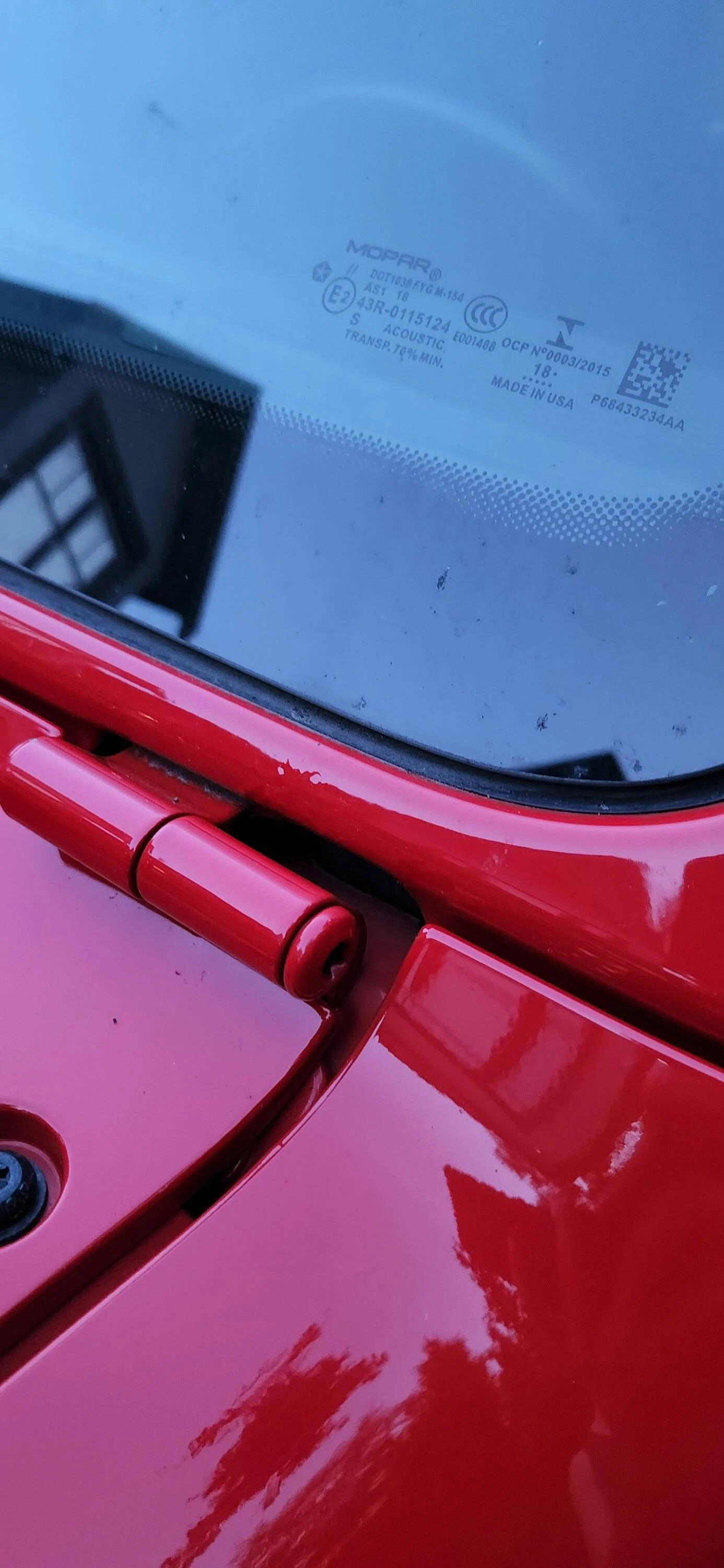

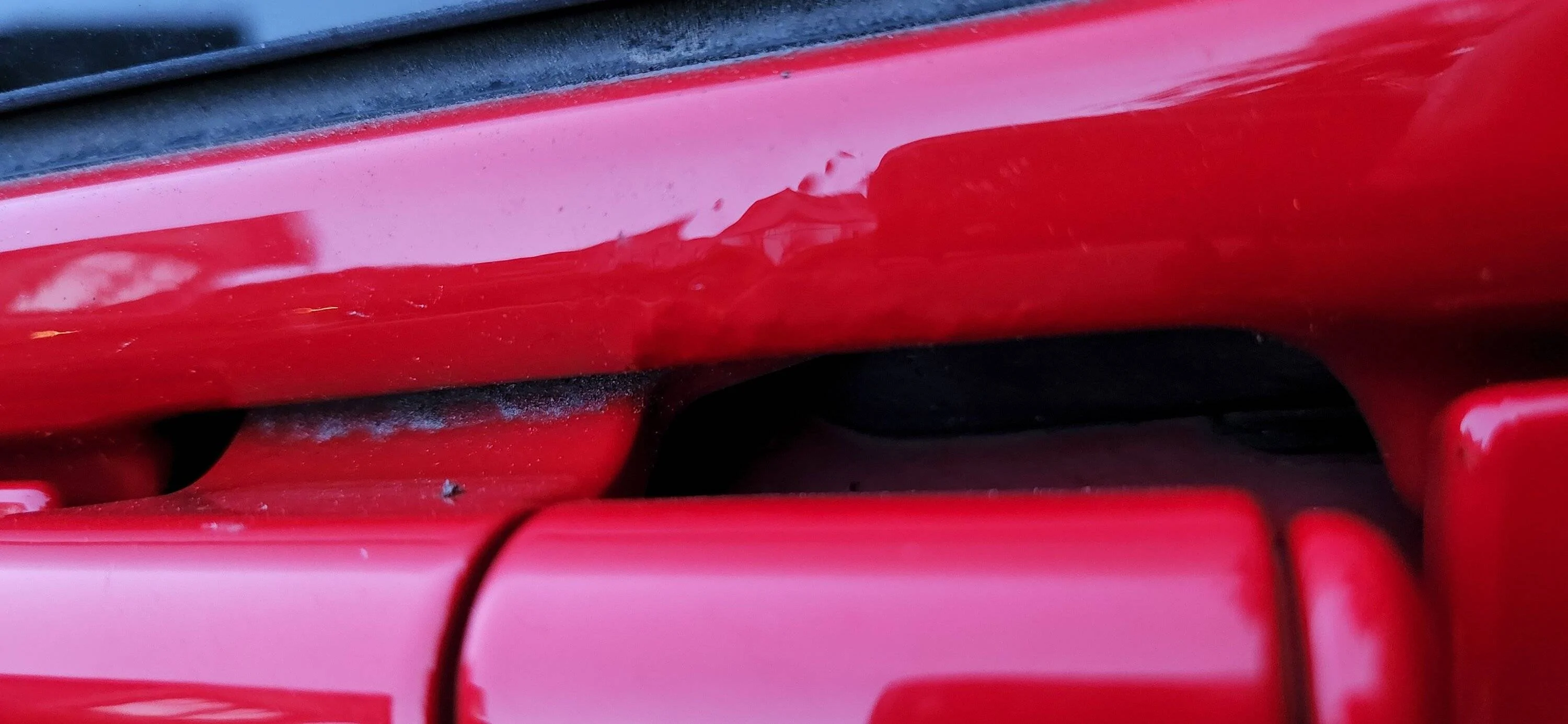

Any negative here is on the company, not us discussing their build issues, but thanks for the thought bro . As I mentioned in earlier posts, simply a gasket will not fix this problem. We have the through bolts which would require a sleeve in order to totally insulate, or perhaps a PE type of material molded with the sleeves all in one piece.There is no saying the gasket on the door hinge is nothing more than a stop gap to slow the issue to push it past warranty period. Also, as I stated prior, there is no gasket on the hood hinges.
