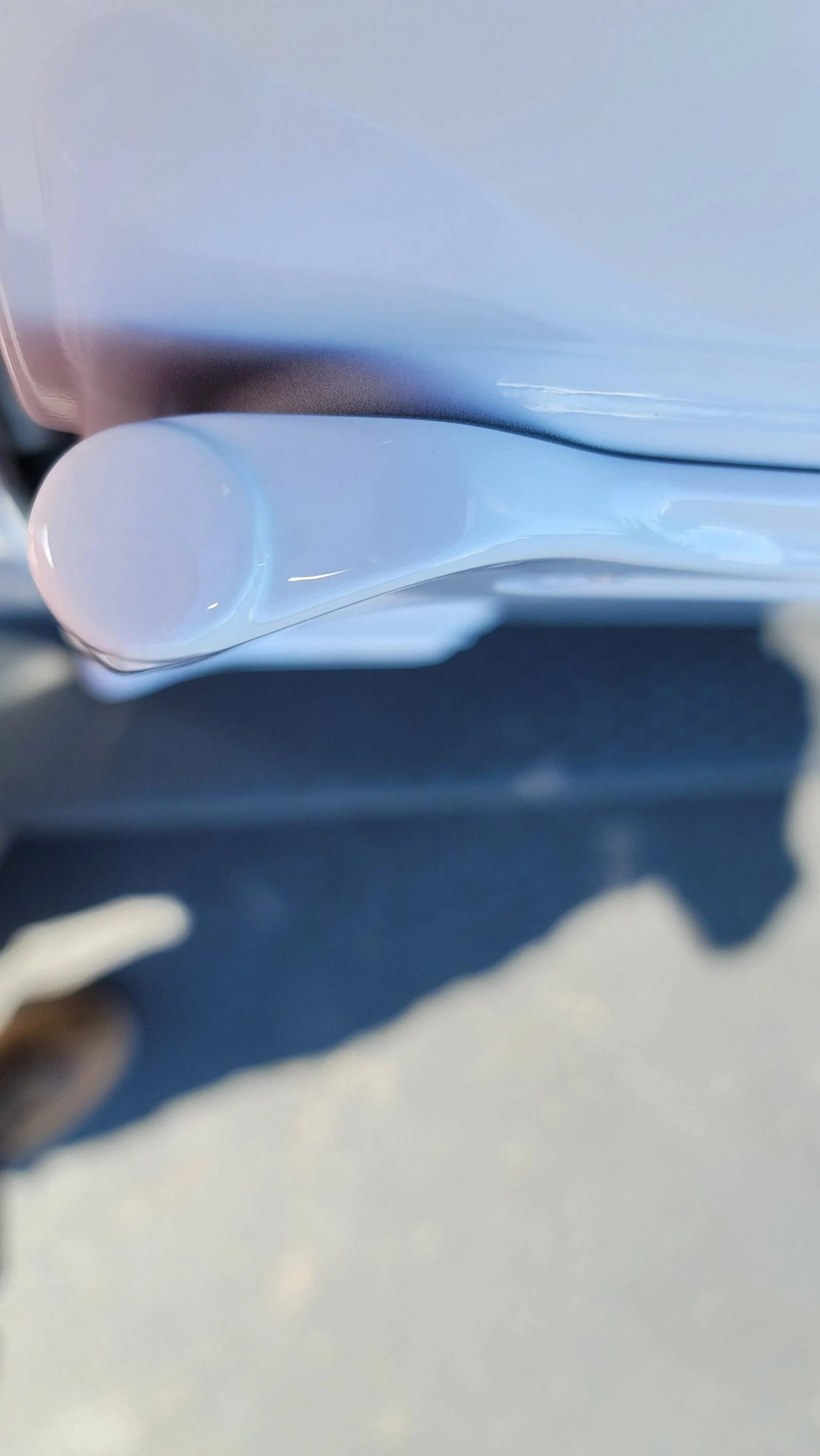

I happened to stop at a dealer today whom had several Wranglers on the lot. The hinges are not backed by a gasket, as near as I could tell. Here is a picture of a white Gladiator hinge. Visually, I could look behind the hinge a bit and saw nothing but bar metal, no gasket. The camera did not capture that well.
I can tell you is mine is. 22 JL Rubicon.

I hope you are correct, I really don't want this issue again.
There is no saying the gasket on the door hinge is nothing more than a stop gap to slow the issue to push it past warranty period. Also, as I stated prior, there is no gasket on the hood hinges.
Not trying to come off negative, just honest.
