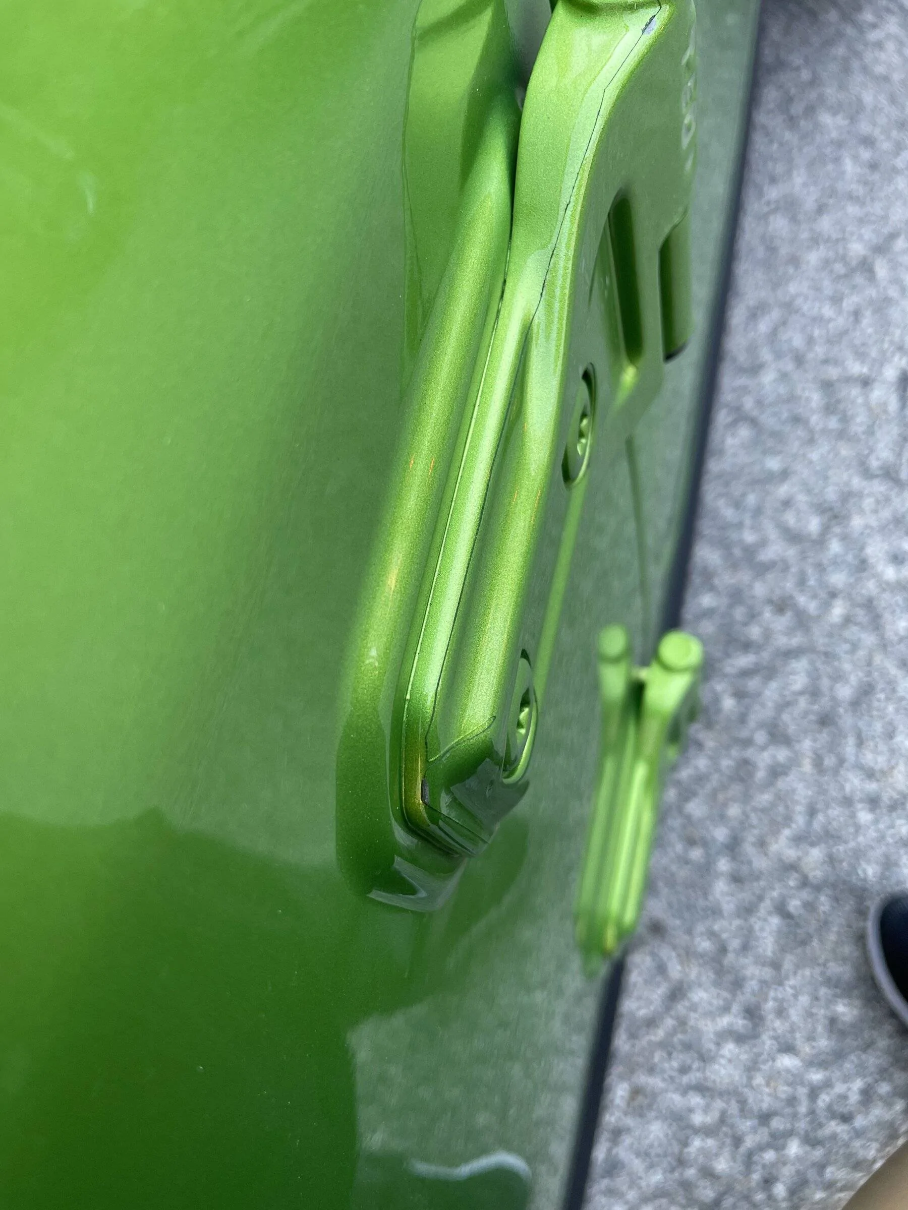

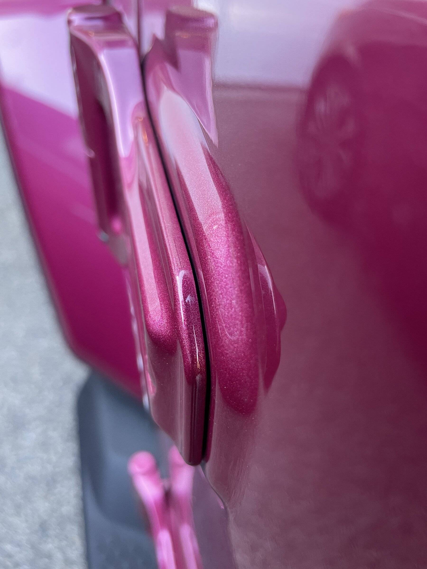

I have a 2018 that has bubbling around the hinges, bottom of the doors, and bottom of the hood. Here are pictures of my hinges and my wife’s 2021. In my opinion her doors have some sort of pad/ gasket between the hinge and door. It looks like they were installed,
And then the door was painted. You can kind of see where the paint stops on her doors. On mine you can kind of see the paint mostly fills the smaller gap between the door and edge of the hinge.

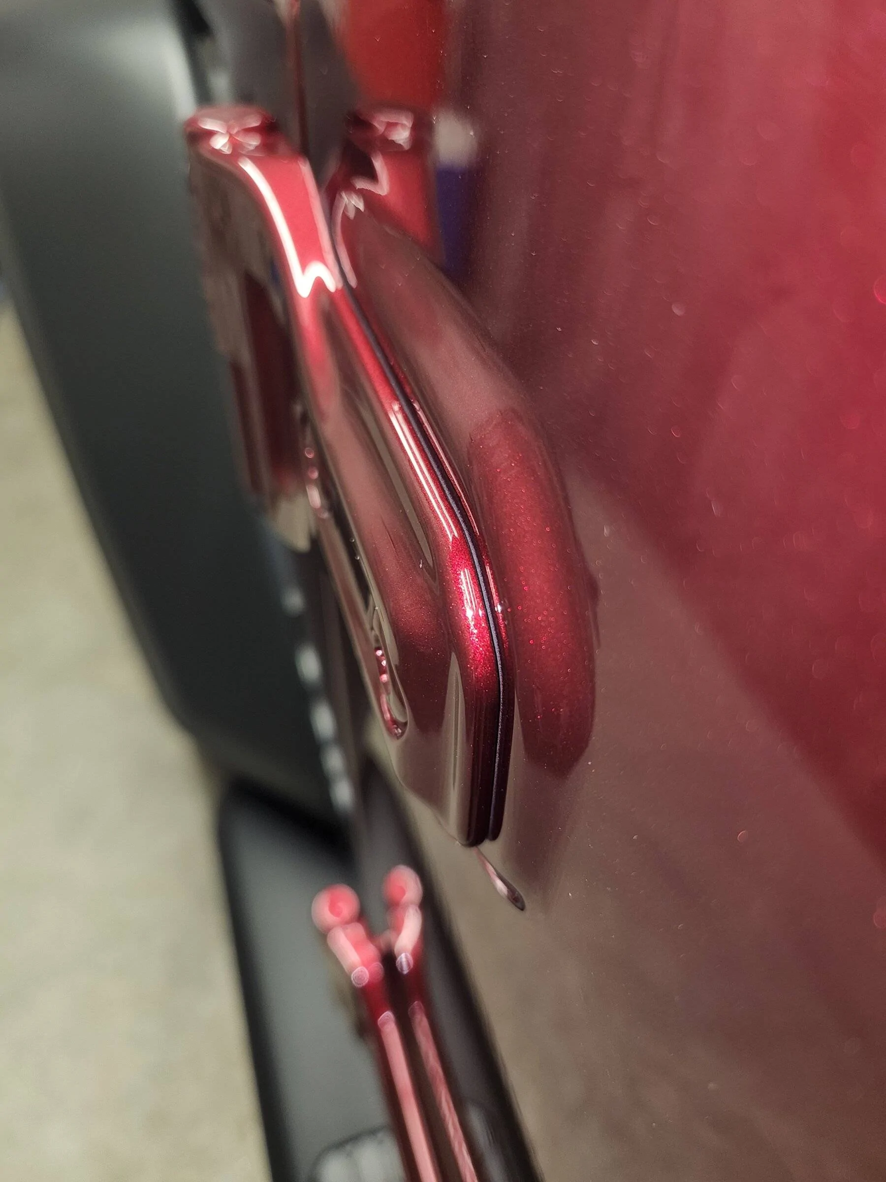

Don't know why I never considered the possibility that the gaskets were added post paint. I looked at my hinges a few times and couldn't see a gasket because the Snazz is so dark in my garage. But using flash when taking a pic certainly shows that there does indeed appear to be a gasket in there. Only time will tell what kind of difference it will make.
Apr 28, 2022
New Orleans
2019 Wrangler JL Sport S
Jeep Wrangler JL Bubbles in Paint at Door Hinges 20220501_210942
I looked at a couple of 2022 White JLs on dealer's lot. It looks like yours does. Looks like there is something in there between the hinge and the door. I asked the parts manager for a part#, if it is a gasket, he said it does not show one. Round and round we go.

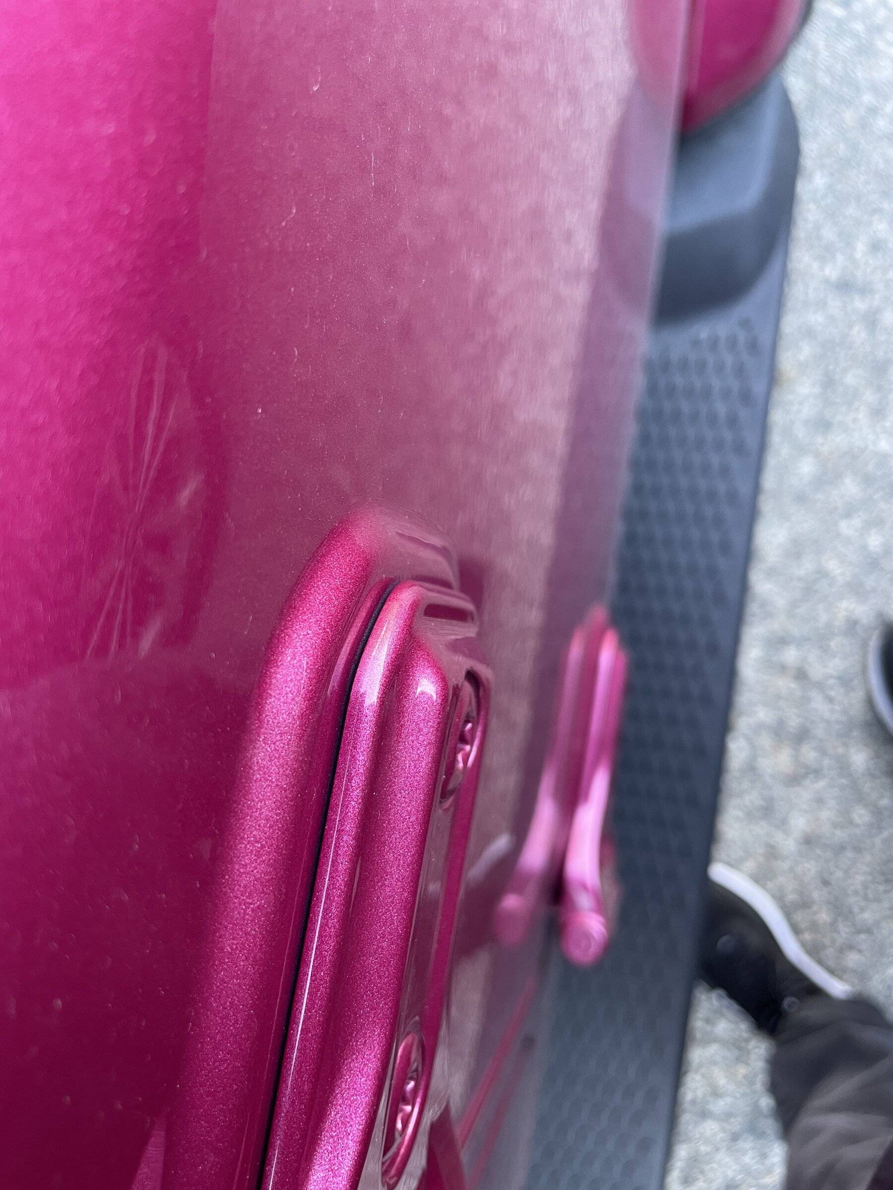

I too have the gasket.
