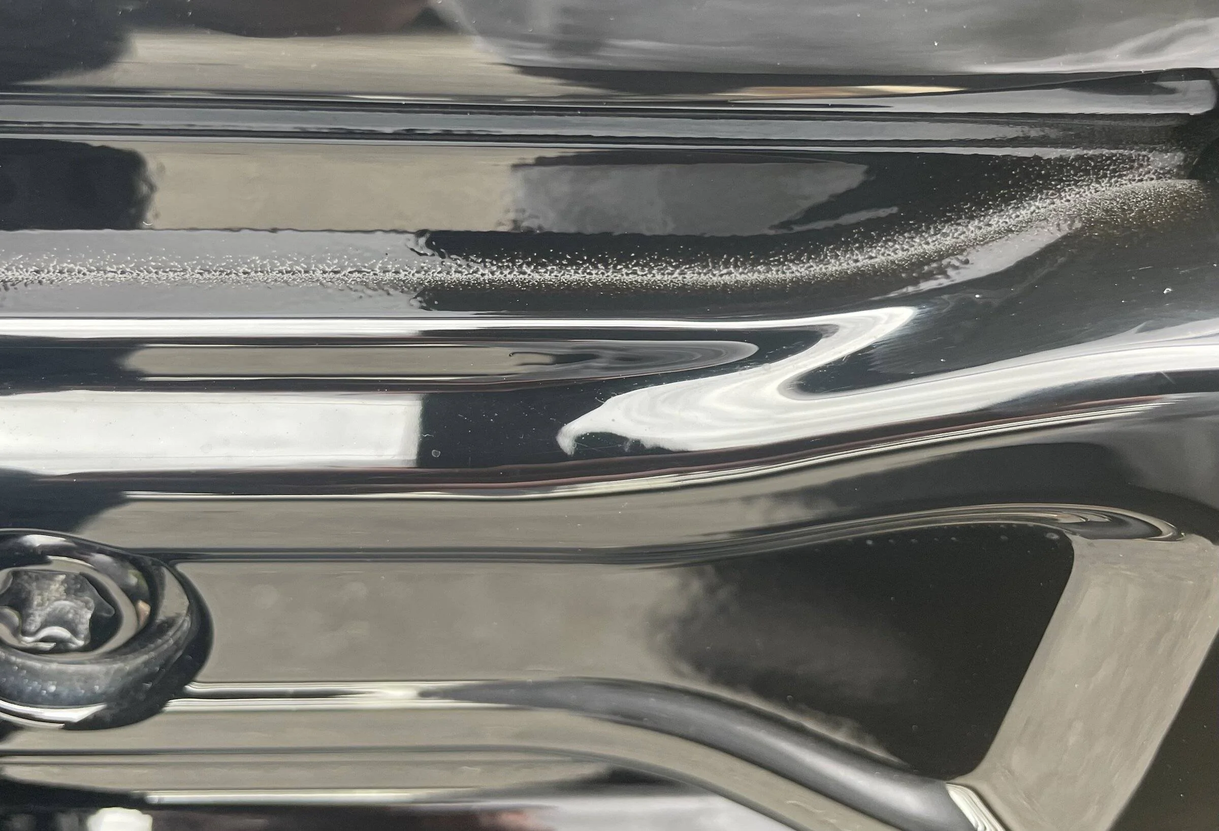

Just cleaned my Jeep and I can’t believe I never noticed this, but there is under spray on the top seams of rear tailgate hinges. Not sure I want to take it in for this. Probably just touch it up myself or let it go. More upset at myself for not noticing this at delivery. Just wondering if this is common?
Mine has the same issue on the rear tailgate hinges. the paint on these vehicles is absolute crap

Line-X won't stop the corrosion. You have to separate the two dissimilar metals, by putting a barrier between them. That is, after you sand out the corroded areas. Then, you can safely Line-X.

And you would have to isolate the hinges from the body to avoid corrosion as mentioned by DaltonGang

My Hydro, built Feb 15th, 2022 sure looks like there might be a thin "gasket" between the hinge and the door.
Anyone know if Jeep made a recent design change?
I have heard about that too from others.

Just checked out my 2021 I received mid-October ...if I remember correctly. There doesn't appear to be any gasket between the hinge and door.In fact, I'm not sure that there is any paint either. It may have primer or some sort of coating, but it's not the finish coat. It looks like they spray the finish coat over the assembled units with nothing but some sort of corrosion coating between the two different metals. I think the aftermarket will come to the rescue with some clever designed cover...to hide it.

Has anyone seen or posted pictures of the new change for the doors?
I still can't say for sure, but really looks like a black "gasket" in there.
On a related note, Hydro is such a beautiful color. There's a ton of metal flake there. ?
Maybe someone with a new White one can get a better pic with more contrast.
