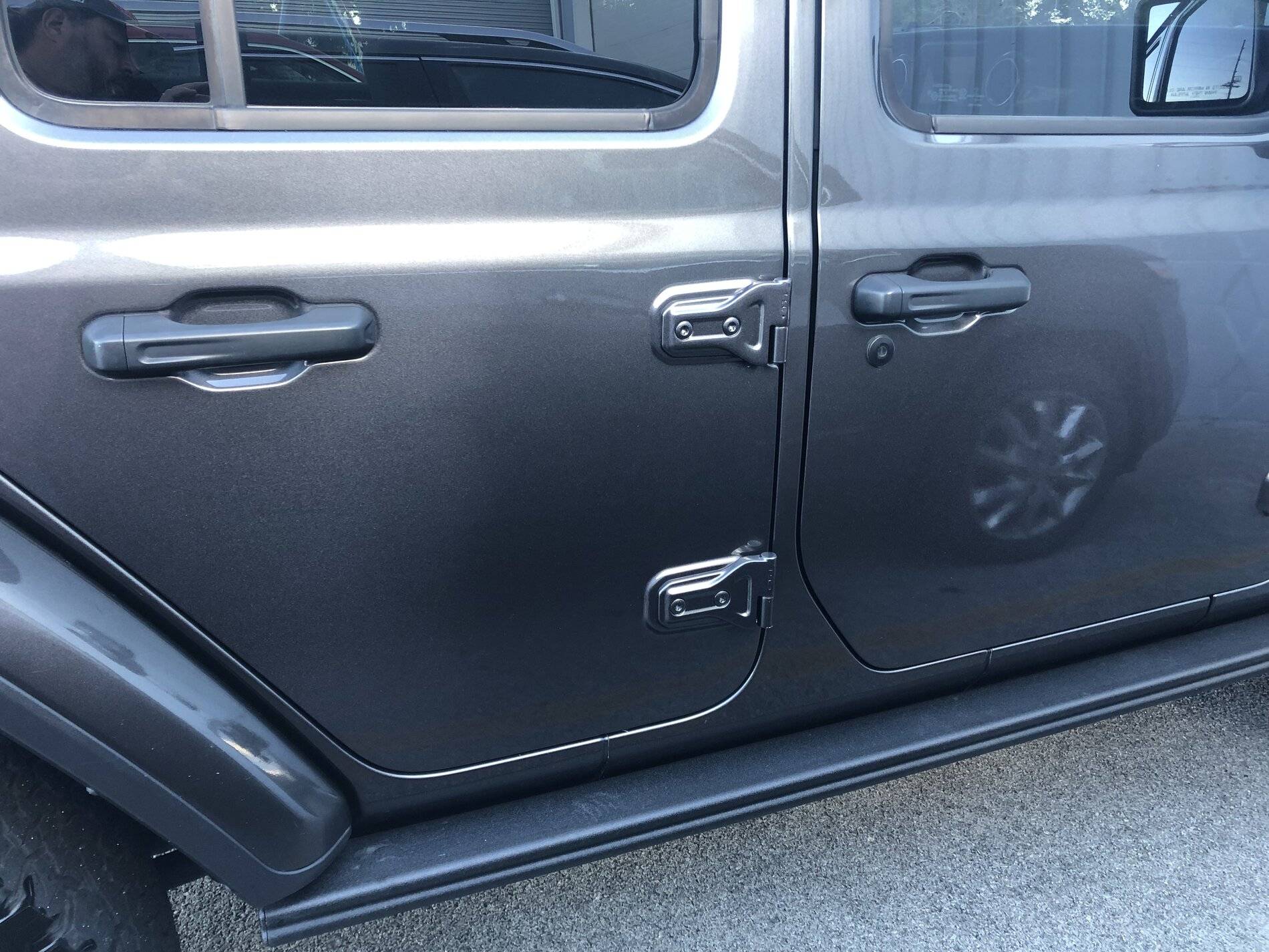

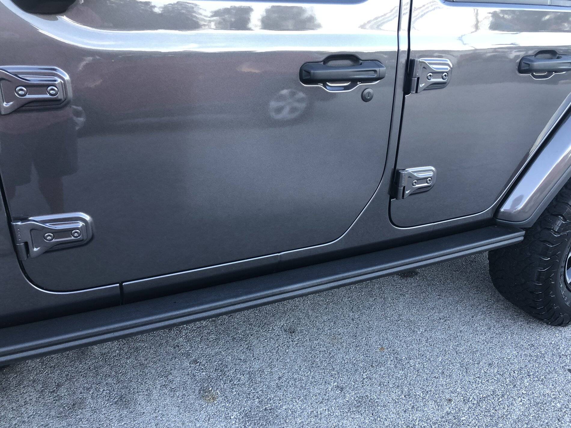

Thoughts on acceptability of this job? I haven’t picked it up yet drove by after dealer was closed and I have their loaner. I am NOT HAPPY! I will be talking to them in morning and @JeepCares case manager.
why would they not just paint entire doors??
Also the makings for the T-50 are not crisp anymore- paint was loaded on and started filling them in.

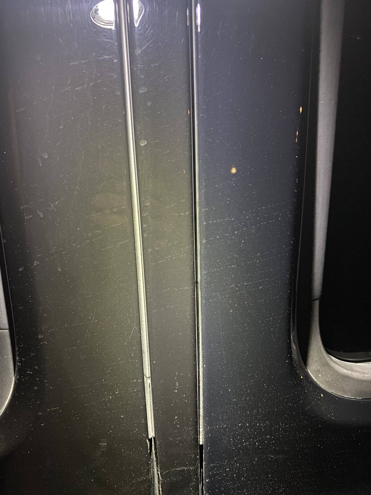

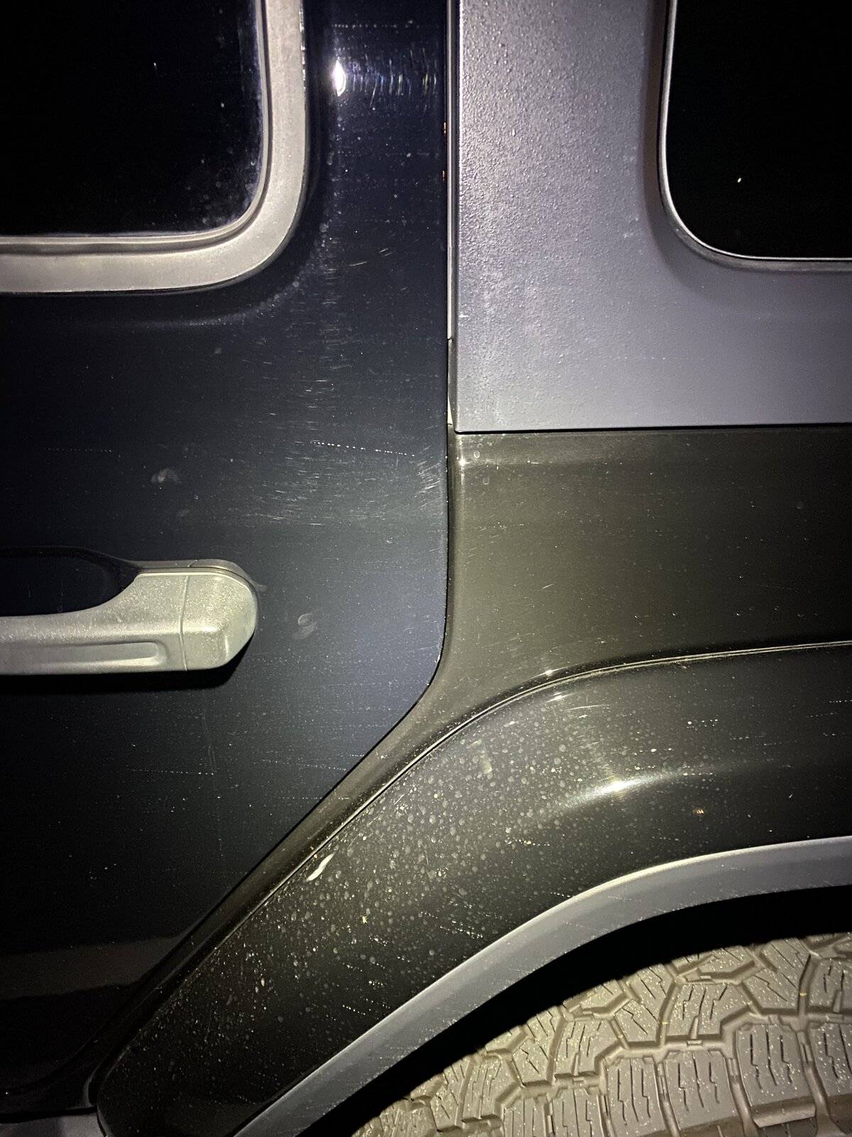

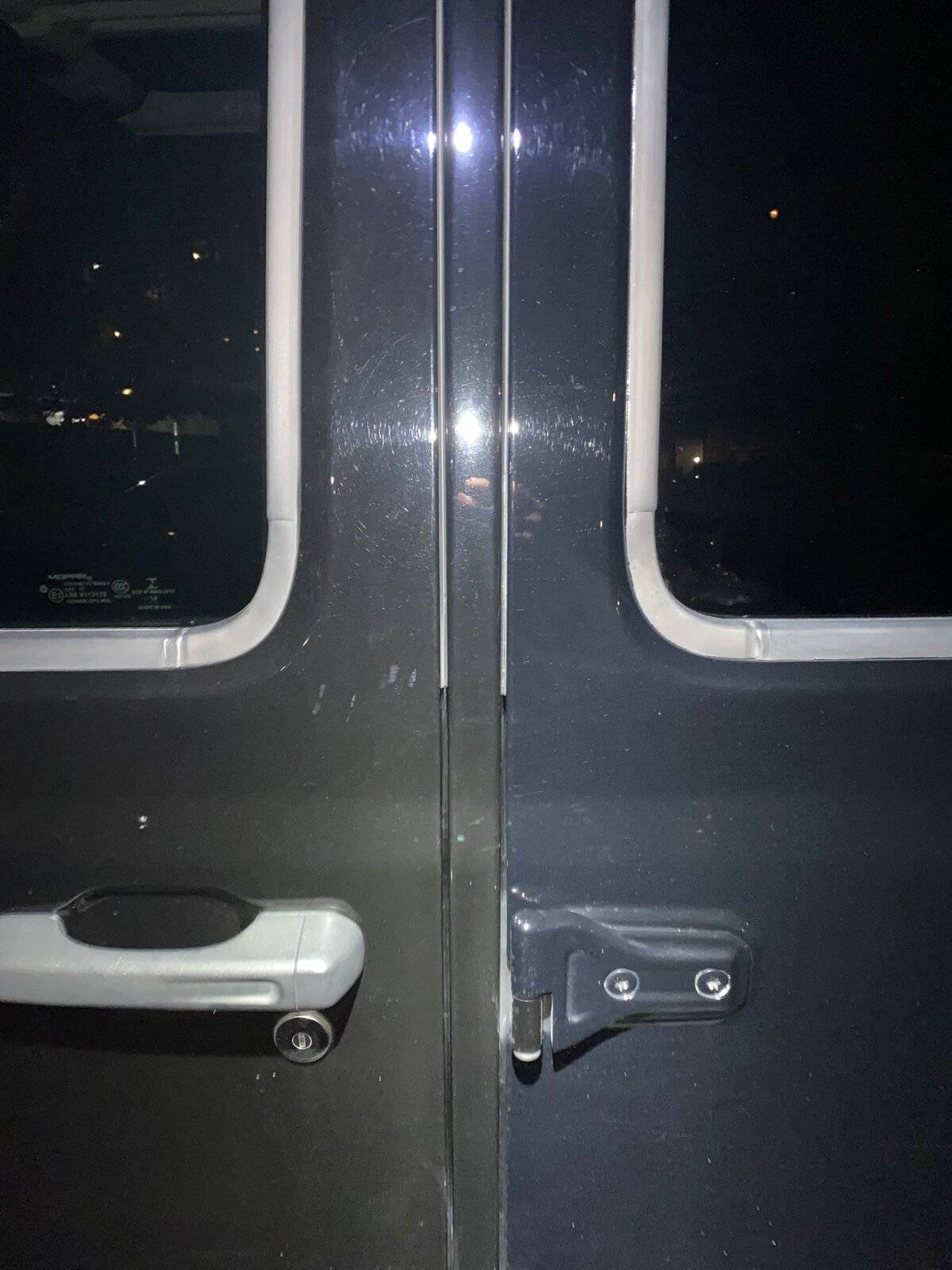

Looking for advise on what to do.
2018 Jeep JL black
Is there anything I can do about the paint difference?????
I had ( and still have) the corrosion on the doors and hinges. I had both rear doors repainted and the color is way off under lighting. The rest of the Jeep looks almost brown and the painted doors look dark purple. I get it’s new paint but I don’t want to get the other doors and hood repainted and the Jeep look patchy on a sunny day. (Don’t mind the dirt it rained and my tires throw up some dirt)
Over all, Is there anything I can do to get Jeep to fix it all? Or am I just stuck with a 40K patchy vehicle?
P.S even the new painted door have corrosion.
(Pictures we’re took at night to showcase the color difference that can be see on a sunny day)
@JeepCares
