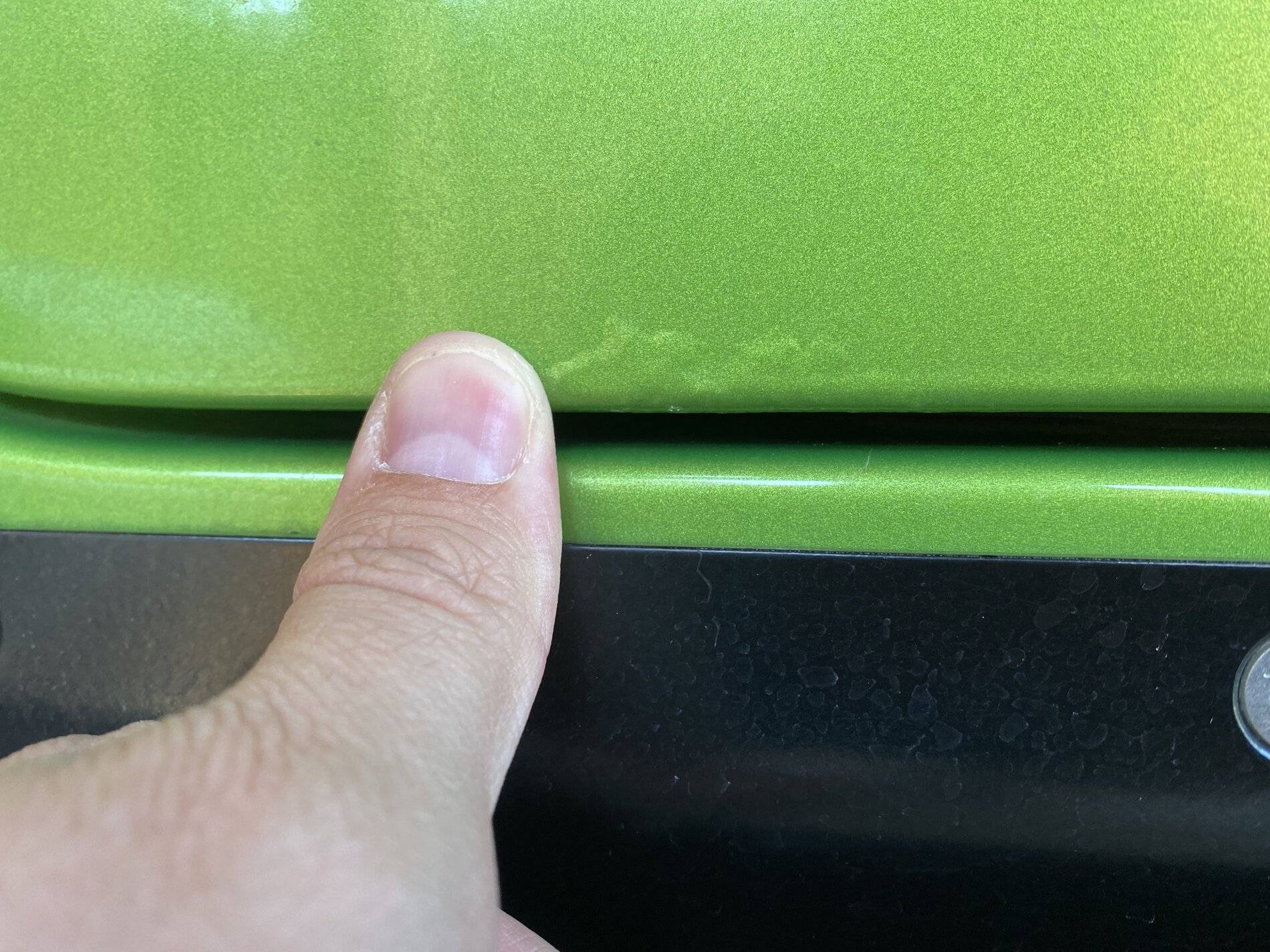

Took a pic to update.
Jeep Wrangler JL Bubbles in Paint at Door Hinges 52FE6F1B-8615-4E09-907C-F400549A669D

My question is, not for you in particular, how does corrosion on the bottom to the door, or hood edge have anything to to with galvanic corrosion?
I’m not a professional at all, but I’ve heard due to the different metal dust and on the other metal that gets painted over causes it over time.
