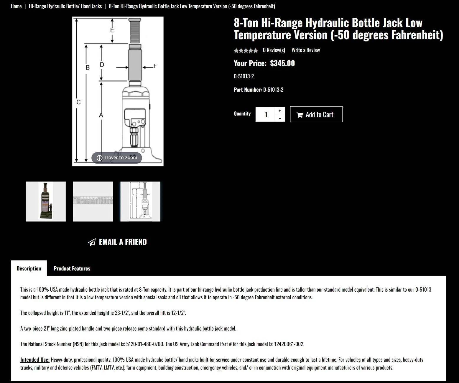

When I looked into getting a bottle jack, I couldn't make the math work.
I'm on 37s with a 17" wheel. That leaves 20" for sidewalls total, or half that at 10". The axle tube is 2.75" diameter or 1 3/8" radius. When my tire is flat, the axle tube could be as low as about 9" to the ground. So, the jack needs to go as low as 9" ish then raise at least 10 or 10 1/2" or 19 1/2 - 20". Find me a bottle jack that does that.
Here ya go....
https://www.jlwranglerforums.com/forum/threads/best-trail-bottle-jack-rubicon-jl.47578/post-2338793

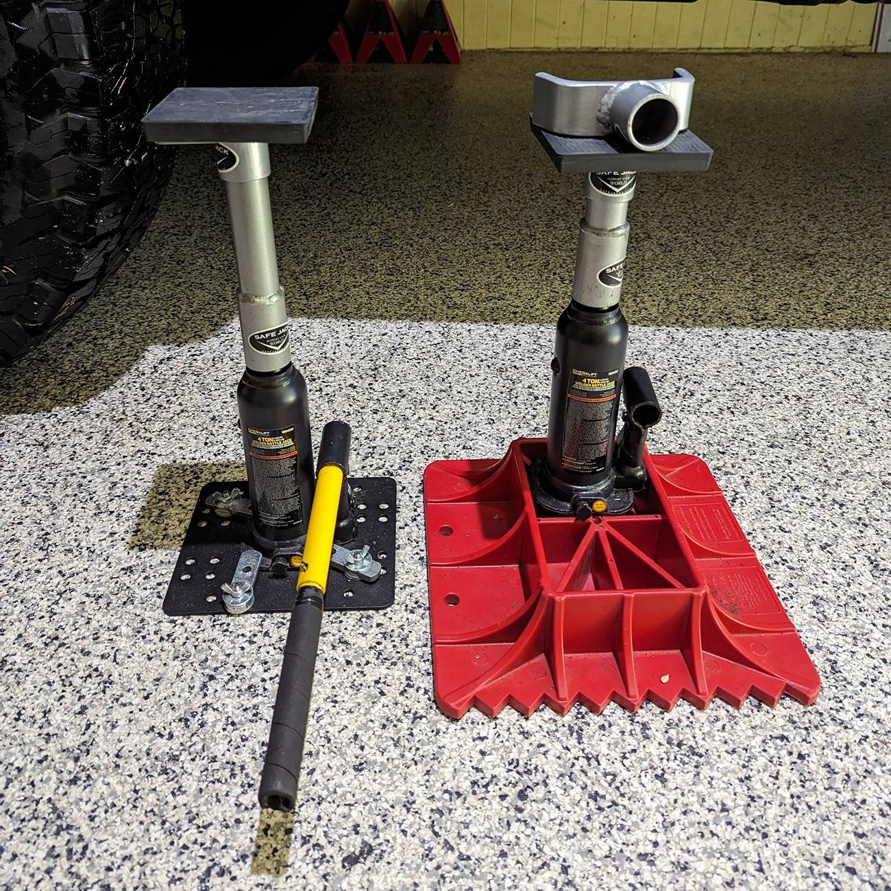

I carry two 4 ton bottle jacks; both fit in the jack compartment (at the same time). I have a bunch of Safe Jack attachments for versatility and frame leveling at camp.
