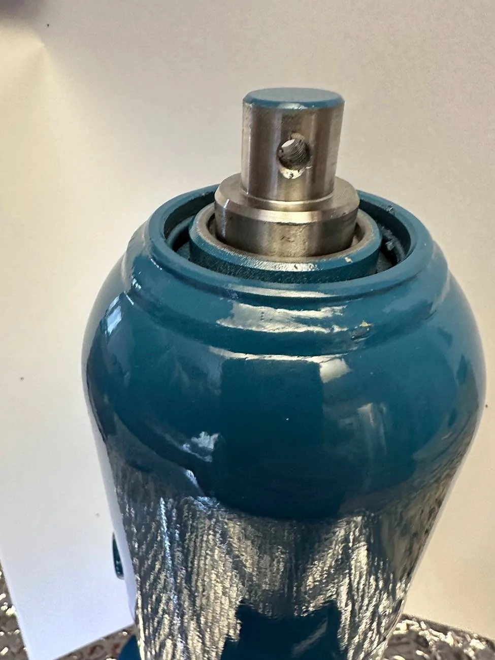

Will do. I’m thinking it may need a leaf spring perch and a bigger footprint for anything even mildly off-road
The closeup of the jack saddle shows a set screw. If that saddle comes off you could either grind it flat and weld a spring perch on it or make up another piece to adapt the perch to the jack. I'm a little skeptical about a set screw for doing off road work. I'd be tempted to look at welding the perch and jack together.

Yes I’m thinking welding…we will see what it actually looks like when it gets here

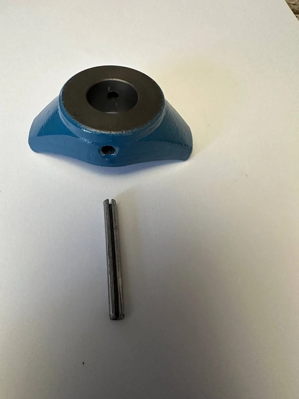

@roaniecowpony this just arrived. It is unused in original packaging. There is a roll pin holding the small cradle to the ram. The base is approximately 4-1/4 inch square.
