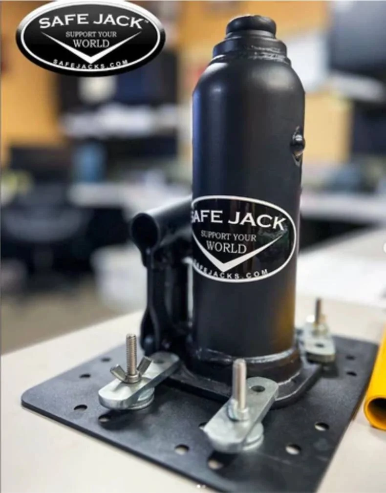

I agree stability is critically important for safety. But, there's no practical stability difference between the center of the axle tube (at ~3/4 total axle length) and it's end next to the hub; the same caution is required at either position.
Personally, I use the Safe Jack clamp-on base plate, which makes my setup much more stable than the small base of most jacks (of any type).
Jeep Wrangler JL Bottle Jack Cradle? 1000004344
I also carry 2 bottle jacks for versatility and enhanced safety.
