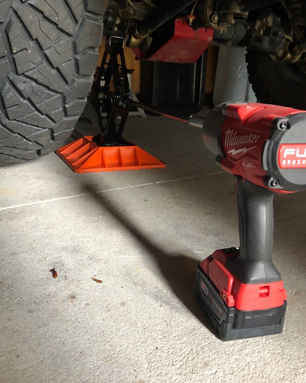

I’m on 37s and I use the oem scissor jack..I use a hi lift jack base with it…set under the axle it will lift the wheel a few inches off the ground…I tried various different jacks and found this to be the simplest way for me….It’s already there, not taking up any space and the base will fit about anywhere…..
And since I always pack my heavy duty impact, I use it with a 13 mm deep socket to spin the crank… the older I get the more short cuts I look for…..😅
