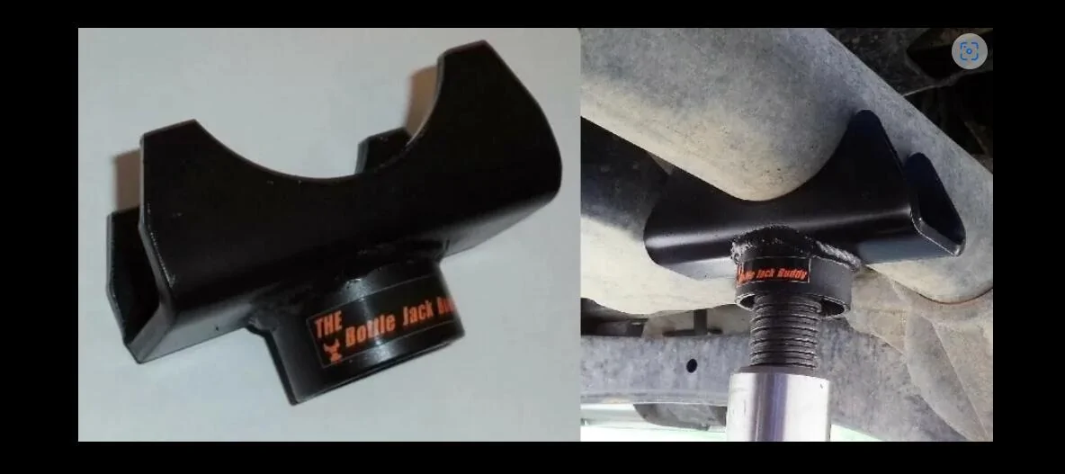

I got a simple bottle jack, and it didn't come with a cradle/saddle. Which size should I get to use with the JL? I suppose I could measure, but my Jeep is outside, and it's cold outside; and the internet is all warm, but my searches are coming up empty.

Nah, it’s more fun to roll the dice using the little nub on the jack and hoping the axle doesn’t slip off. Keeps the chest hairy.
Actually that’s a great little invention. Have not seen one of those before.

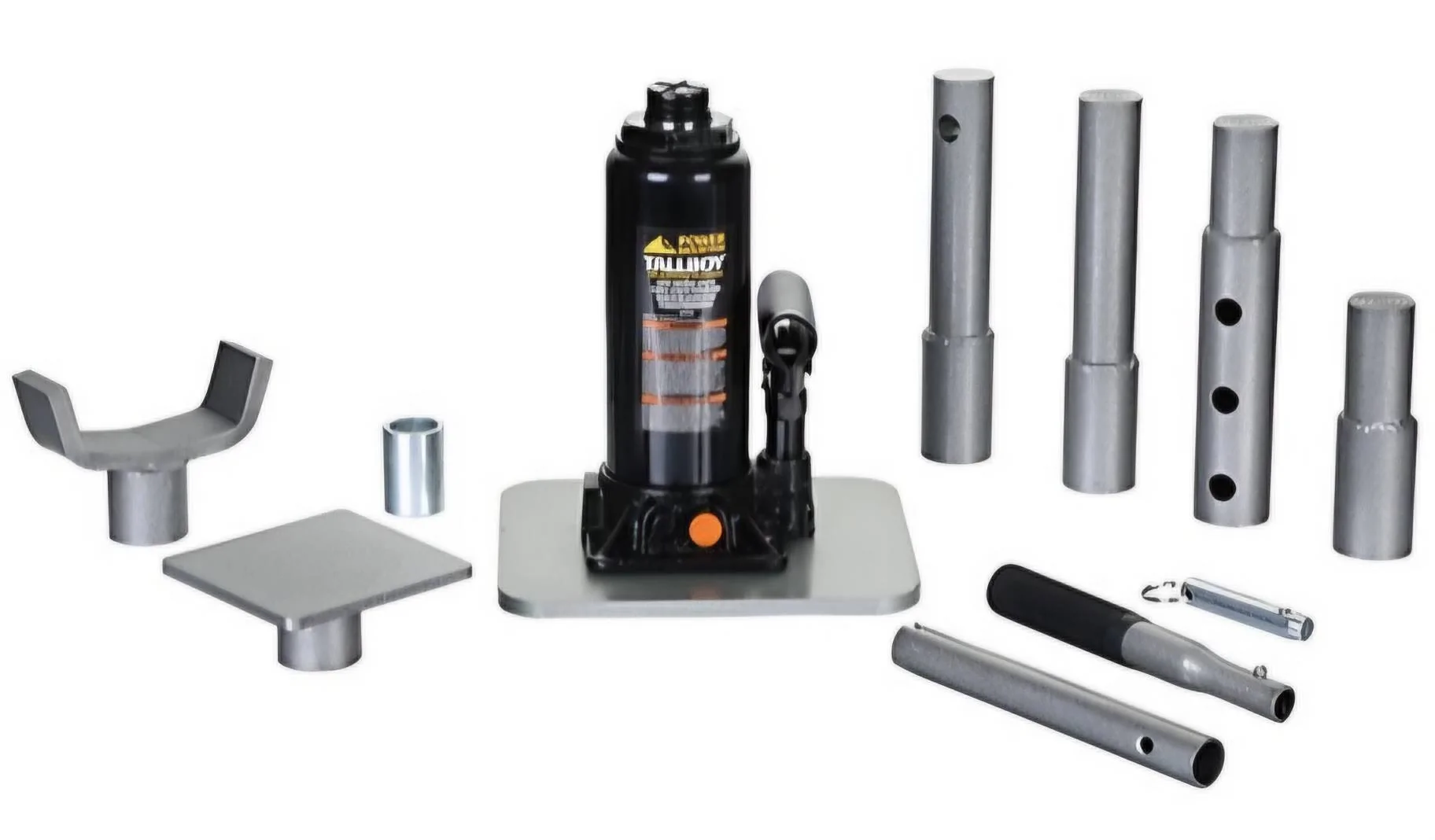

Power Mountain Tallboy Off-Road Jack
Tractor Supply for $107.99
It comes with a carry bag. It is very similar to the Safe Jack for less than 1/2 the price.

That's a nice set. Unfortunately I already bought the safe jack version a couple of years ago. The problem I had with it is the "lift height" of a normal bottle jack isn't long enough to change a flat tire. I was on 37" tires when I had a blow out on the transatlantic railroad road. I could get the flat tire off but not the new tire on. I used the stock jack as a "jack stand" so I could reset the bottle jack and make it work.
I have since bought a double ram bottle jack. I bought this one: Link
I haven't had an opportunity to use it yet and need to test it to make sure it works. I would let all the air out of a tire and test your setup before you need it.
edit: The safe jack accessories work on it but aren't as tight as the original bottle jack that came with it. You have to use the little black thing that comes with it to put around the jack ram.
