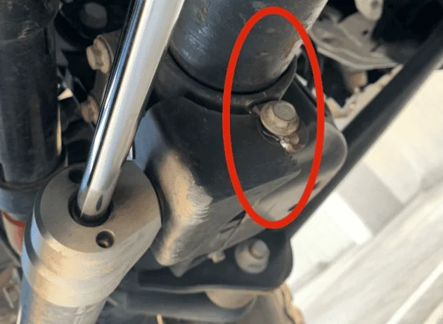

Recent example: No changes made for thousands of miles and drove with zero issues. One morning I had death wobble with every manhole cover I drove over. Went home, looked under the Jeep and noticed a break in my stabilizer bracket. Replaced the bracket, death wobble gone, and thousands of miles and no return.
If you have death wobble I agree that a person shouldn't think that a better stabilizer will fix it; however, I am convinced that a malfunctioning stabilizer can indeed cause it.
