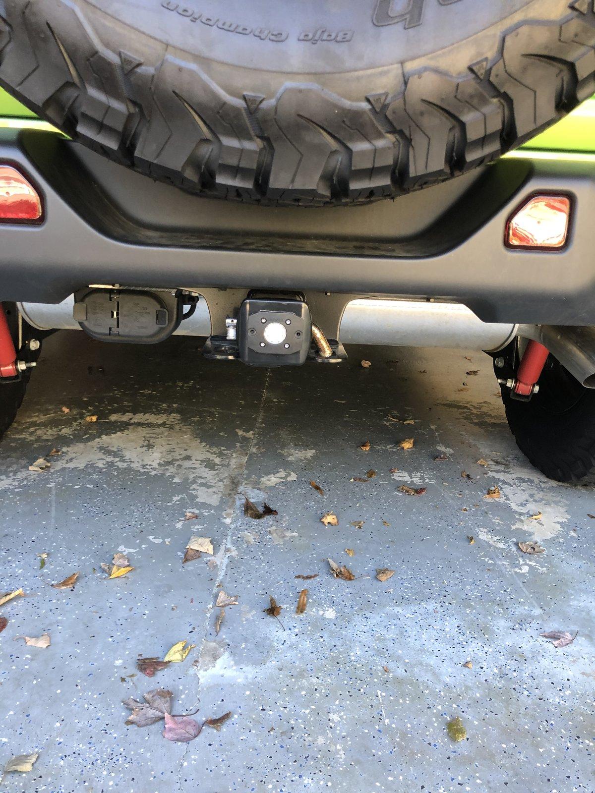

So I'm planning on adding the Ignite lights for reverse. My plan is to tap into the White with orange stripe wire out of the trailer wiring for power to both lights (with a diode after the tap). I also plan to run a wire from the Aux switch into the power of the lights (with diode). Does anyone see any issue with this? Has anyone tried this setup before?
I am going to power the F111 fuse with the AUX 3 switch. Maybe a diode there to be on the safe side.
As long as you use 2 diodes in that mix like you say, all will lets say play together without problem. Suggest you read this thread from page one until this last page. Yes, myself and other's have done this install. For the record, I have had no Can Bus issues, probably because of using two diodes in the mix.
What are you plans for grounding those Ignite's? You can pick up (tap) a ground wire in the same bundle as the white wire with orange trace. I did not want to compromise a second wire in the bundle so used a self tapping screw in the rear tow cross member and used that for a ground versus tapping into the ground on the bundle.
Let us know when all is done....

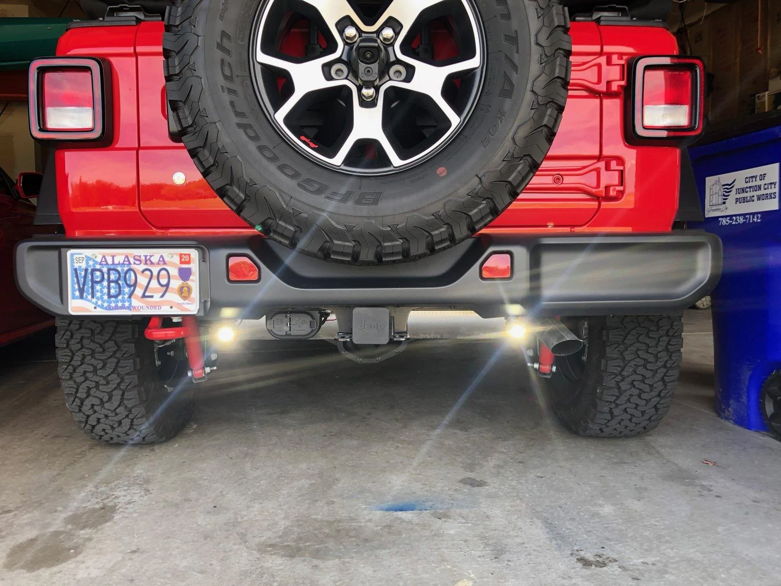

Thanks for the tips. I've read the thread a few times I just wasn't quite sure as I'm not an electrical person I prefer to research allot and double check everything, hence the specific post. My brain doesn't always seem to work as everyone else's so I'm a bit cautious with a vehicle we plan to keep for retirement. As far as grounds I plan to use self tapping screws into the tow cross member as suggested (I'll solder/crimp the ground wires together and then solder/crimp a ring onto the ground wires that I'll attach to the screw).
They work with the Aux switch, but I'll have to wait until the wife is home to test the reverse, but overall I think it's good. Here's how the finished product looks:

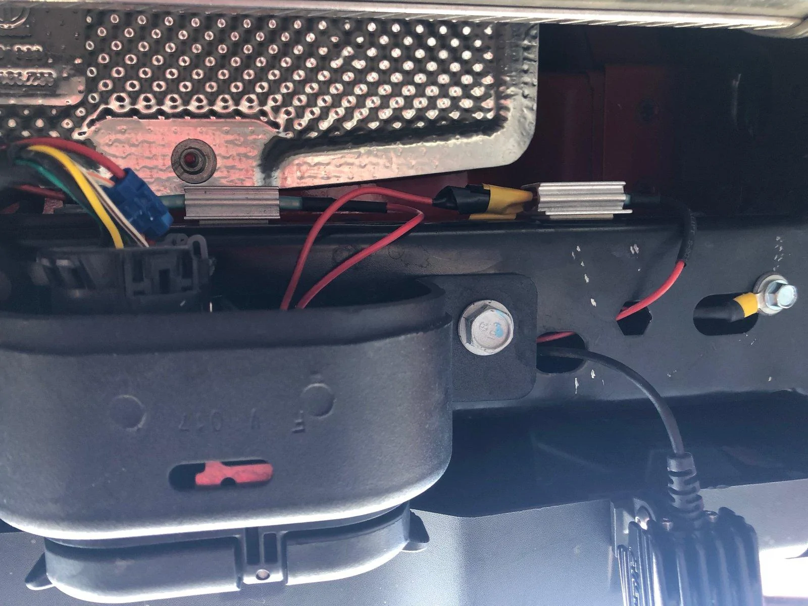

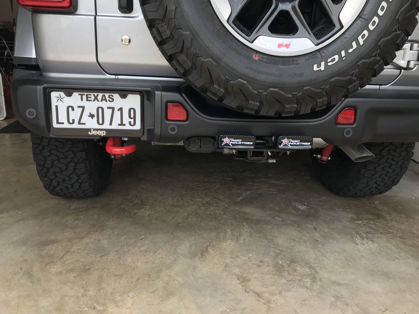

Thanks go out to @mdallas for posting his set up. I duplicated it and what an improvement the @BajaDesigns S2 Sport makes back there. I ended up running power all the way up to the under hood Aux switch connections for Aux3 after deciding to go without the reverse actuation for now. Snaking the power through the frame rail was pretty easy with a wire coat hanger, and then added a bit of wire loom to protect where the wire comes out of the rail up to the engine bay. And yes, the Jeep could use a bath.

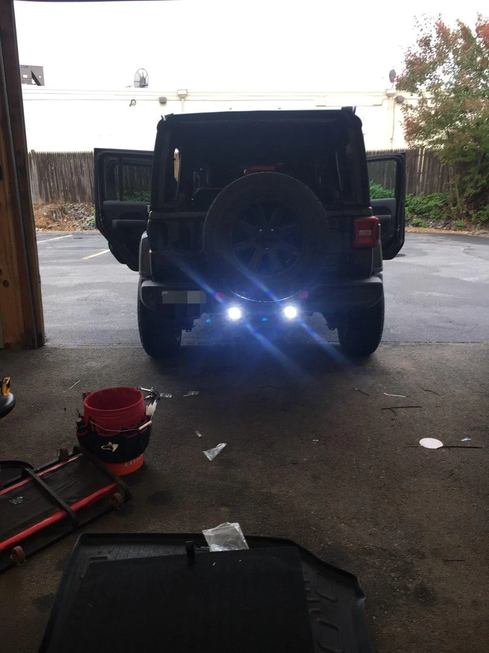

My take on the rigid ignite light. Only wanted it for backup so just grafted the flush mount into a receiver cover and tied the wires into the trailer light plug with a weatherpak connector. When it gets dark we’ll see how much difference it makes.
