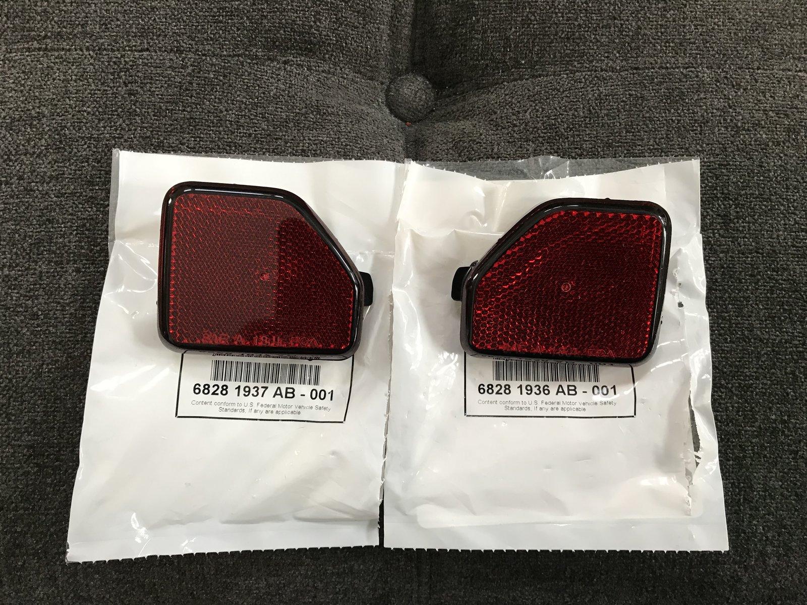

Well i finally got around to starting this project. Removed the reflectors and had to do a little hacking but everything fits nicely.
Anyone have the part numbers for the rear bumper reflectors for a regular JLR?

@viper88
Geez, you got your answer in less then 2 mins. :giggle:
No, no back side pic...
Actually you got me the part numbers in less then 30 seconds. lol. I will order a set this morning. I am assuming the flush mount Rigid back up lights are going to be easier to install since all that needs to be removed will the mounting cover.
