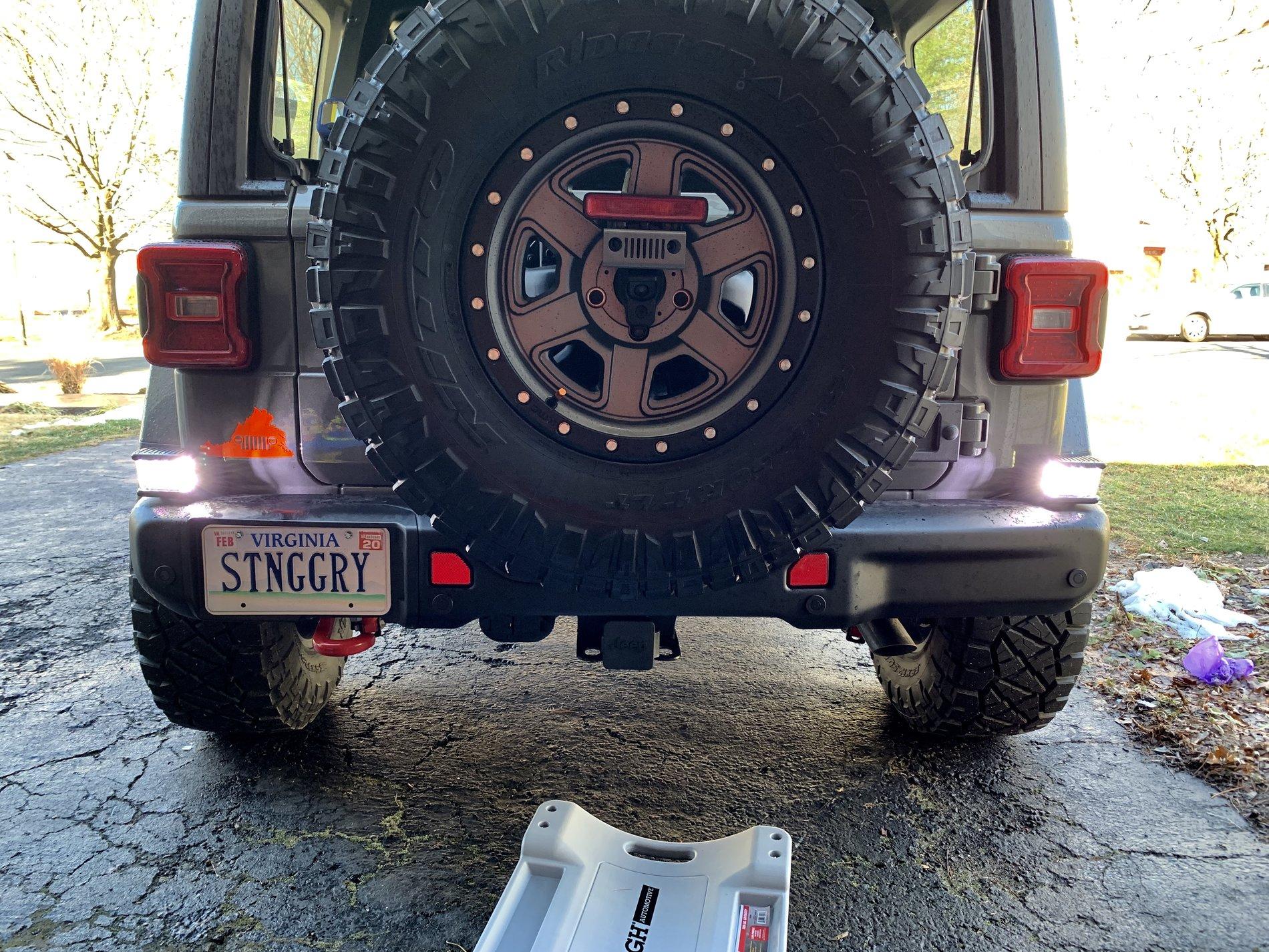

I opted to go with 4500lm (ea) side-shooters mounted in place of the carriage bolts on the rear bumper. I was concerned that the passenger side one would interfere with the tailgate but they never come close to one another. Ran the positive through the frame rail, out past the rear bump-stop and up over the muffler heat shield. The grounds are run separately to screws under the bumper on either side of the hitch. As I was thinking through the wiring I decided not to wire them in to the back-up lights. I don't need them coming on every time I'm in reverse, just certain situations so I opted to just go with Aux 4.
For those of you JUST going to an Aux, you do not need a diode. If you feel safer running one, go for it, but it isn't necessary. If you do go with one, I would recommend not using those huge $25 ones. A 15 amp diode costs about $1. I can show anyone how to solder it in if anyone needs help. It couldn't be easier. I also have a bag of them and would be happy to mail one out in an envelope if someone needed one.

It wasn't hard to do BUT I had to come out right by the rear bump-stop. I couldn't see a good way to get down the hump in the frame-rail. It is a wicked bend and you've got the tire, shock, bumpstop, muffler and all that in the same area. I just came out by the bumpstop and ran the wire up over everything and zip tied away.
If I had to do it again though, I'd probably just wrap the wire in weather proofing and run it on top of the frame-rail with the rest of the wires up there.

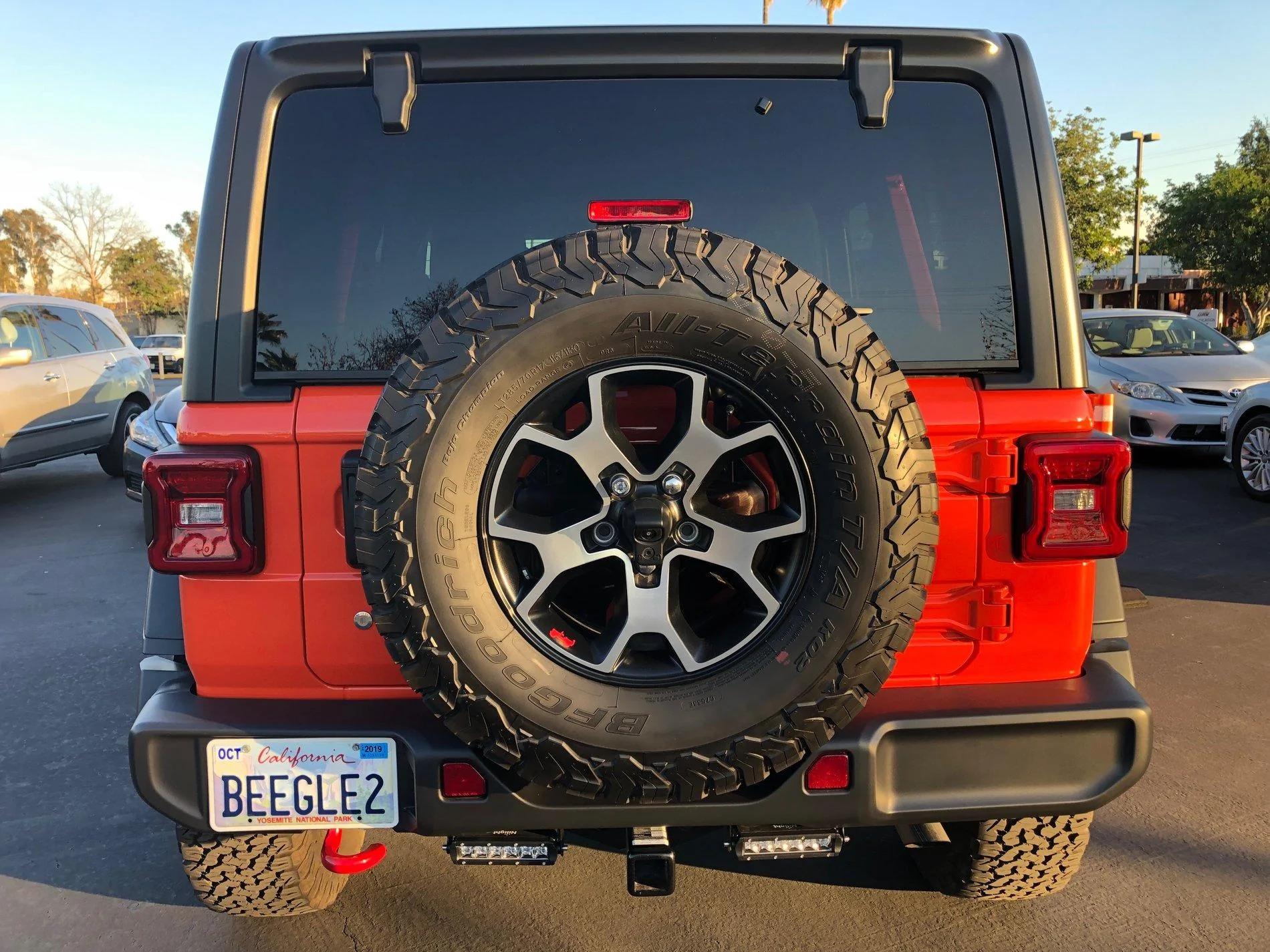

I'm confused about the diode requirement. I understand that it's like an electrical check valve to keep energy flowing one direction only, but are they only required if you want to control the aux backup lights separate from the reverse lights? I just connected a lighting relay with the trigger off the backup light circuit and main power to the lights through the relay. I only use them when in reverse so I have not wired up to an aux switch. In this case I'm presuming no diodes would be necessary.
My favorite install so far is the one by @Colorado Rubicon surface mount. My solution was much less elegant. If these get damaged or broken off I'll likely go with the surface mount floods. But until then these work just fine.
Agreed that @Colorado Rubicon's install is probably the cleanest out there thus far, but it's a no-go for folks like me with the steal bumper and proximity sensors. My search continues...
If you're going to tie something in to an existing circuit (like the back-up wiring) you need to use a rectifying (rectifier) diode. Due to the sensitivity of the computer system, if it reads an abnormality (unexpected condition) when sensing the connections, it might throw a code/not work as expected. The rectifier diode means that the power flows to your add-on but that no chatter/feedback comes back into the line which has the potential to mess with the expected conditions the computer is looking for.
If you are just running to an Aux, you don't need a diode. That circuit is expected to have a draw on it and is more 'flexible' than if you're tying in to an existing component. Lets say I'm running rock lights and I want them to come on with the dome light AND run them to an aux. In that case, I'm going to use a diode on the circuit at both the tie-in and the aux switch to avoid the possibility of any weird chatter/feedback that might confuse the computer.
Personally, I don't see a need for an additional relay unless the power is coming straight from the battery to the add-on
