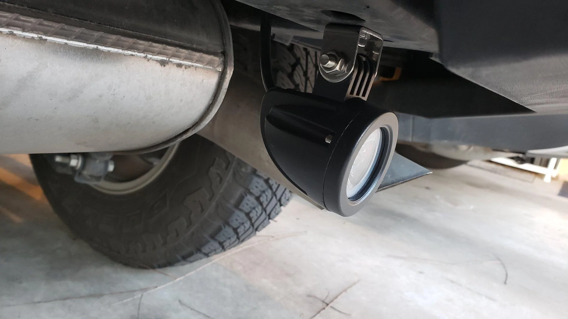

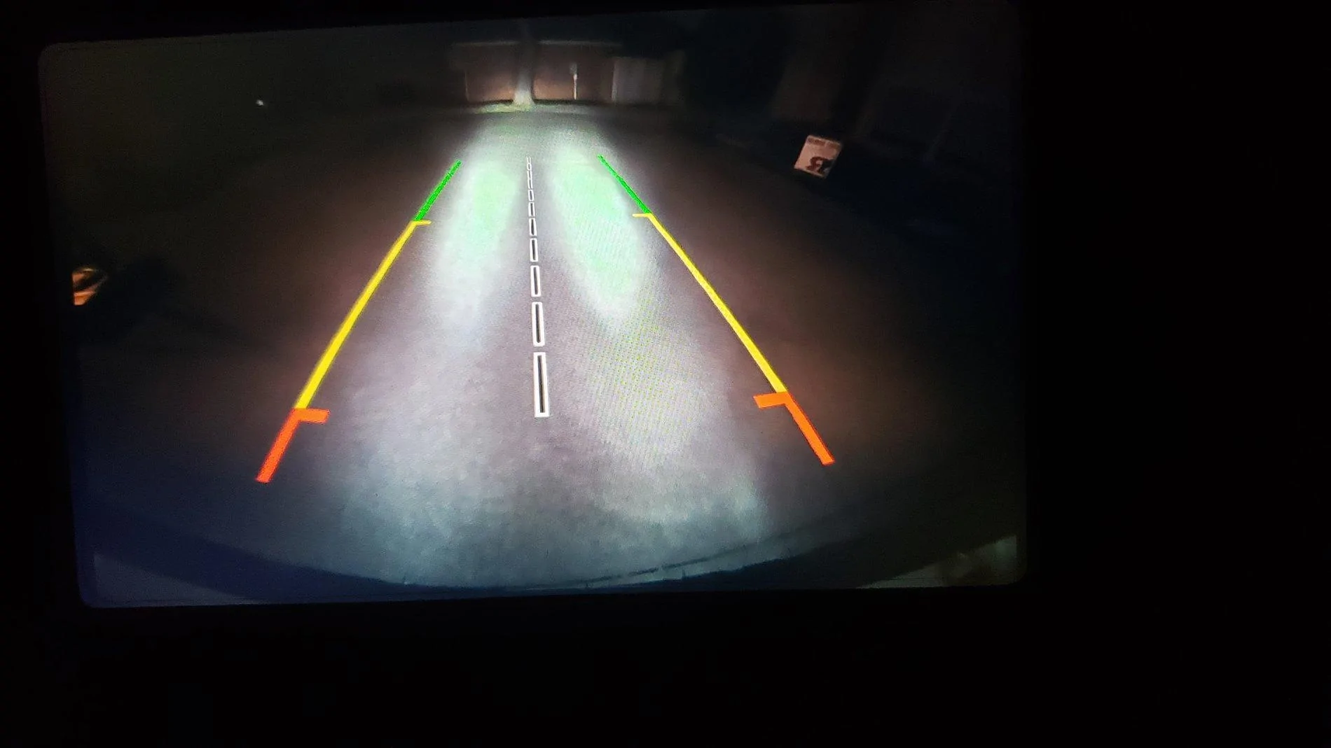

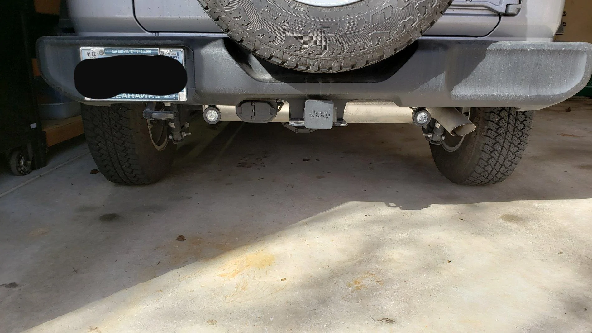

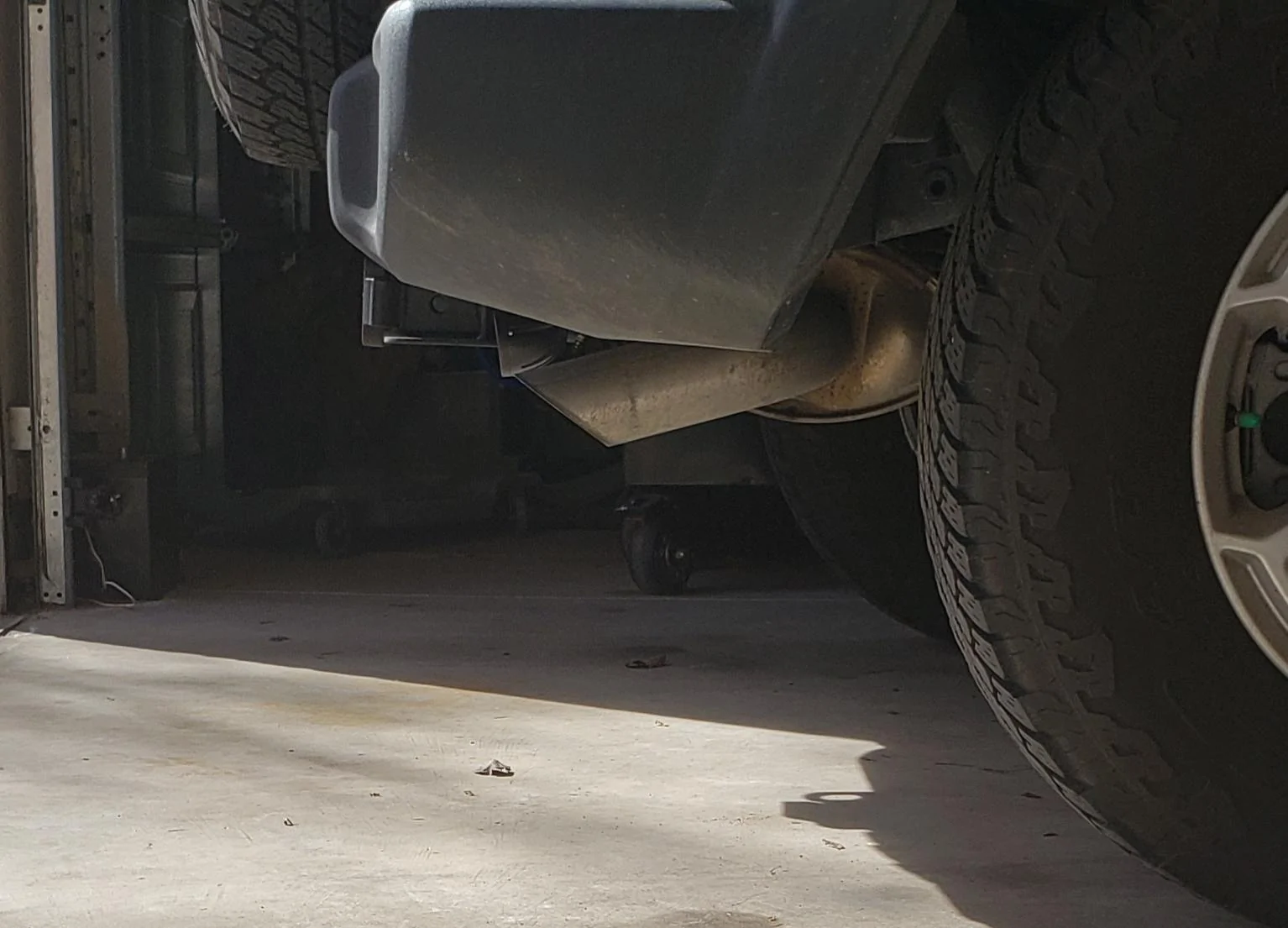

I just installed some lights that I found on Amazon that were marketed toward motorcycles. I wired them into the hitch wiring and mounted them in existing holes in the cross member. So far so good, just waiting for it to get dark outside so I can aim them. The lights are offered as spots or floods. I went with spots hoping I can aim them so they don't blind people behind me.
*Edit* Tried them out at night. They might be a little too spotty. I may try the floods. They look better on screen than the picture depicts, but they're not ideal.

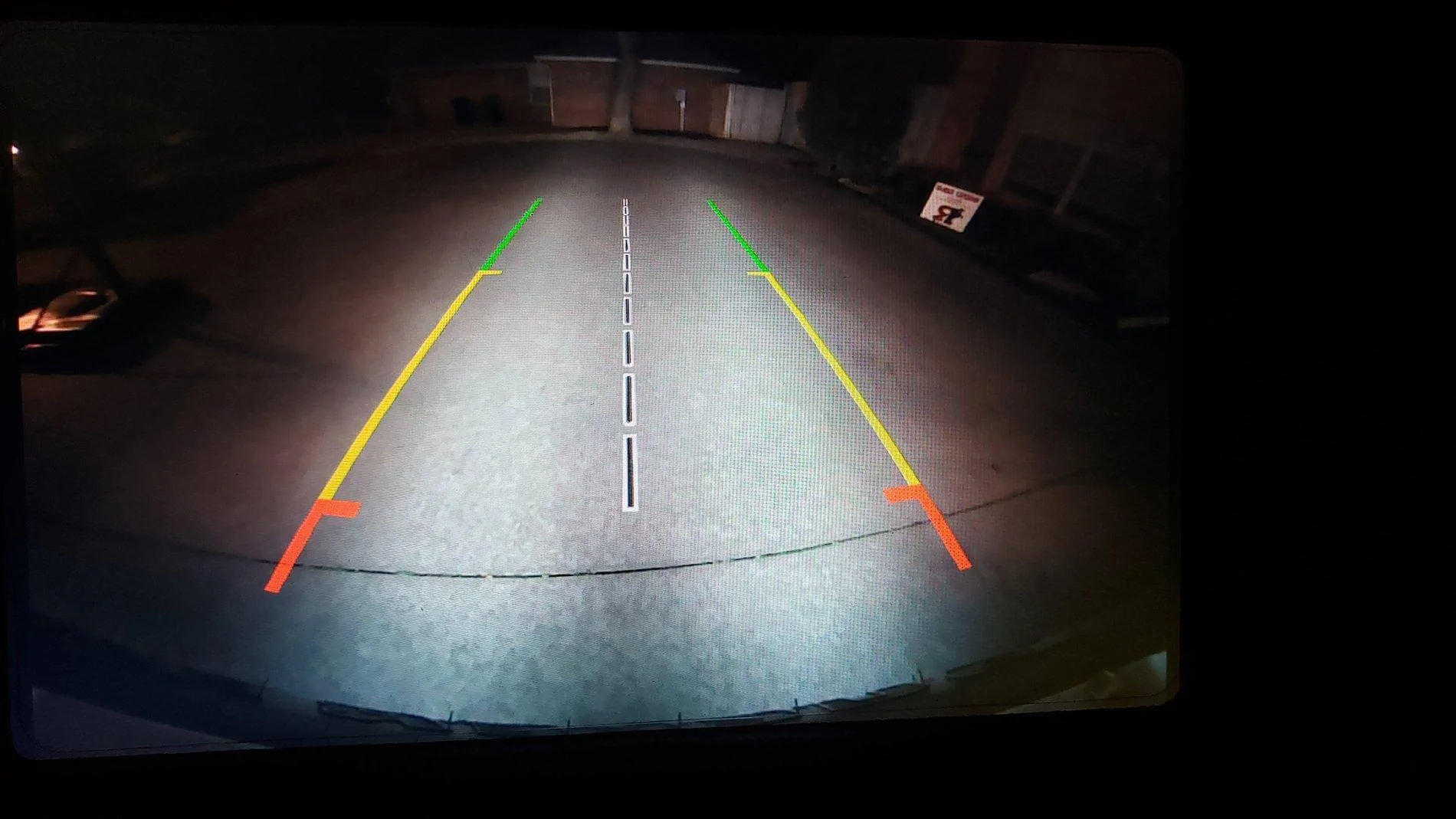

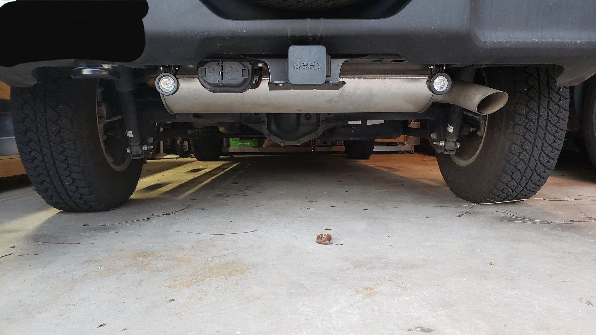

I installed the floods today. They're much better. Again, the screen looks better in person than it does in the picture. The floods spread the light out much better. I'm pleased for $18. I'm sure I'll find a use for the spots. Cargo lights, maybe...
