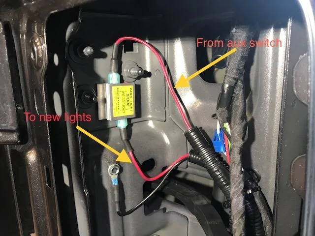

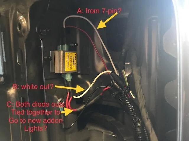

Hopefully these pics will clarify what I’m asking and where my confusion is. Credit @Bilymac as these are his original pics that I marked up for clarification. I understand the theory of a diode but using two is confusing. I’ve also done a lot of reading on similar installs on JKs and people use relays instead of diodes or in addition to diodes. It’s all a bit confusing.
First diode, presumably from aux switch or some other cabin switch:
Second diode - unclear what each of these are to me:
The “white out” is not needed. I assume it reconnects to the 7-pin and would light up trailer backups if the aux switch was turned on. Just tap into the 7-pin w/o wire, don’t cut it and forget about the white out.
Perfect. Thanks a lot.
Correct....the "White Out" reconnects the W/O wire for the 7 pin. I just chose to cut it, vs. tap into it.
Several different theories, several ways to accomplish the task, this was the way I chose.

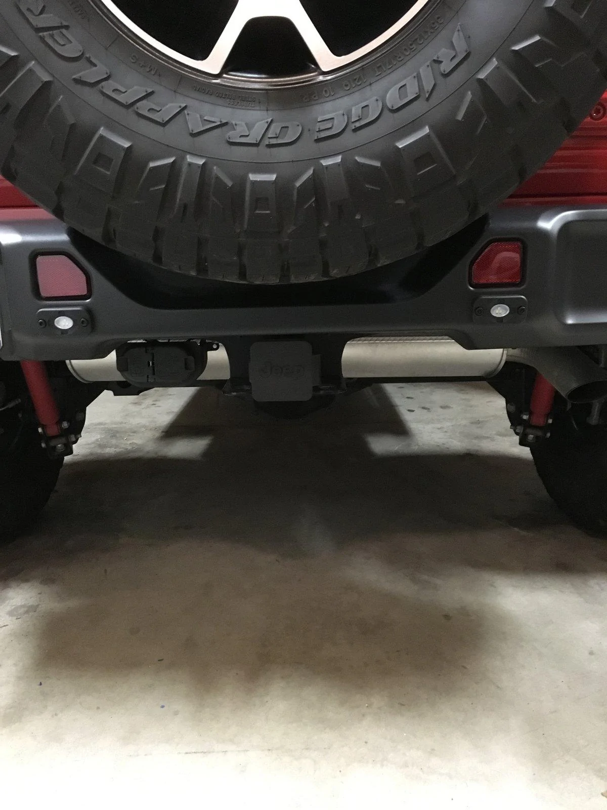

Here is what I did. Looks factory to me. Super bright! No low hanging issues as with other lights. 1260 lumens each!
How did you do the wiring? Are there instructions with the kit? If not, can you provide details?
Thanks?
vonbek
David
Jan 16, 2018
949
4,318
Georgia
2018 Jeep Wrangler JLUR
Do you not have parking sensors? Mine are right there where you put the light. I do love the look though
