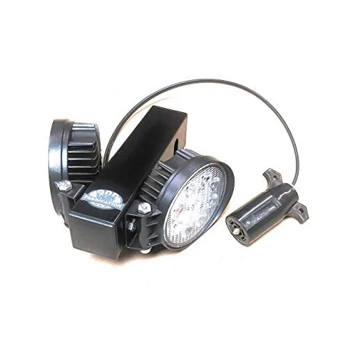

What do you guys think about these?
Jeep Wrangler JL Backup Lights 41Sbi32kA-L-500x500
They plug right in to the 7 pin outlet so no need to wire anything. They just work. It is removable, of course, so it is easy to take off before hitting a muddy, deep trail. At 4300lm, they'll be plenty bright and are easily adjustable. I'm thinking for $160, it is worth adding on
https://corfabrication.com/store/index.php?route=product/product&product_id=74

Accessories like that... that plug into the 7 pin, will over time... and not that long a time, be the cause of issues with the 7 pin.
My feeling is use the 7 pin for it's intended purpose and when you need it for it's intended purpose, it will work properly.
Also, no way would I pay $160 for that product.. absolutely no way..
That thing looks like crap also!

I don't like the square one but I don't mind the round one in my other post. Thus far, I haven't really liked any of the bumper mounted solutions. Now, if @InspiredEngineering makes lights to replaced the reflectors, my attitude about bumper mounted lights would definitely change

I agree with Rhinebeck01 that $160 is a bit steep for it, but otherwise it's a neat idea. Personally I'd just buy some lights, and bolt them to a shaft and wire up a quick disconnect for much less. You wouldn't have to worry about leaving your hitch plug connected all the time and you could get some lights that are a bit more aesthetically pleasing. All while saving $100 or so. Honestly if I had seen that before I would likely have explored the idea of making something similar. Not a bad idea, just a bit expensive and I'd find a way to connect without leaving the hitch plug connected all the time. Likely some pig tails similar to factory connectors (Example)
A piece of 2" square aluminum tube stock a foot long can be bought for $23 (McMaster-Carr), or you could buy a hitch step or something similar to mount the lights to for roughly $50.
Just some suggestions. I think it's a neat idea, but I'd do it myself.

7 pins have a cover on them and for good reason. The cover seals up the inners of the 7 pin quite well. The cover thwarts water, sand, yuk from working it's way up to the metal inner parts... the connections there.
Keep the cover seal clean and the cover closed, along with lubricating the metal connections in the 7 pin and that 7 pin will be usable when you really need it to it's intended purpose. As for me I pay close attention to the protection and maintenance of my 7 pin.
You leave the 7 pin cover open/ ajar, all the time... use the 7 pin 24/7, 365 days a year and you are asking for shortened life of the 7 pin or a problematic 7 pin, connections wise....
IF you rely on your 7 pin for it's intended purpose, you treat it accordingly, lets say. Use it when you need it for the intended purpose
........ and for your b/u lighting just wire up some aux lights. There are so may possibilities b/u light wise... and so easy to wire up. Why jeopardize your 7 pin.
