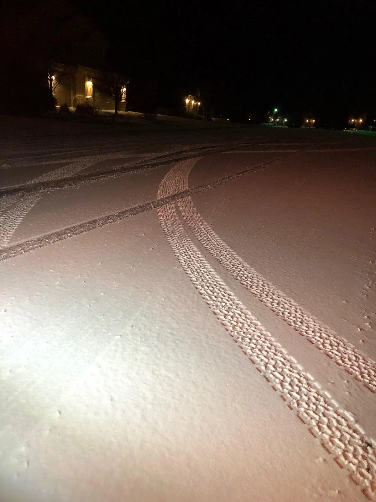

Can you take a night time picture of the beam pattern/coverage? Thanks!
Colorado Rubicon
Feb 2, 2019
68
261
Peyton, CO.
2018 Firecracker Red JL Unlimited Rubicon, 2014 Dune Clear Coat JK Unlimited Sahara, 2012 Ram 3500 Longhorn Dually, 2017 Jeep Renegade Trailhawk (Daughters), 2015 Polaris RZR 4 1000, 2014 Polaris Ranger XP 900 Crew
Looks good. I like the surface mount style. And, super cheap at etrailer ($16.85) and even available through Homedepot ($38.15) ...
I’ll get a picture tonight and post the picture from outside and from the radio.

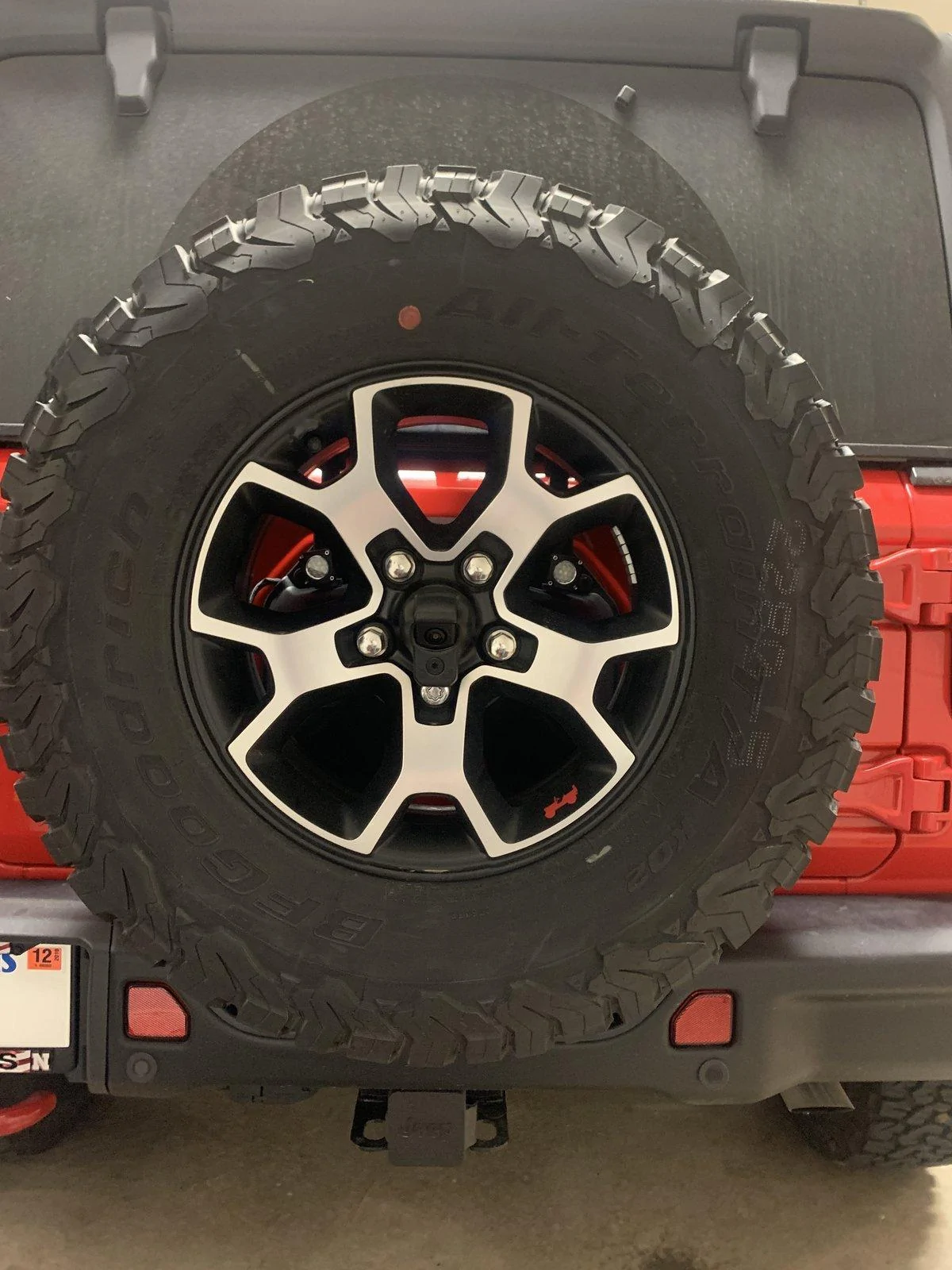

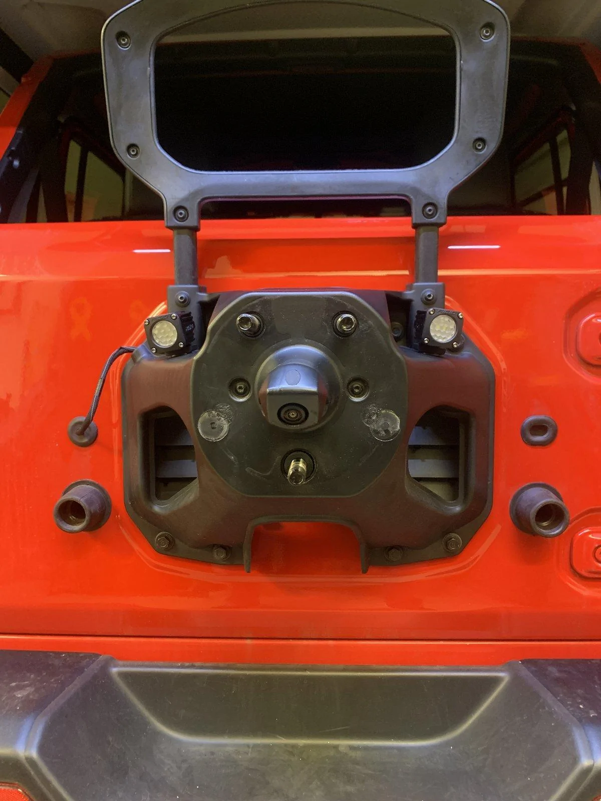

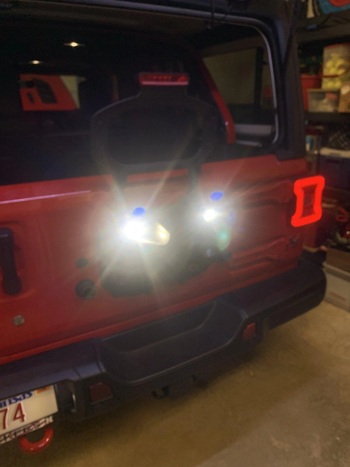

Finally got my Rigid Ignites hooked up. I followed @Rhinebeck01 instructions and several of you other Jeepers. Thank you
Man are they bright. I didn’t want them hanging down off the rear bumper so I mounted them on the spare tire carrier. Hooked up to Aux 3 and b/u wire (W/OG) on the 7 pin tow hook up. Used two diodes and it works great. Took most of the day, nothing else going on and I haven’t done automotive wiring since high school (that was a long time ago).

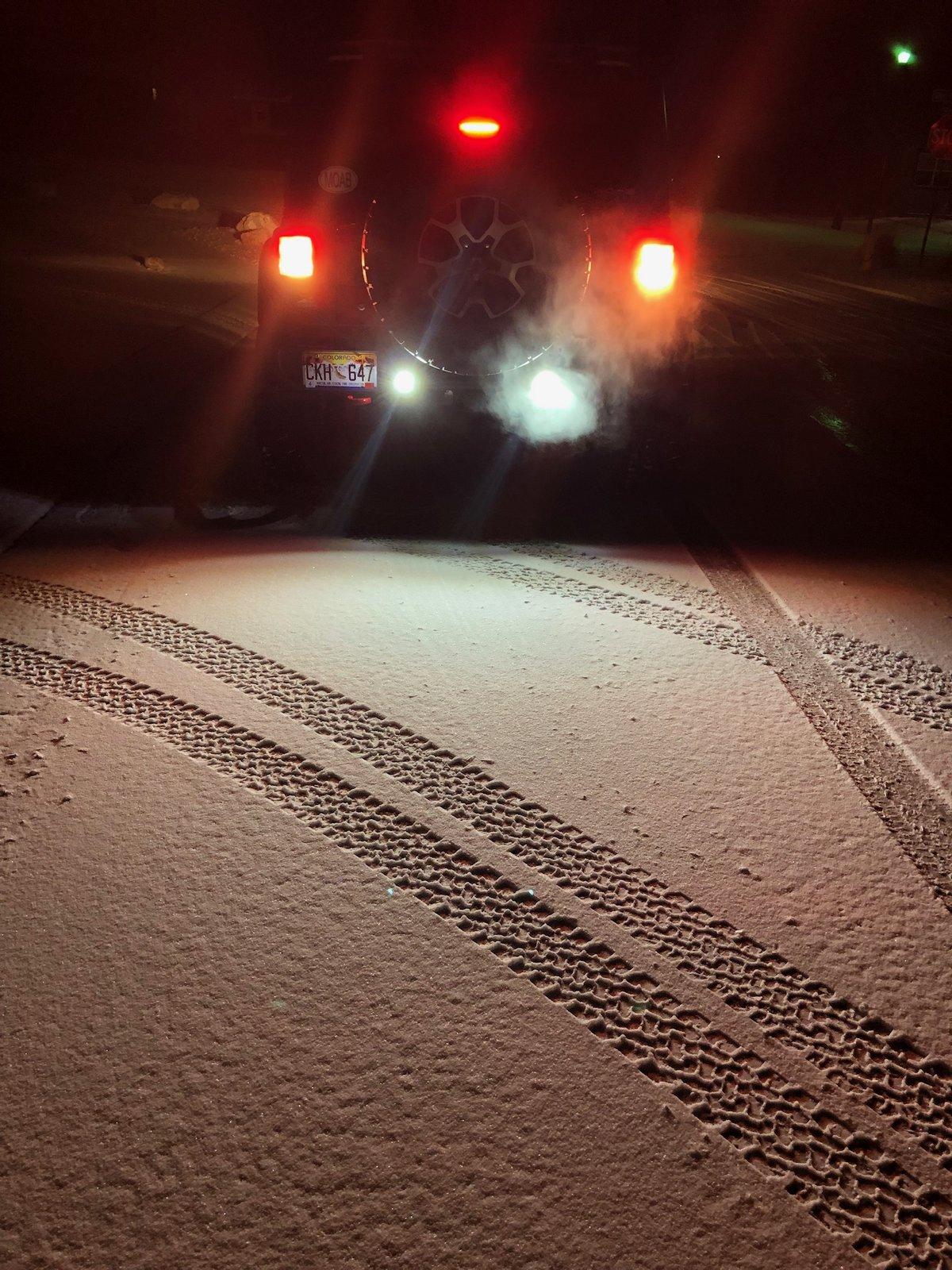

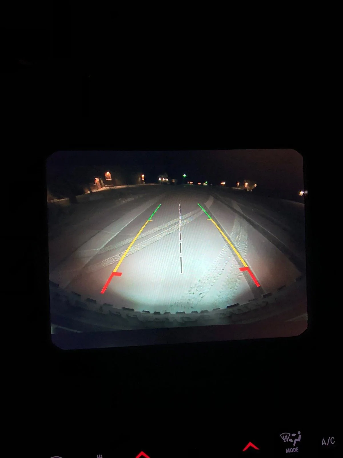

Here it is at night.
@Colorado Rubicon
Your picture is the poster child for why you want to mount the aux. backup lights down low versus up high.
Notice in that the back-up camera view/pic, there is no yellowing, no glare.. a clear clear view...
When you mount up high, you get glare, and the visual is just not the same as when you mount low.
Again this pic tells the tale so to speak:

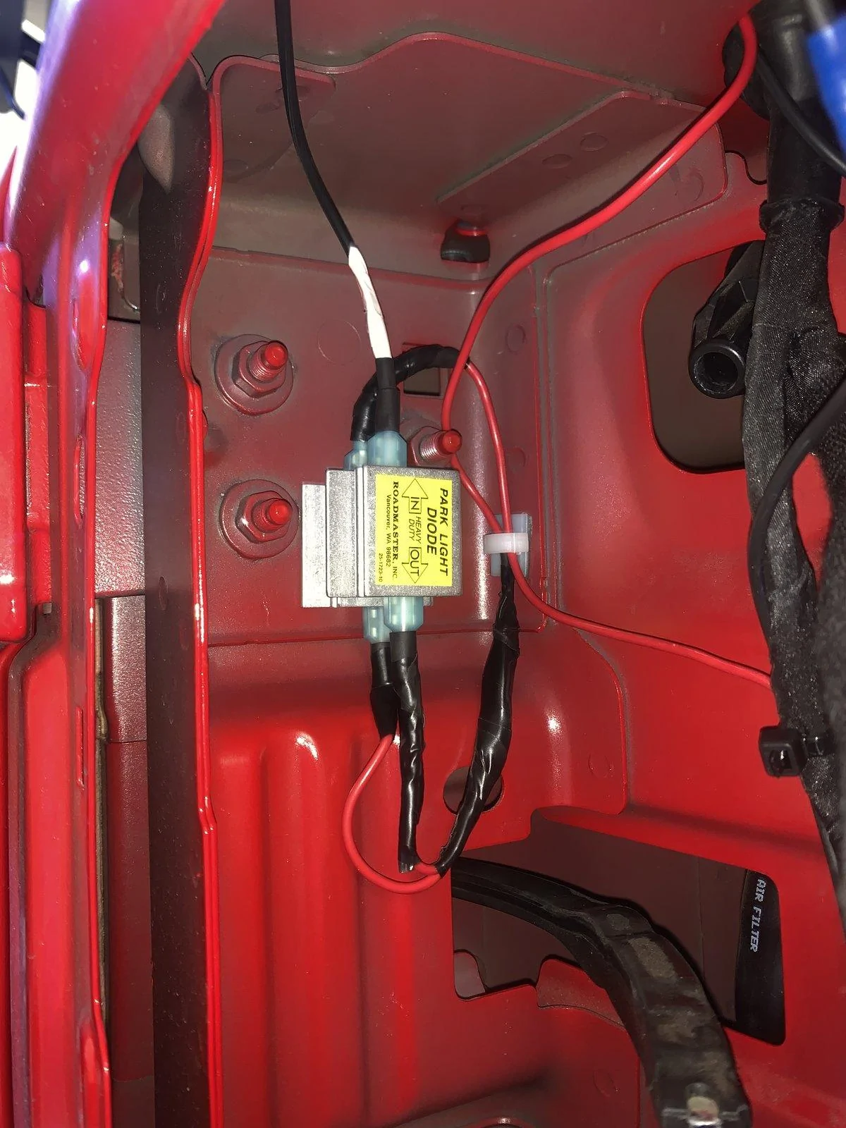

Can someone confirm if I have the wiring understood correctly? Sorry for the crude diagram.
Aux Switch——[in]diode[out]————|
7-pin—————-—[in]diode[out]——————————————————>LED Aux Lights
*connect both [out] diode wires to each other and then to aux lights
IronScott
Sep 21, 2018
32
1,007
1,224
NW Arkansas
2019 JLU Sahara, 1992 Jeep YJ, 2002 Chevy Silverado
Hopefully these pics will clarify what I’m asking and where my confusion is. Credit @Bilymac as these are his original pics that I marked up for clarification. I understand the theory of a diode but using two is confusing. I’ve also done a lot of reading on similar installs on JKs and people use relays instead of diodes or in addition to diodes. It’s all a bit confusing.
First diode, presumably from aux switch or some other cabin switch:
Jeep Wrangler JL Backup Lights FA306AC8-F093-4E87-8EA6-16AF5DC47B0F
Second diode - unclear what each of these are to me:
Jeep Wrangler JL Backup Lights 95F7DA65-F1E2-4934-BF20-9490839ADBFA
