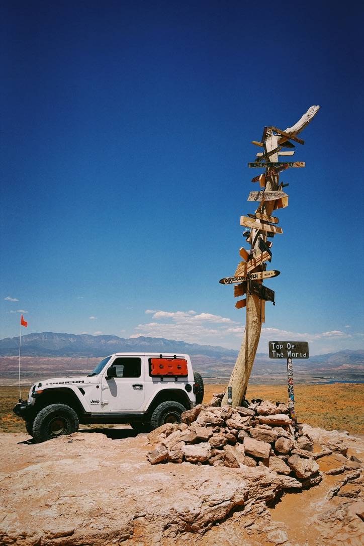

There were aux tanks for the 2 door JK I believe, so only a matter of time until someone makes one for the JL. 2 door JL parts have come out incredibly slowly though. There's a lot of space if you delete the muffler (or run a Borla or something, I hate the way a straight delete sounds) and the non-etorque models have a big space good enough for 4-6 gallons in between the frame rails behind the Tcase.
I've been running a trailrax system with a 4 gallon rotopax on mine for long excursions. Brings the fuel capacity up to the 4 door capacity at least. Figure I can run one on the other side if I ever need more.
