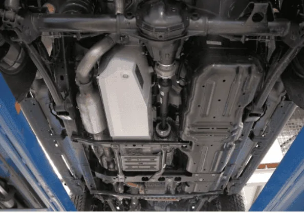

If you're talking aux fuel tank that feeds into your main there's a company called long ranger based in Australia that makes a solid product. Here's the link: Long Ranger. I contacted them a while back in regards to whether or not the 2 door v6 tank would fit on the 2 door 4cyl and they weren't sure as they haven't had a vehicle to test it on. I'm fairly certain someone in the forum has installed this on their rig.
Here's a pic:
Jeep Wrangler JL Adding an extra fuel tank in a 2dr? 1679967137968
Here's a pic:
Thanks Chris… I will look into this. I have a V6 auto.

That 10 gallon LongRanger tank looks nice, but I'm wondering if it would still fit with the 48V eTorque battery or whichever auto-4WD component interferes with certain exhaust systems (Borla Climber with mini muffler near cat).
The 25 gallon GenRight muffler delete tank is a smart idea, but is only for the 4-door, though I'm still not 100% sure why it wouldn't work for the 2-door. I'm guessing maybe something to do with needing to remove the plastic rear tool storage tub?
https://genright.com/shop-by-vehicle/jeep-jlu-25-gal-gas-tank-with-skid-plate/

I have a tank on order from Long Ranger. The only dealer in North America is out of Vancouver Canada. The tank will not fit with the eTorque system. They do not stock 2-door tanks, custom order, they do try to keep 4-door tanks in stock. Just don't confuse Long Range (North America dealer is Long Range America) with Long Ranger, two different companies. Only Long Ranger makes a tank for a 2-door.
https://westcoastoffroaders.com/
