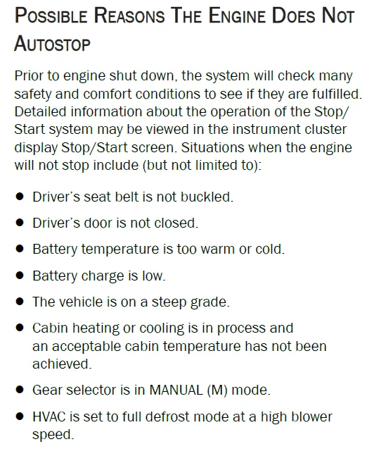

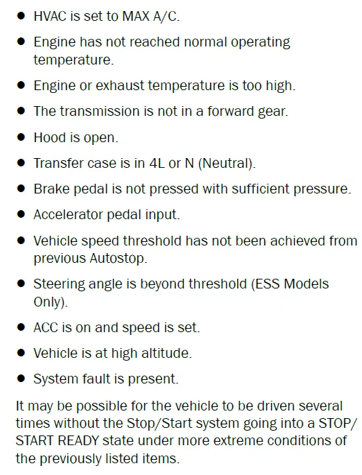

What does the screen say in the cluster when you leave it on the auto stop info page? It will tell you why it isn't shutting off. May or may not be a problem.
Jeep Wrangler JL Auto stop off 1773632342317-5l
Jeep Wrangler JL Auto stop off 1773632378103-3x
