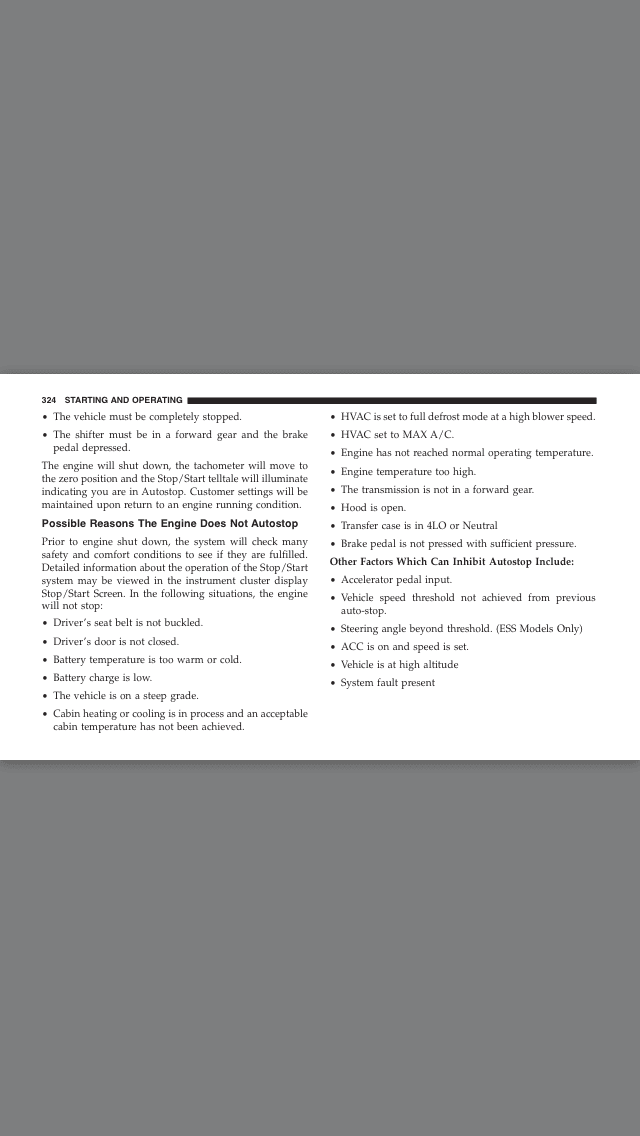

Looks like if the driver doesn't have their seatbelt fastened the engine won't turn on autostop. There is no need to hit the button every time you get in if you don't wear your seatbelt! Cool!
The dealer told me you can trick the Auto Start/Stop by plugging in a trailer hitch plug as well(He mentioned doing it on other Jeeps with the it.) I didn't go into the details since mine won't have the tow package.
