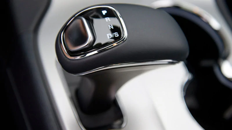

That safety feature was made because of this stupid shifter. Here's what it looks like in park:
Now here's what it looks like in drive:
It had just enough slop in the release button that you could 'shift into park' and actually end up in neutral. It'd feel exactly like you had it in park, and the car would beep the same way when you opened the door, so it was easy enough to not notice the car wasn't in park.
Of course, you should always use your parking brake. And they never should've made a car with such a stupid shifter.
