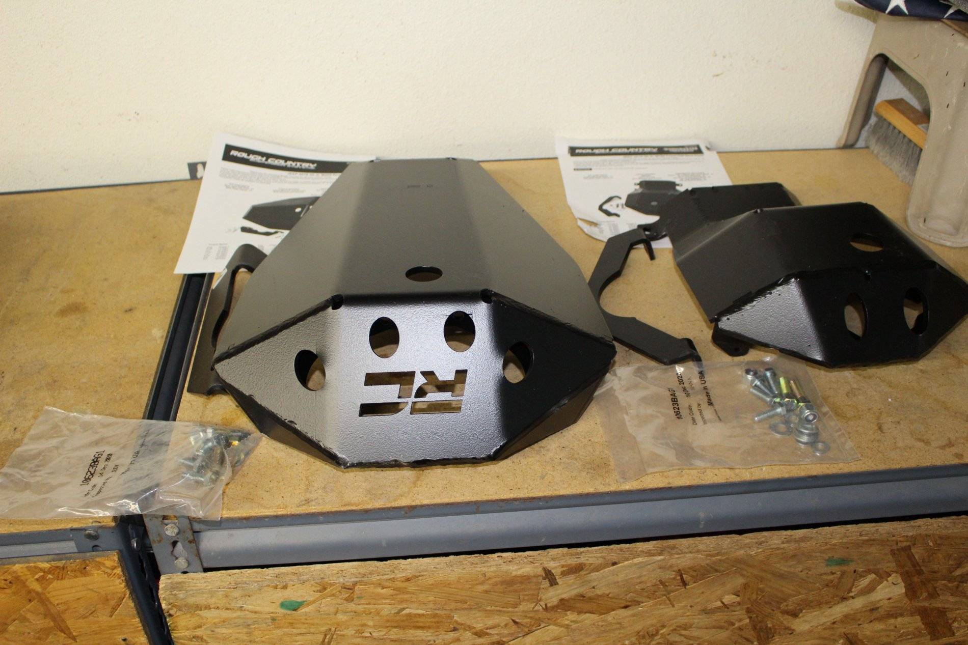

Ordered a set of the RC covers yesterday., the ebay Rough Country store has the best price that I found, $75 for the front and the back. Pretty heavy too, pkg info said 25lbs for rear & 15 for the front.

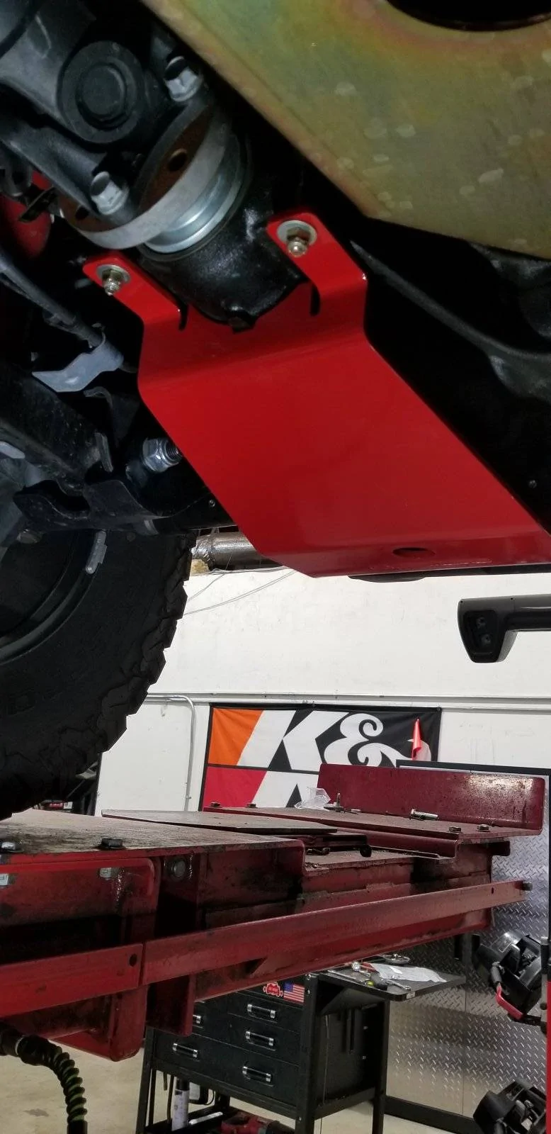

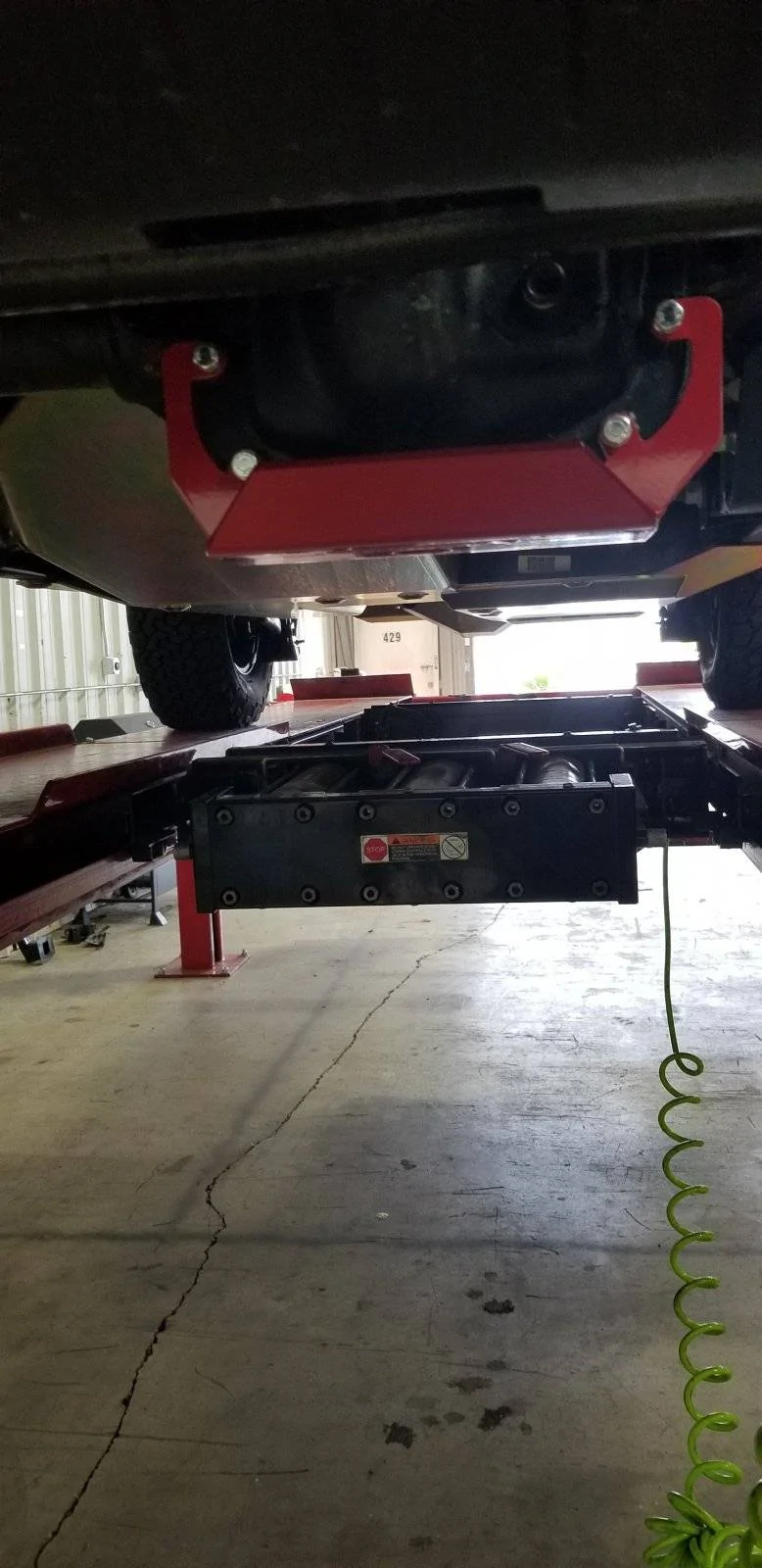

I also had to pull the front skid as it made contact with my oil pan/transmission skid plate support.

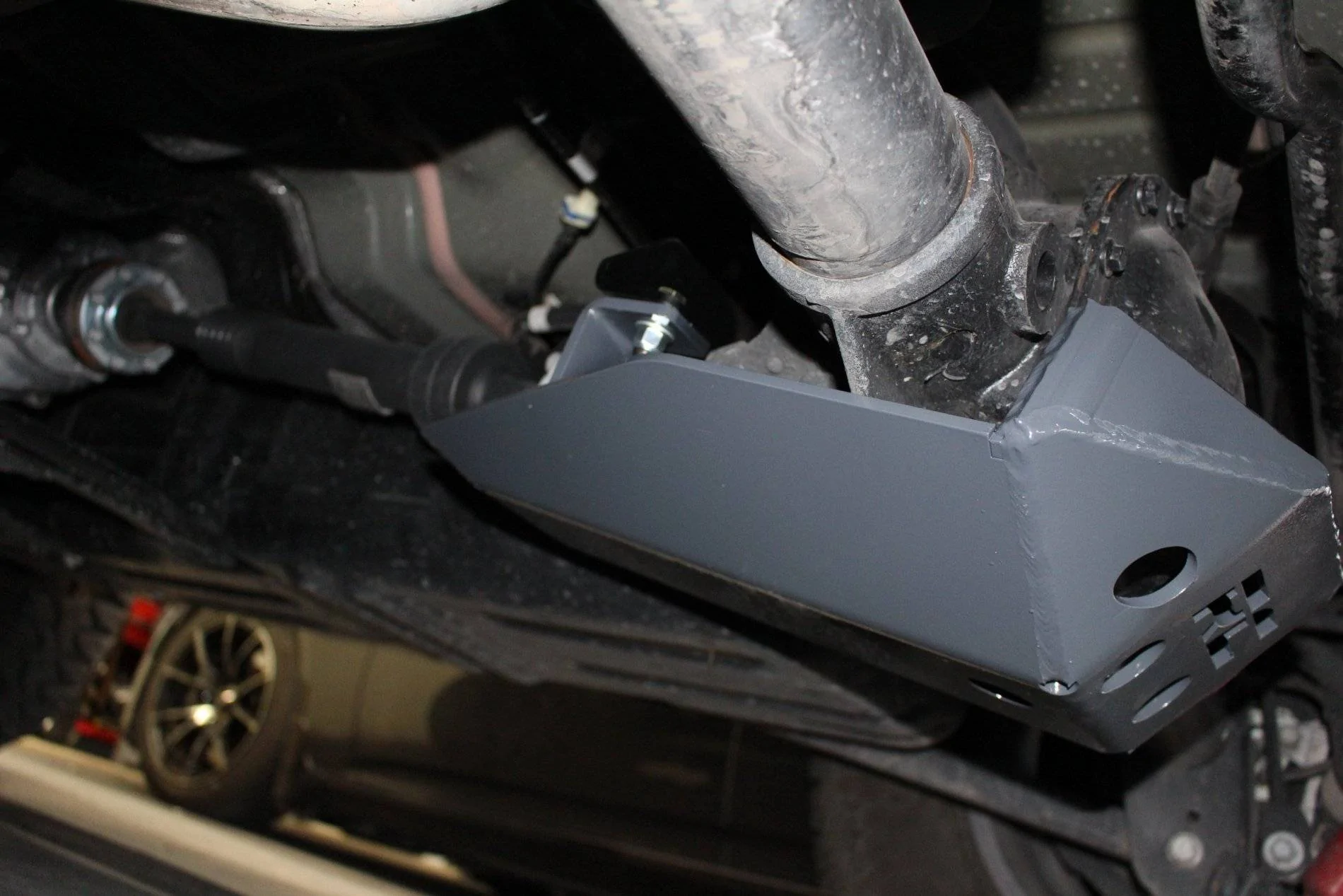

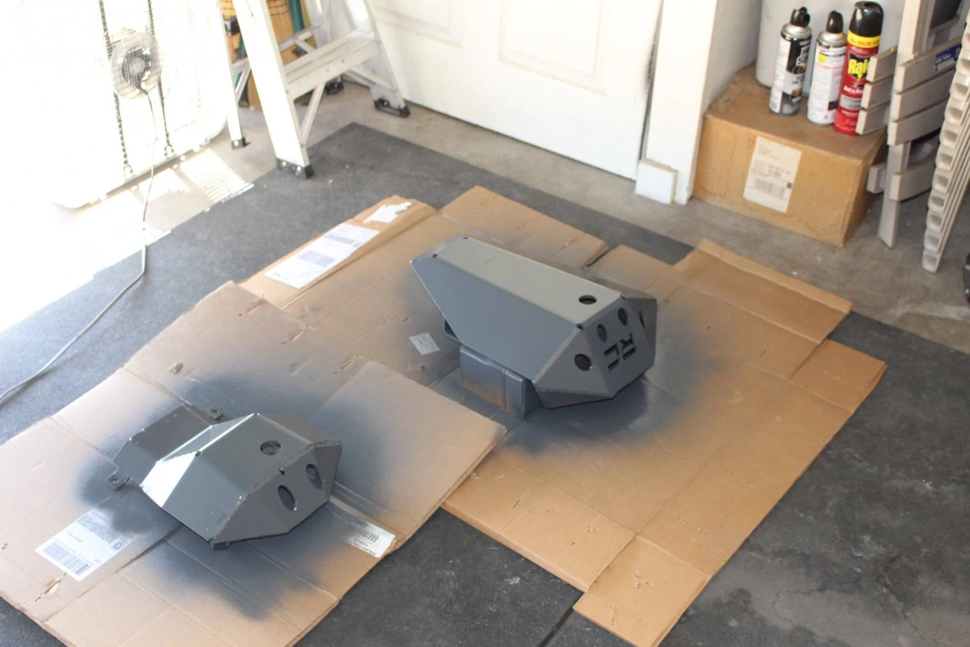

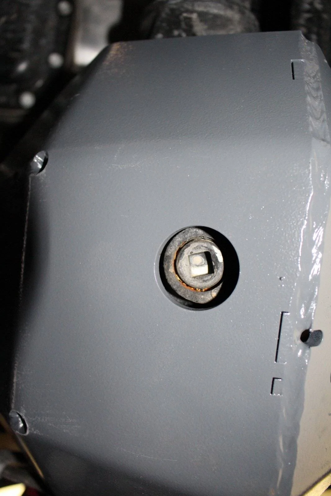

Got them installed, must say I'm 100% satisfied w/ the fit & function of these plates. No bending, prying or hard time trying to get everything lined up. All the cover bolts lined up perfectly, the retention hanger in the back of the plates secured the skids nice & tight, and the drain hole F&R also lined up just right!
I measured a before & after~ the lowest point at front diff was 11.25" from the ground, the lowest point on the skid was 10.5" so a 3/4" drop in clearance in front. The rear was 10.75" before and 10.25" after the skid was installed for a 1/2" loss in clearance, not bad at all :)
There is nice coverage over the rear driveshaft to pinion mount too. I used a floor jack to get the rear skid lined up as it is pretty heavy and wanted to make sure I had all 4 of those bolt hole lined up, worked out well. Only concern is if it's still ok to jack it up under the rear skid now, this thing is solid as a rock but being mounted to those 4 diff cover bolts I'm not 100% sure???
