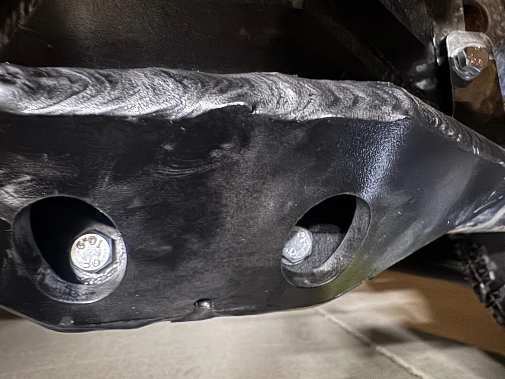

I have front and rear RC diff skids to install. I started on the front skid tonight and the bottom two bolts are not threading into the holes at all. I noticed that the “wall” on the skid plate that they must pass through doesnt not sit against the diff. There is maybe 1/8” of space. I dont know if its the motobilt diff cover causing the issue or if its because it is a 392XR axle which is slightly beefed up from standard M220.
is anyone running this diff skids on a 392 XR? Or running this diff skid with motobilt diff covers?
going to run to home depot tomorrow to grab slightly longer bolts.

What year your Jeep?
mine is a 2018. Axles are out of a 2025 392.
Thise two bolts are M8 1.25x25 i picked up some M8 1.25x35 and they worked fine.
I installed them on my 2026 Rubicon X (which has the same axles as the 2025 392), and yes the front was very finicky to install - it took me a good 40 min to figure it out. It is all about the correct tilt angle of the diff skid. I think I loosely installed the rear cross bracket, then played with it until everything lined up.
But yes, I came close to giving up. The skids are solid once installed and have taken some good hits since.
