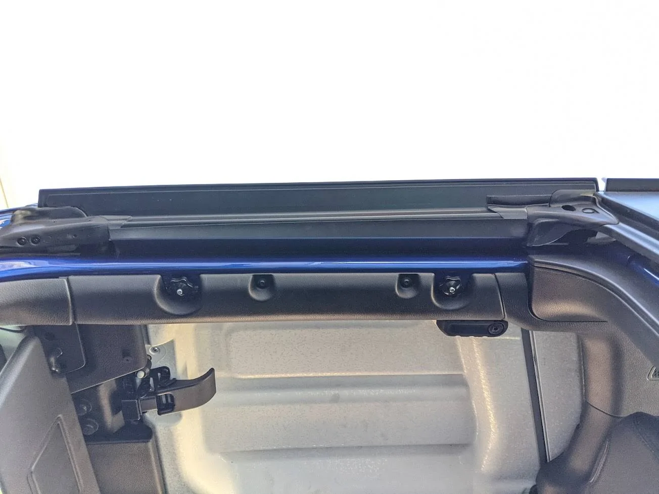

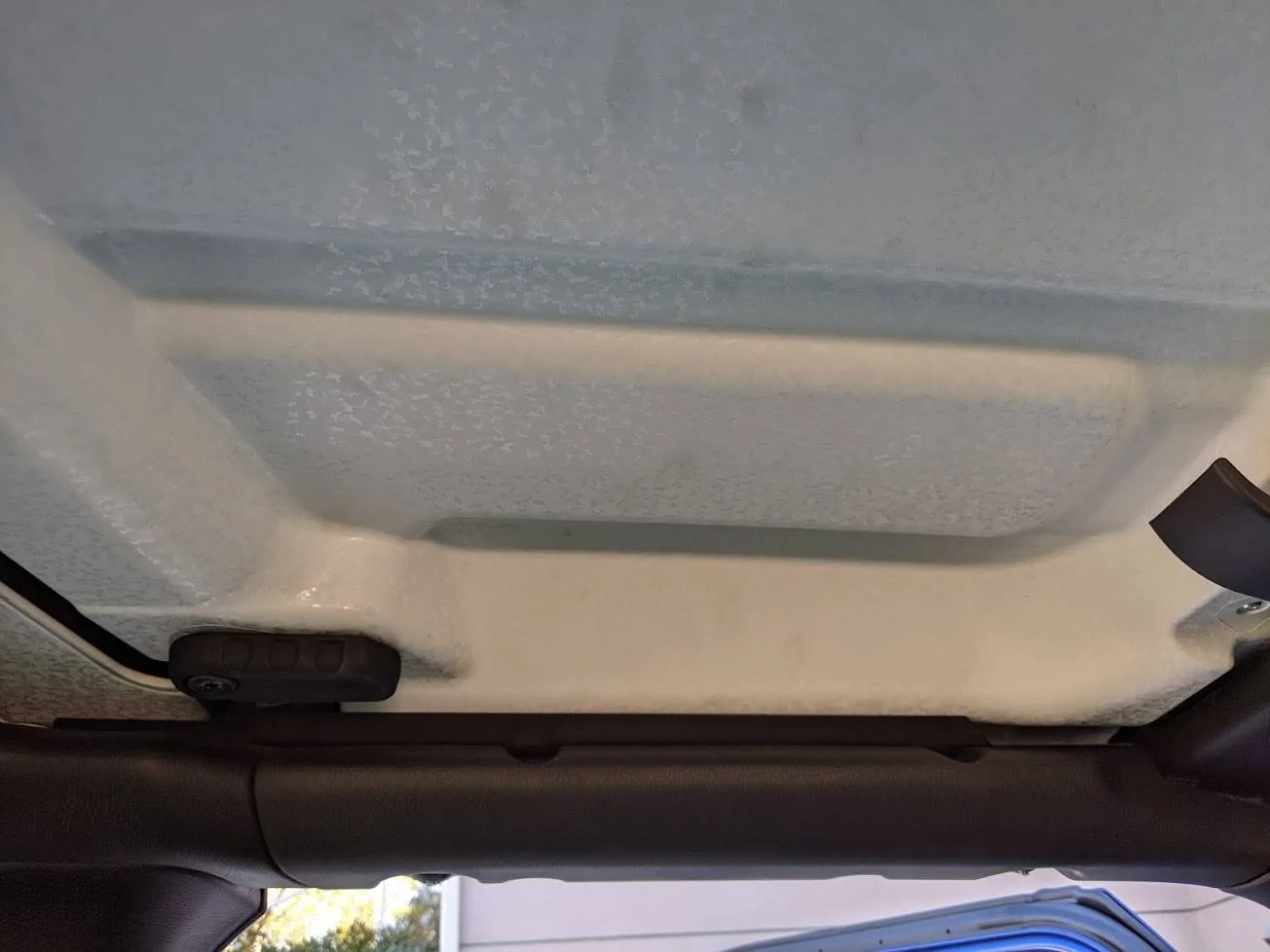

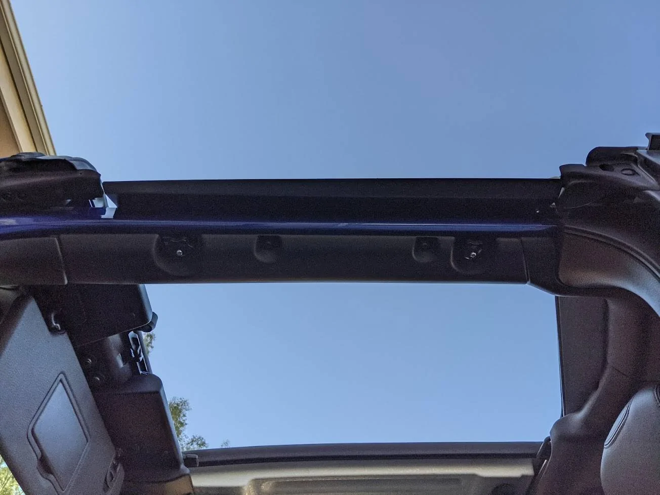

Can you do a write up on this? I'm very, very interested.
I haven't really perfected it yet as there is some light rubbing with the freedom tops in place. Won't cause damage, but the squeaking is annoying. A different bend angle might work better.
You will need a sheetmetal brake to make the bends and source some hardware (2.25" 1/4-20 carriage bolts and something like this is what I used). The DXF file attached (in the ZIP) can be used to cut the shape at some place like sendcutsend.com. It doesn't need to be that thick, 24 gauge will work fine. I've also attached a PDF for easy viewing.
Below is what the shape looks like, red lines indicate the bends. The curve on the bottom goes next to the door. The bolt hole section and part closest to the door should be level, with the other sections at around a 120-135 degree angle.
Jeep Wrangler JL Anyone fold down their windshield? 1
There are little indents to help with locating the bends
Jeep Wrangler JL Anyone fold down their windshield? 2
When done the section next to the door is bent low enough to just barely clear the lip of the freedom tops.
Jeep Wrangler JL Anyone fold down their windshield? PXL_20201128_183441996
Jeep Wrangler JL Anyone fold down their windshield? PXL_20201128_183556419
Inside gets bent upwards at same angle.
Jeep Wrangler JL Anyone fold down their windshield? PXL_20201128_183615646
