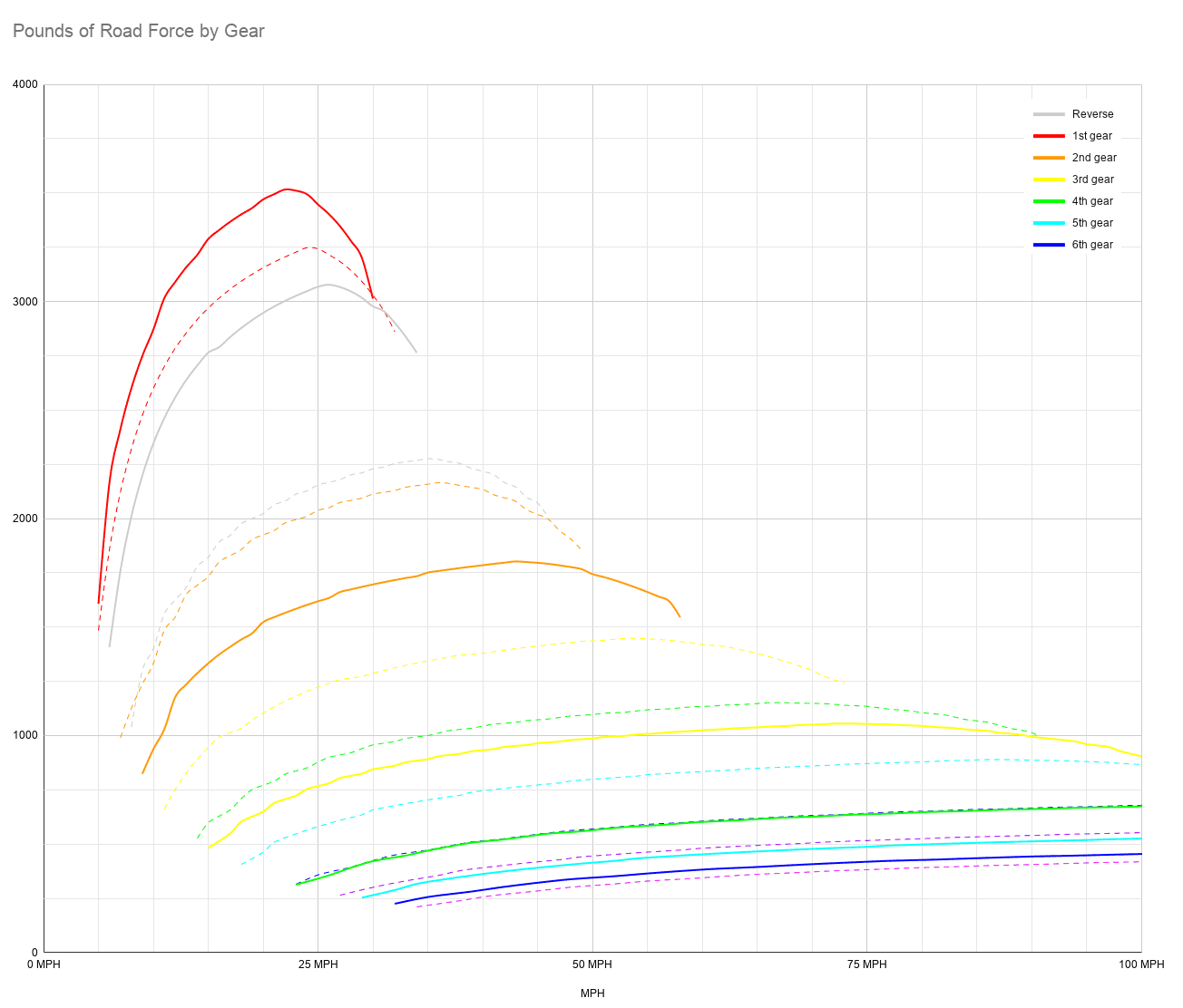

I put this graph together a while back, but haven't shared it much since people get all bent out of shape about how the engine power was being calculated. I didn't calculate it, it's was obtained here.
Basically what I've done is graph out the pounds of force that the tire exerts on the road in each gear. This doesn't account for drivetrain loss, torque converter multiplication, or flywheel inertia... so it's probably best to ignore first gear. The only place where the Manual transmission exerts more force to the road is between 49-58 MPH, and from 90-95 MPH (which is the speed limiter on the Rubicon). At all other speeds, the automatic has the gearing advantage.
Solid line = Manual 3.6 Rubicon
Dashed line = Automatic 3.6 Rubicon

Drivetrain loss from the converter needs to be added to your graph. There's a lot of parasitic drag in an auto trans.

Good question but no, I just know it def exists. A lot of parasitic drag in an auto trans and probably 200lb of extra weight

Numbers I'm finding online are showing around 15% drivetrain loss for a manual, and 18%-21% for an (older) automatic drivetrain. ZF did quite a bit to reduce losses in the automatic, so for argument's sake and ease of manipulating the numbers, I'll just make a high guess and say that the manual transmission itself is 100% efficient and the auto is 95% (at all engine speeds). Apparently the differentials aren't very efficient... probably has something to do with the 90 degree change in rotation.
With this complete guess of efficiency, the manual's gearing advantage is from 49-58 MPH and 83-95 MPH. The only change from the previous graph was 83-90 MPH.
I'm not going to quantify the weight or the automatic's shift times, mostly because I don't know how but also because it would just be easier to find two appropriate Jeeps and race them.

Dude you don't understand how a torque converter works... Torque multiplication only happens at low speed, and maxes out at stall speed, which is given in rpm... Not a ratio.
Also, you don't get that for free, it's quite inefficient, which is why most modern autos are locking- to include the zf. When you are accelerating along your converter is most likely locked.... Your chart is way way wrong

I love anndees charts but yes, you're correct., lets provide him the data to make a correct chart. Driveline loss is severe with the auto trans.

Well, that's going to be tough, you'll need to know stall speed, and the torque multiplication and loss from whatever your launch is to when it locks. I would bet it locks up pretty early... I know it's locked when you're cruising at 1200 rpm, but I have no idea on the logic at a hard launch.
However, data on old autos shows torque multiplication is essentially gone by 2k, so you could plot the stated ratios from 2k rpm and above and be accurate. To account for losses, the zf is pretty efficient locked up, so I would estimate 1-2% off the auto...
You are mistaken, I never said torque multiplication happens at all speeds. And yes, torque converters are rated with a given stall speed, with modern converters approaching 1:1 at the stall speed before locking. There is a range of ratios that the torque converter operates in, with lock-up being 1:1. Anything not 1:1 results in some amount of torque multiplication, which is constantly changing. My example was that even with a miniscule amount of torque multiplication, the apparent gearing is greater than the manual's first gear ratio. Even with pumping/efficiency losses, the automatic's first gear would provide greater force than the manual.
Since I guessing you didn't like Wikipedia as a source, here's another "Typical stall torque multiplication ratios range from 1.8:1 to 2.5:1", and another "Torque multiplication rapidly decreases until it reaches a ratio of 1:1 (no torque increase over crankshaft torque.) A typical torque converter will have a torque multiplication ratio in the area of 2.5:1"
You missed it in the original post, so I'll say it again: regarding the graph, it's probably best to ignore first gear. I said this because there's no way that I know of to quantify when lock-up happens. True, the rest of the chart didn't take into account any losses (which I noted), please see this post for one that does. Neither chart is factoring in any torque multiplication at any point. They are both based off of the published gear ratios, tire height, and engine torque from here. The second graph has the engine output at 95% on the automatic, to simulate the automatic's lower efficiency.
Also according to Wikipedia (and a dead link to ZF's website) the ZF8HP70 (which is stronger than the Jeep's auto) weighs 192 pounds. I can assume the Jeep's 8HP50 is not any heavier, which is way lighter than I expected. This doesn't include the transmission cooler/lines/fluid, but I'm not sure the auto's weight penalty is as much as we expected.
