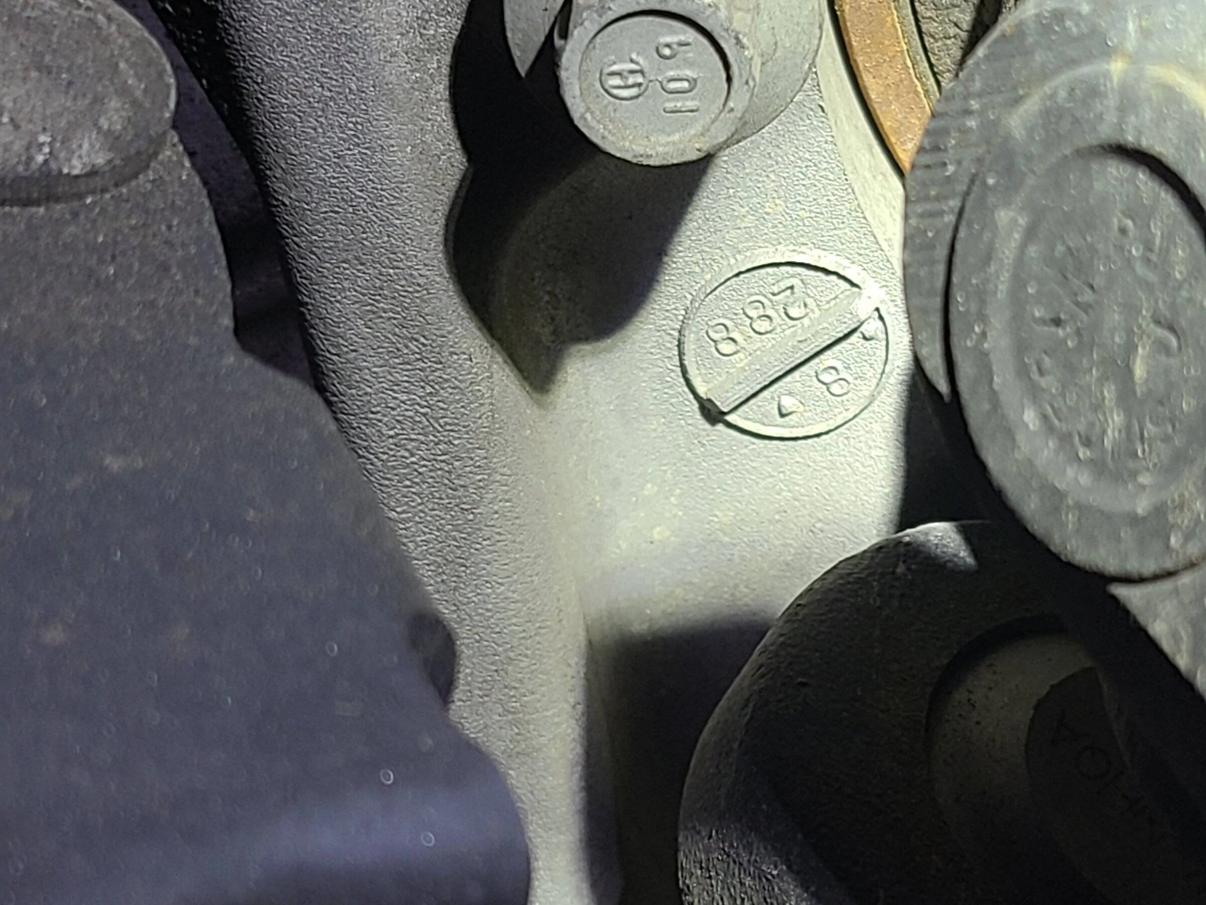

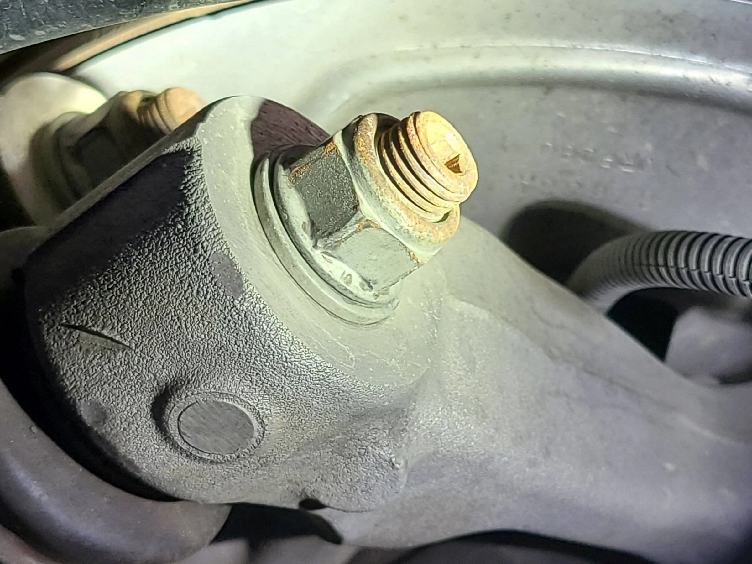

I thought I had looked at them before and they had looked forged to me. So, I looked again this morning. Sure look forged to me. The fidelity of the lettering and foundry timer is too fine to be sand cast and the parting line is wider than I'd observed in permanent mold low pressure casting. My background includes manufacturing engineering with a focus in machining, not forging or casting. But I've seen a lot of both.
