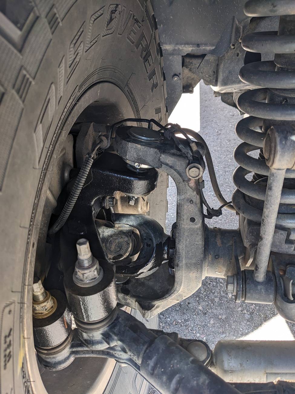

Adv_aw8s
Rob
May 30, 2021
476
753
2021 Rubicon diesel
I purchased some used knuckles off this forum from a 392 and swapped them out with my aluminum ones on my JLURD. I also install dynatrac ball joints at the same time.
