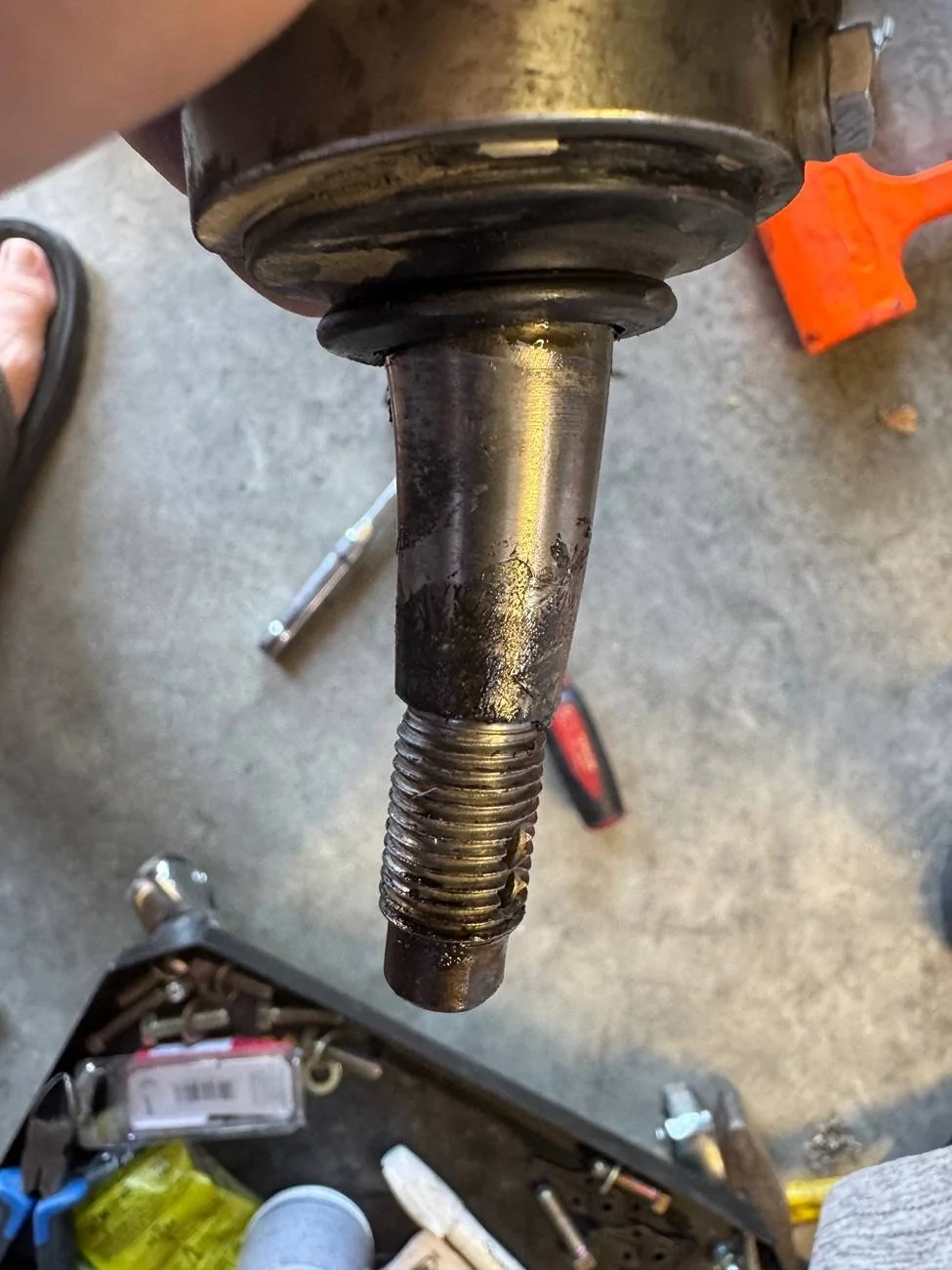

Looks like a ball joint failure, not a knuckle failure. The stud is still solidly attached to the outer knuckle. The movement is in the aftermarket ball joint itself.
I thought I saw the nut move?

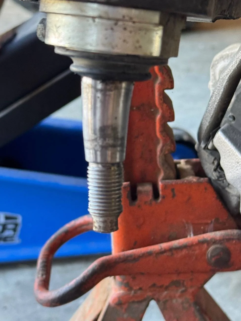

It's hard to see in this video, but if you can zoom in you can see the nut moving. I've already verified it is still tight. I"m going to take the Jeep apart tonight or tomorrow and get it ready for the new parts. I've been having issues since I got back from California with that side, and I'm 99% sure the knuckle is bad. I'm replacing it with the factory aluminum since warranty is covering it, but as soon a I get the money I'm switching over to the iron ones. I do wheel as much a possible, but I'm not so hard on the Jeep that they should've gone bad.
That nut looks like it's very far down the threaded area of the shank. If the nut is still "tight", it's likely bottomed out on the thread runout, and the taper of the shank was not tight in the tapered bore. Check to see if you just ran out of thread when you disassemble it. There really should be a steel washer between a nut and an aluminum component. Not saying OE had a washer, but they should have. And in your case, the installer should have seen how far down the shank the nut was going and put in a thick washer to keep the nut from bottoming.
