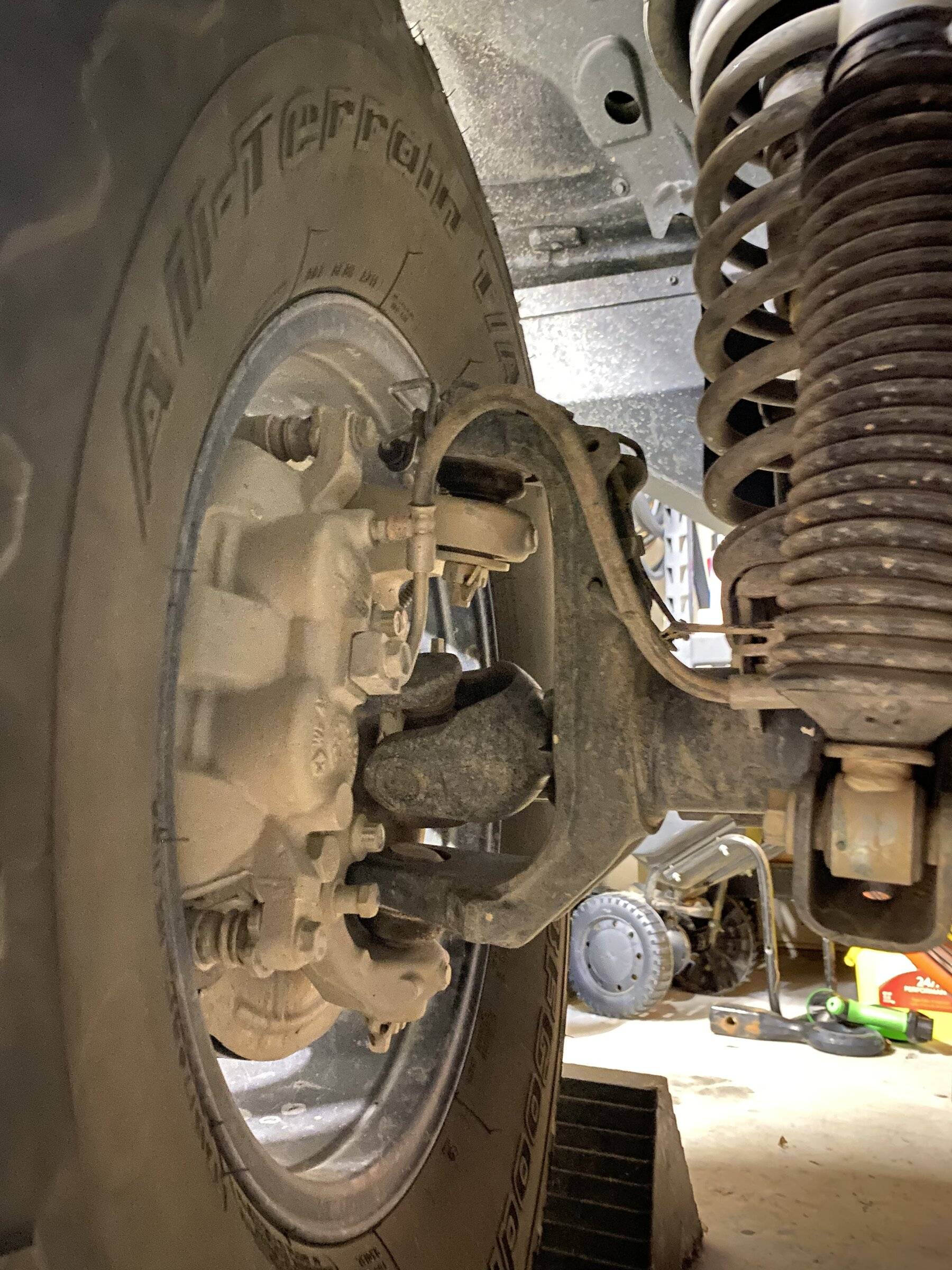

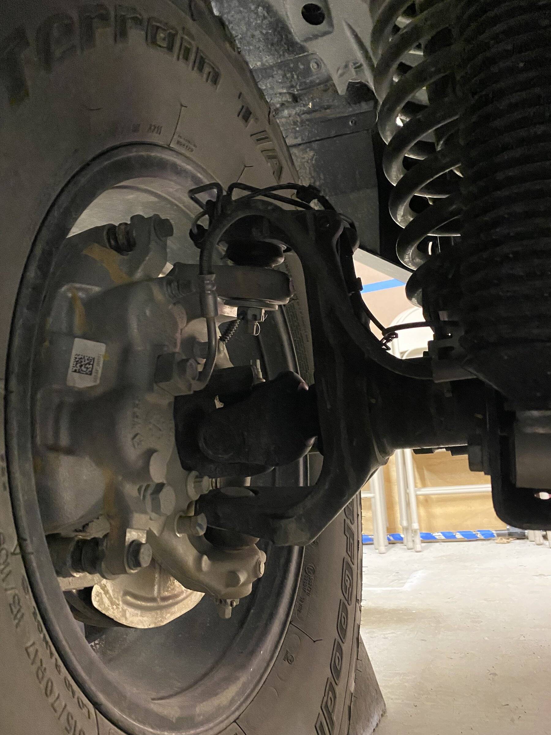

I had to go see for myself and sure enough... Bummer. What about the C deal on the axle side? It looks darker on the diesel than the gas one.
Diesel
Gas
Both on the axle side are steel/cast steel.
