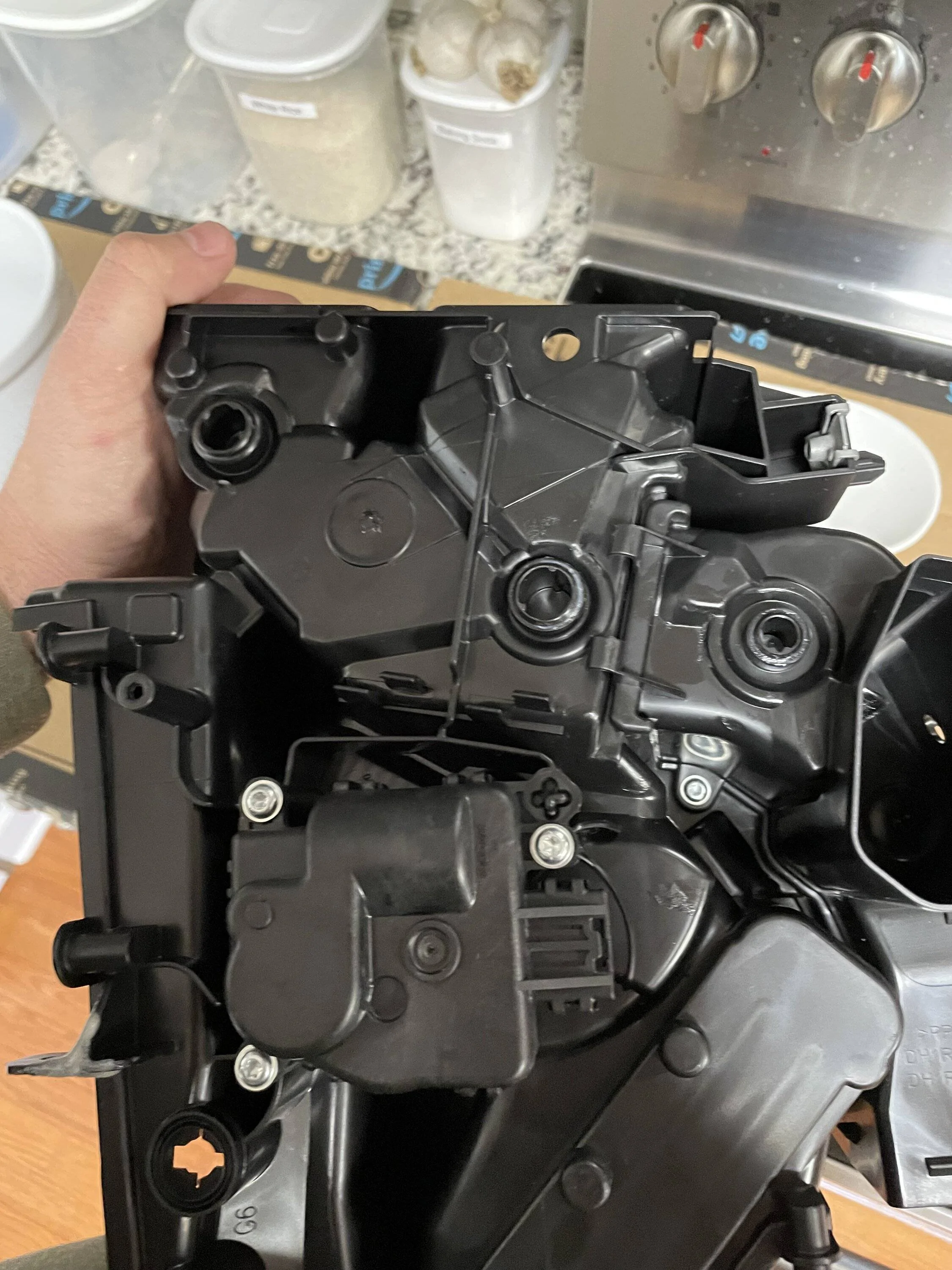

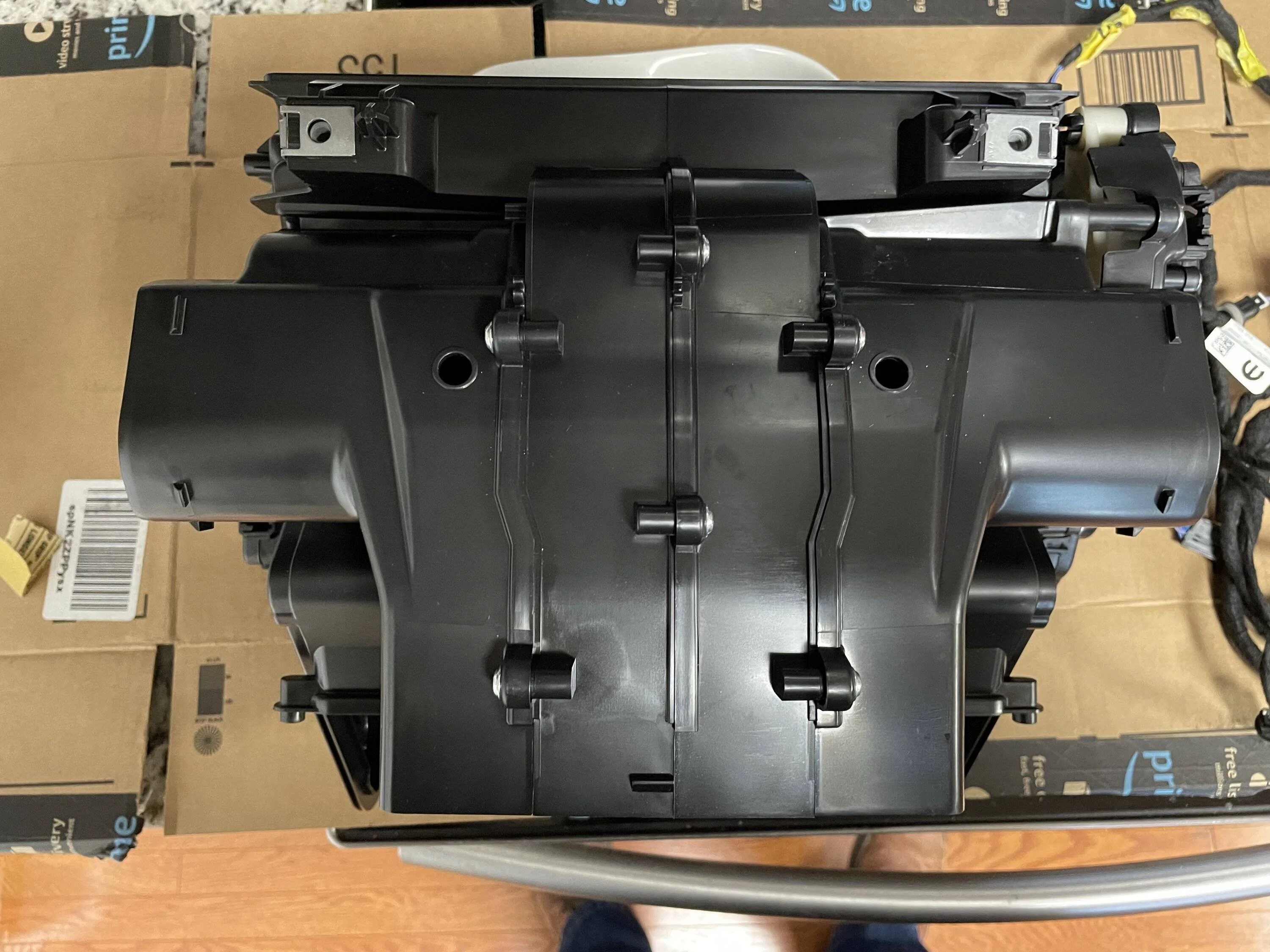

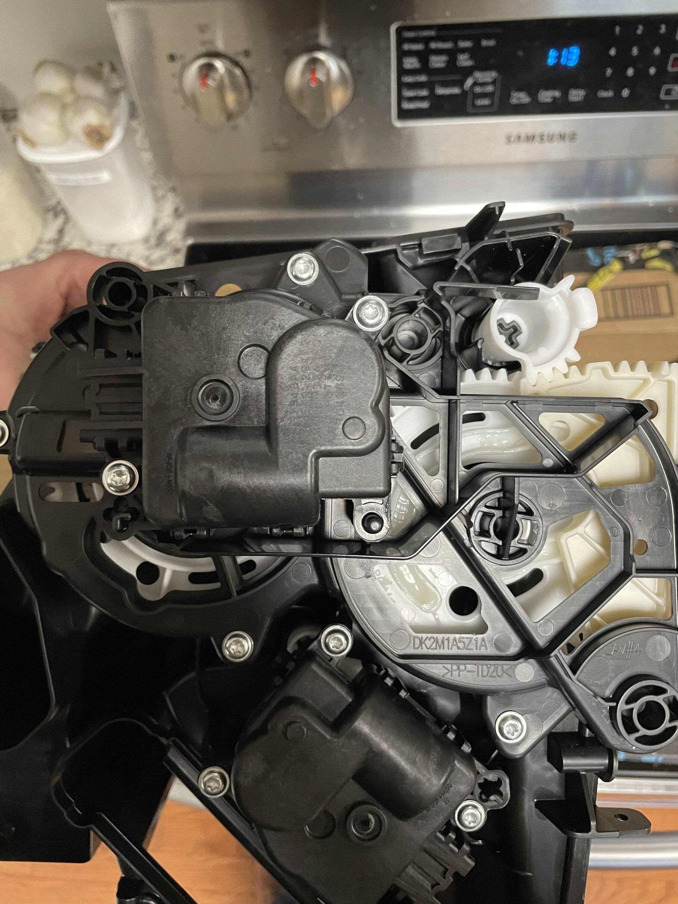

Doing this mod is one of the most challenging things I've ever done and it isn't for the faint-hearted. Plastic clips in the dash will break and you will invent new swear words taking things apart. I'll attach some pictures of an ATC box for everyone to look at.

Below are some images of the ATC air distribution box. The MTC box will have a sensor in the front left of the box but all the other holes will be blocked off with plastic.

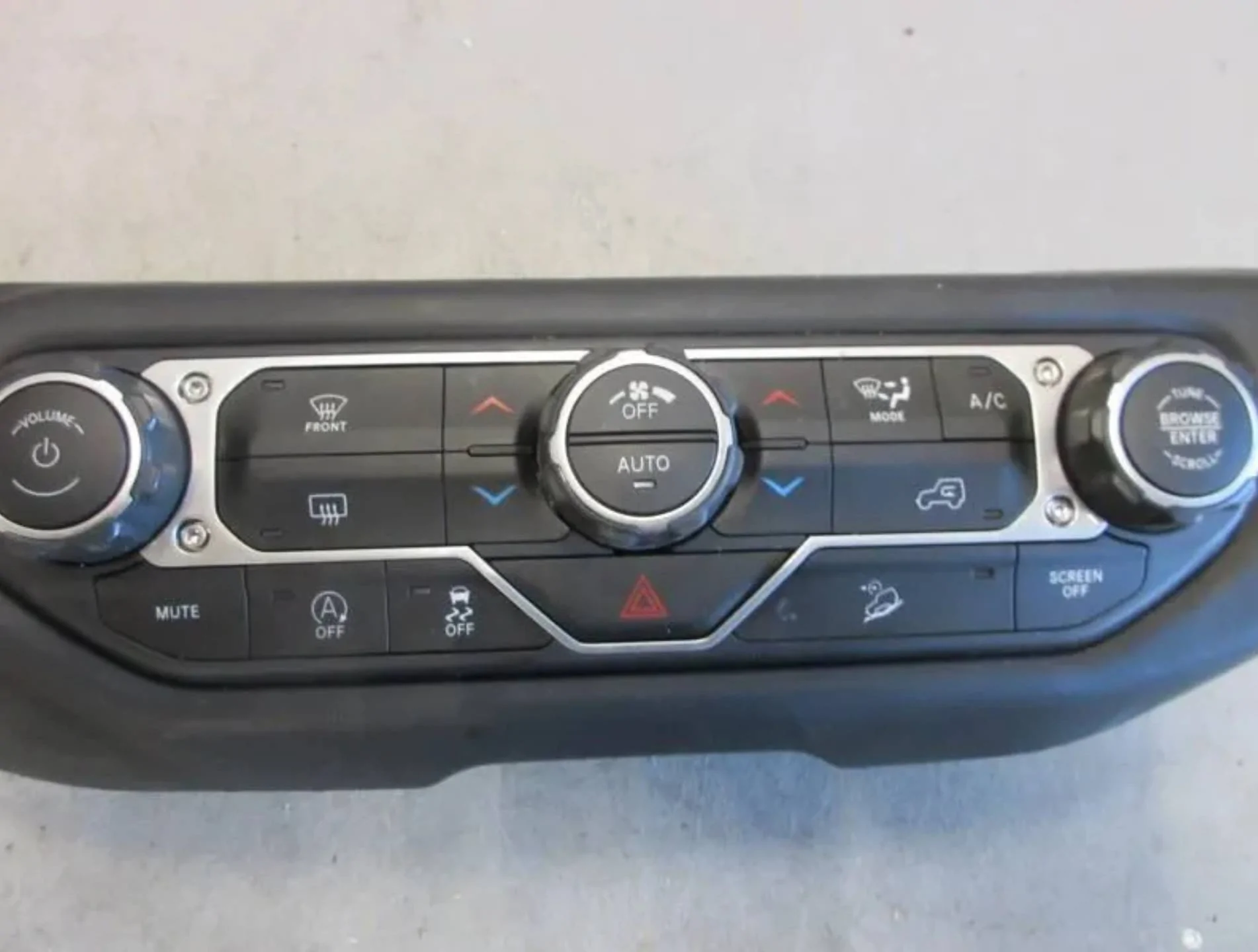

I know this is a late reply but did you ever get this working? My vehicle was Prewired for both sensors. The Cabin and the sunscreen due to already having automatic headlights. I just want to be able to see the temps on my 7" screen instead of just Red to Blue. I bought both sensors. Once I install them what do I need to do in Jscan?
My guess is just go to Adaption> Miscellaneous>HVAC Config and change Single Zone MTC to Single Zone ATC and thats it? or is there more I need to do? I obviously wont have Dual Zone because I dont have the needed dampers or the Dual Zone HVAC Control Panel.
Here is my current HVAC Controls
Unfortunately no, I'm able to get full hot or full cold, no in between temps. I will have to go back to my previous setup and just use steering wheel for volume control and no screen access to control the climate :(
oh :(
The control setup you see in that picture is my factory set up. I had the volume knob from the get go and and do have in-between temps on my screen. But is just goes red to blue. Won't show temps because I dont have the cabin temp reader installed yet but my car is pre wired for it. My AC adjust on my screen not on the knob like the more basic models have. So maybe ill be ok?
Hopefully.
I had the basic setup but was wired for the 4 wire dash sensor and the fan driven sensor down to the right side of the steering wheel. I then added the same HVAC panel as the one you show in your post along w/ the 4 wire dash sensor and the fan driven sensor. I've tried all the combos available on JSCAN but still can't get a gradual temp adjustment, it's either scorching or freezing :(
