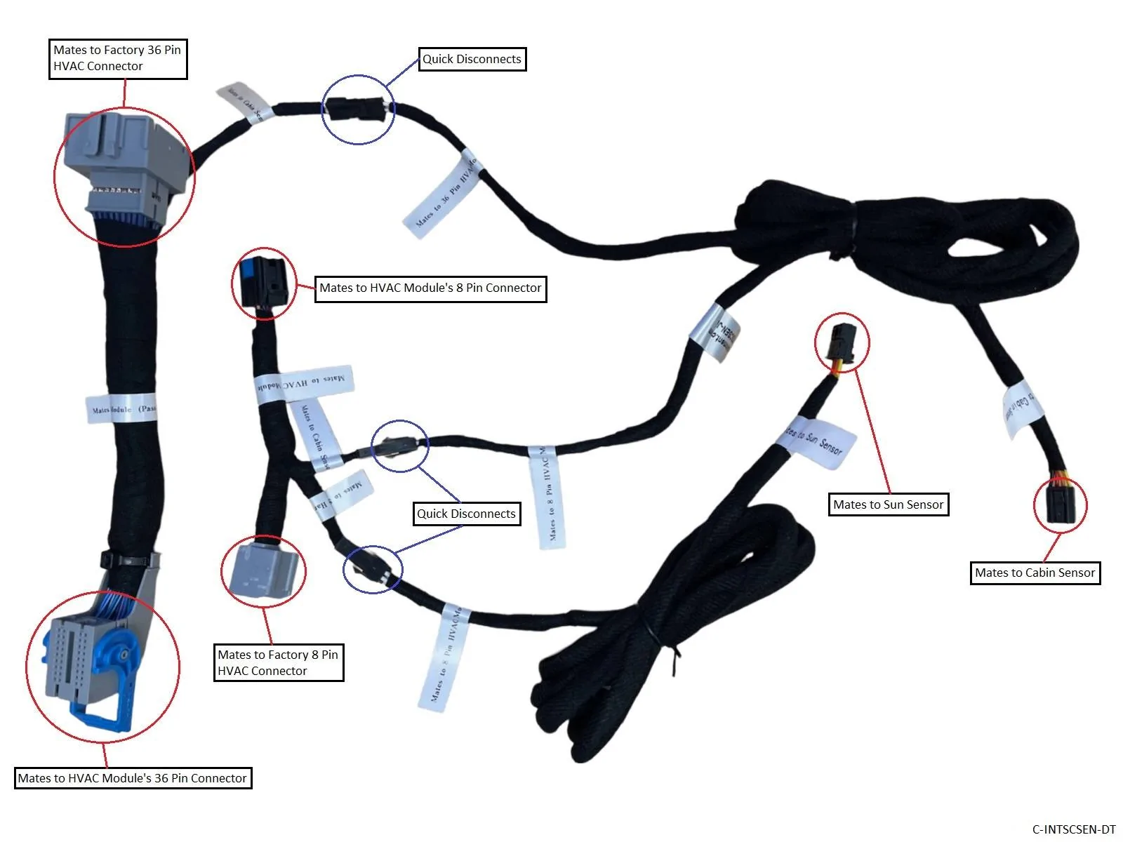

Yup that's it. Works great! Hope it helps with your projects and anyone that needs this plug and play harness for adding cabin and/or sun sensors to their JL, JT, and DT.

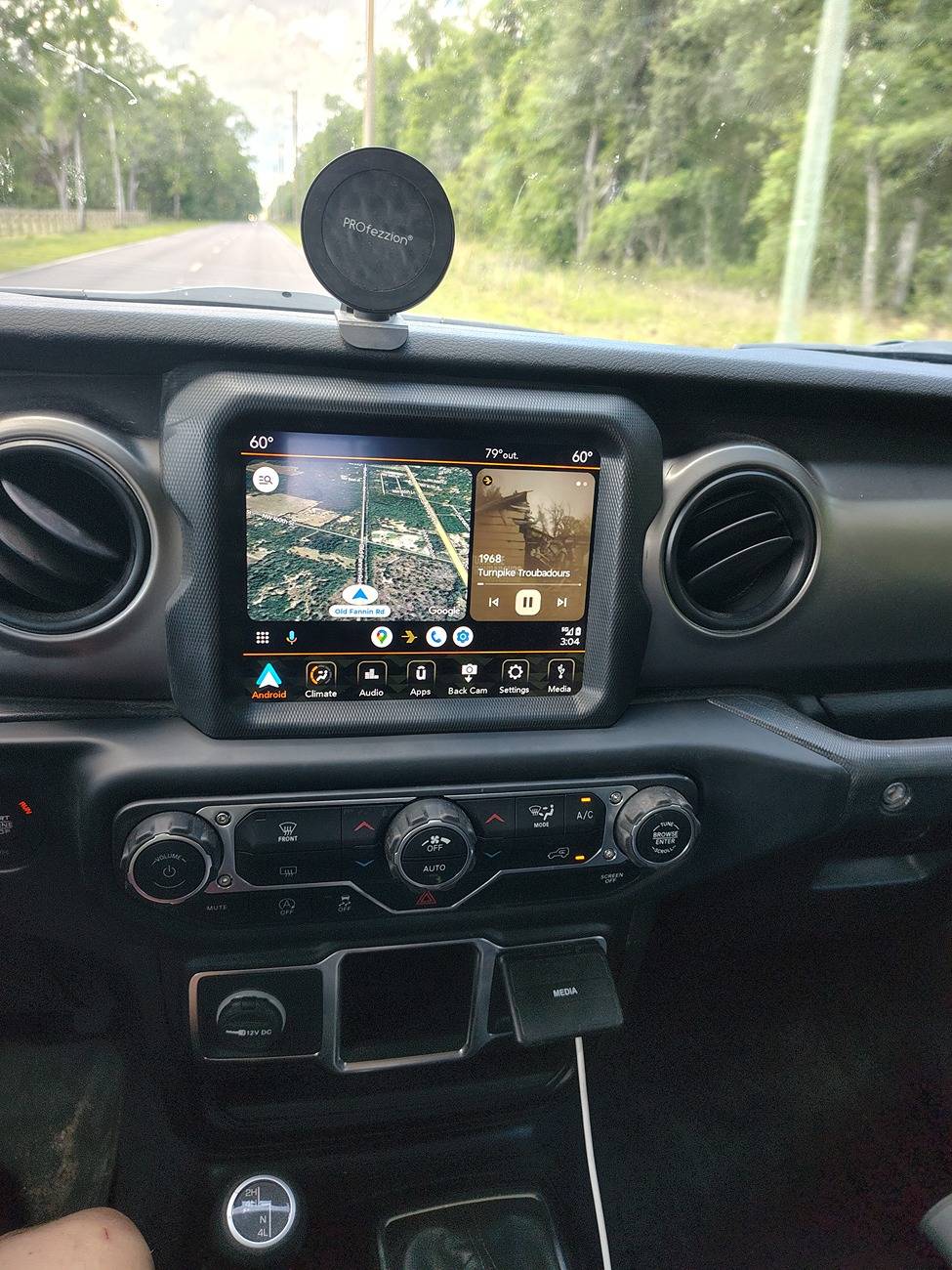

I'm still getting things worked out. I've turned on dual mode in Tazer Mini.
This brought the AC to life, but I can't adjust temps yet. Fan speed works.
And it is set to high heat, but it seems to be blowing cold.

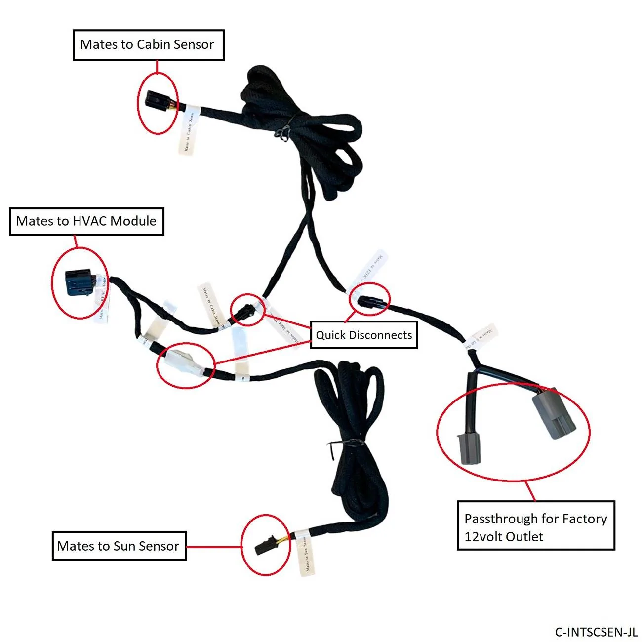

I just received this harness yesterday, but Iām sort of dumb to some of this stuff. Are you able to point me in the right direction for where I find the connections that already exist in my ā21 Willys Sport? Specifically the pass through to 12v and the HVAC module? For example, does the HVAC module plug just replace the ones that is currently in the control unit i installed or does that mate to another location?This may be helpful to those that aren't able to make the wiring for cabin and sun sensor additions. I've made a plug and play harness to add cabin and sun sensor to Wranglers and Gladiator. It is used to add a Sun sensor and a Cabin sensor to those Wranglers and Gladiators that are upgrading to auto climate HVAC controls.
Click here to see the harness. This harness attached to the HVAC Module and taps into the 12v outlet for power.
I have another upgraded version of this harness that will be plug and play right to the two connections on the HVAC Module.
