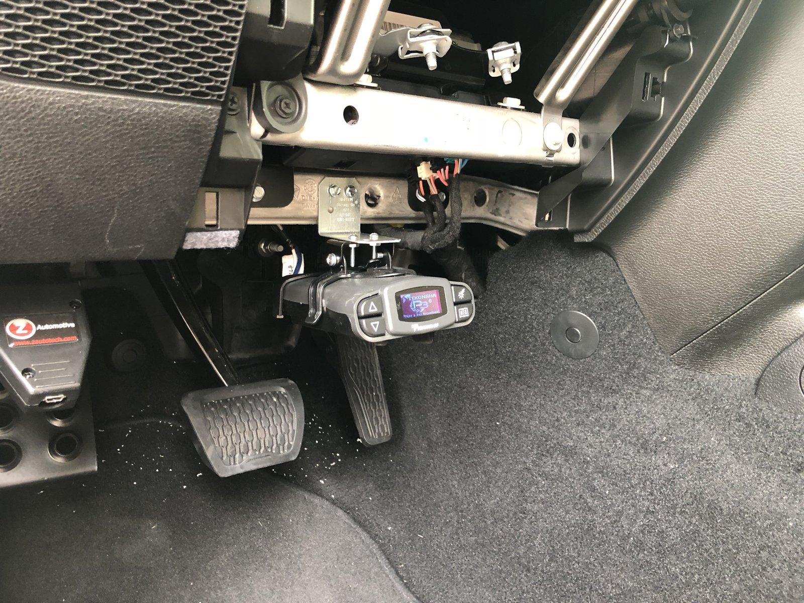

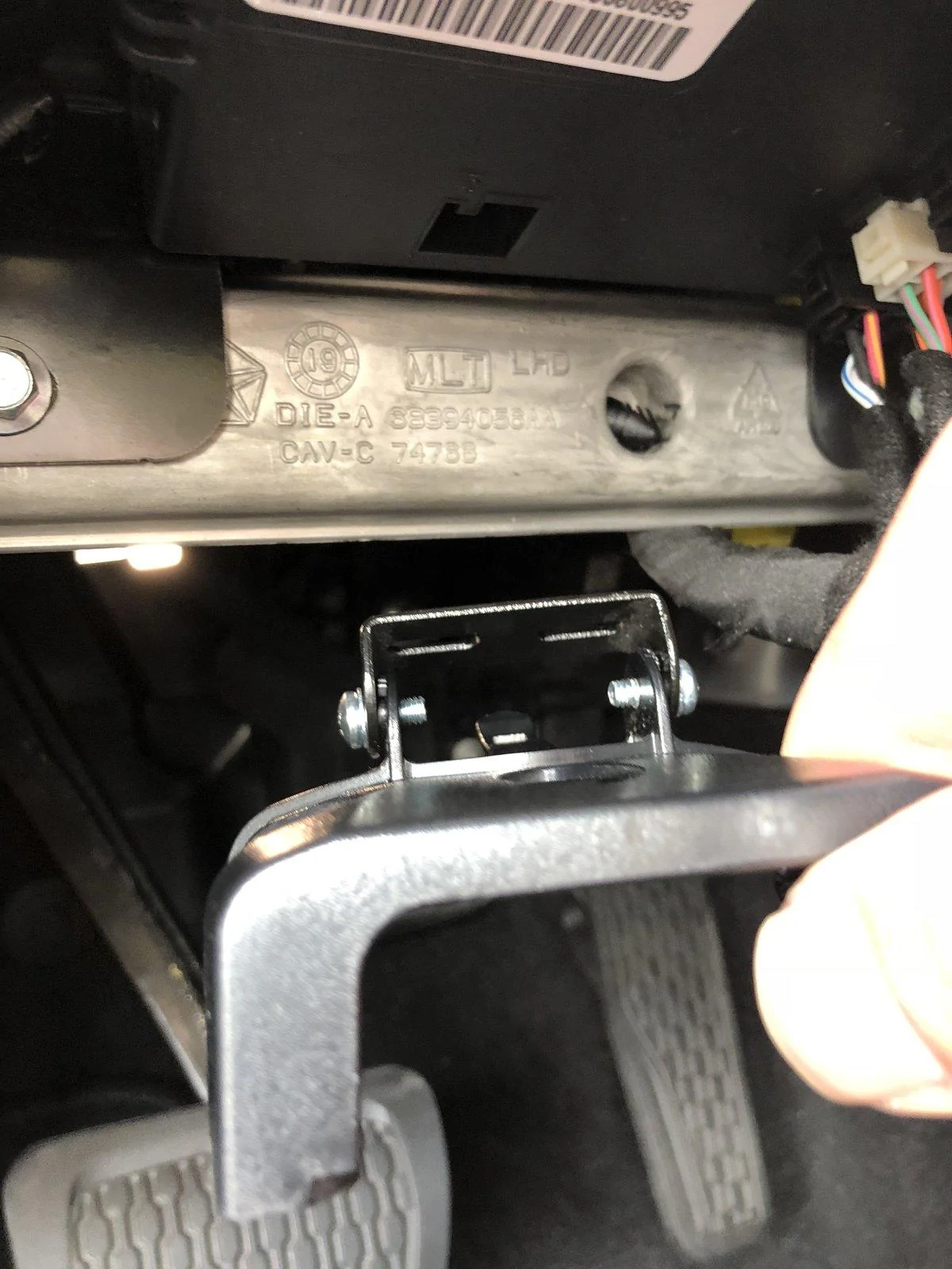

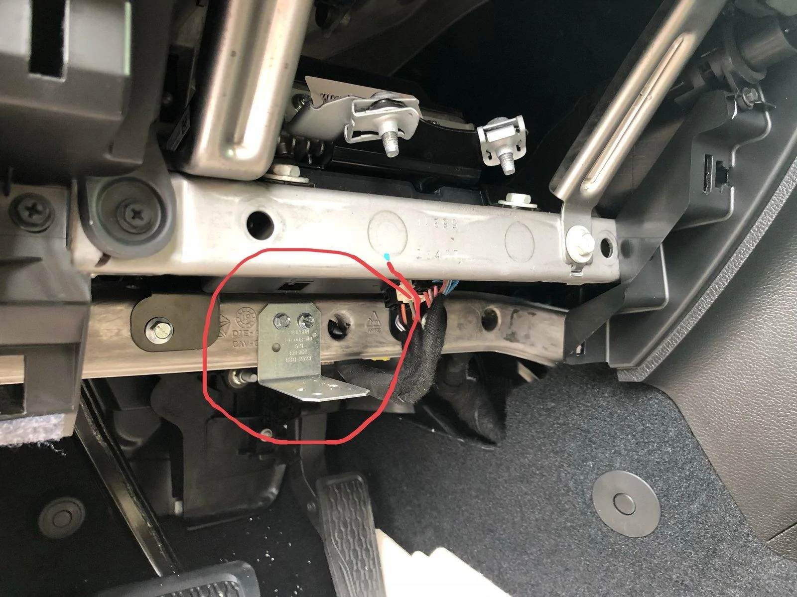

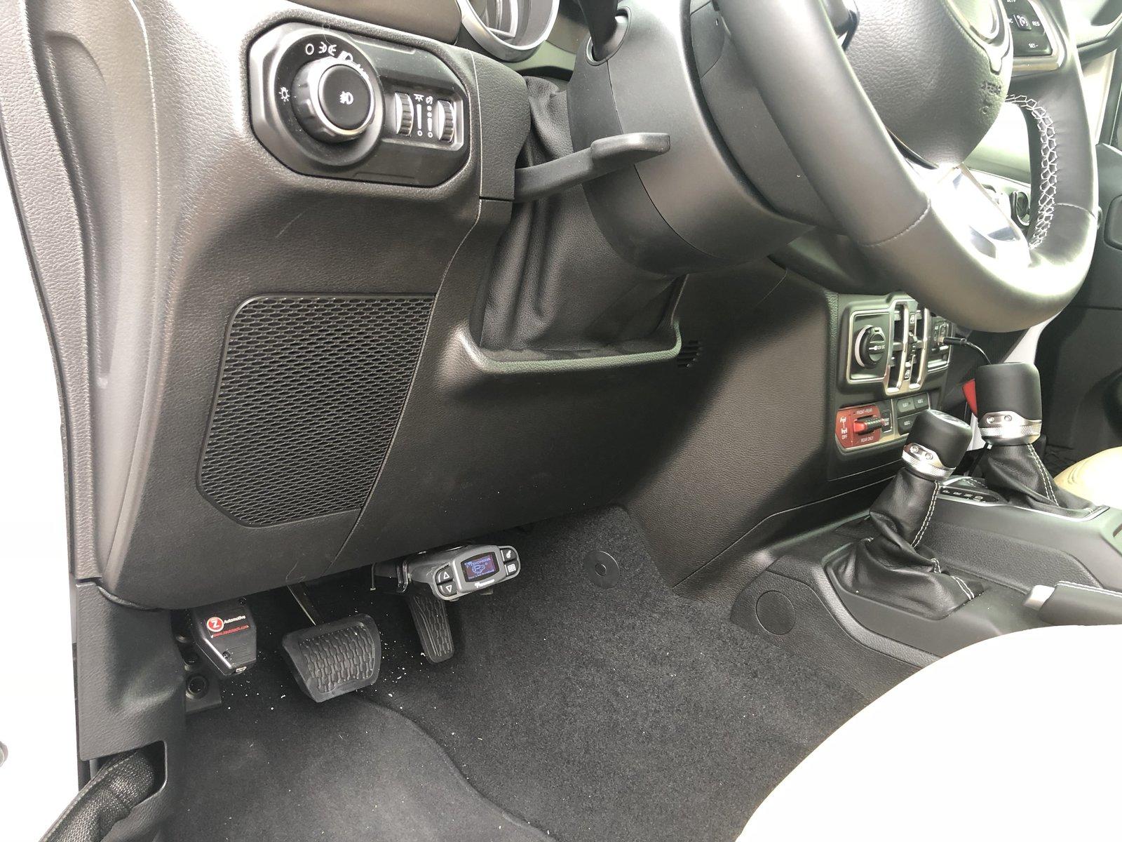

One annoying piece of my JL that my WK2 didn’t annoy me with is a good spot to mount my brake controller for my pop up with electric brakes.
Decided to use a 70 cent angle bracket from Home Depot and make my own.
Drilled a couple extra holes on the bracket, drilled two small holes in the metal under the steering wheel, and used a couple small machine screws with nuts to attach the controller to the bracket. Works great now and comes nowhere near my legs so I don’t accidentally bump it etc.

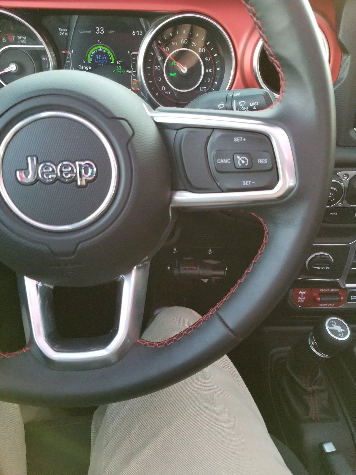

I mounted my permanent position of my brake controller last night. I put it where I can see it when driving and where I have quick access to pulling the manual brake if I need to.
This is my exact view when driving...
