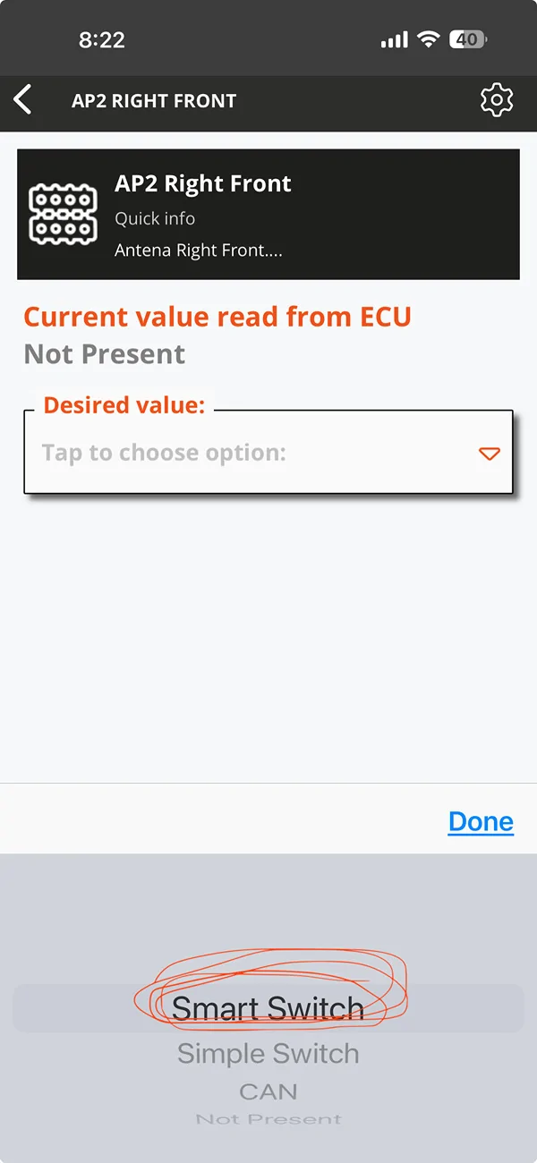

Just added the passive entry to my JLUR 2022 here in India. Thanks to @AllMoparParts.com Benny for hooking me up with the single side system. Since mine was a RHD vehicle it was confusing in the beginning as to which part to order as I just wanted the driver side.
Just ordered the regular LHD driver side part and my buddy installed it.
So here in India the JLUR already had the wiring built in and the connector taped off near the door handle. We realised this while installing. So we used the same wiring already present and just changed out the Door handle and connected the taped off socket into the door handle.

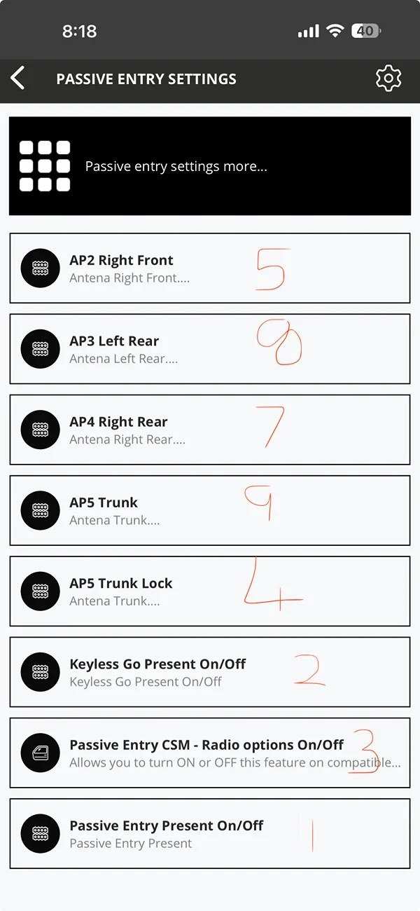

Then I used JSCAN to programme it and it works like a charm.
So for anyine using JSCAN the steps are:
1) Connect the SWG bypass and the dongle and start JSCAN.
2) Go to Adaptations and Passive entry
3) Turn Passive entry ON
4) Turn Keyless Go ON
5) Then start from Trunk lock ON, Then i went to the doors starting from my drivers side which is RHD and then front left and then rear doors.
So when you go to switch them On/Activate it shows Smart switch/Simple switch/ CAN/ Not present. Select smart switch.
Disconnected JScan and MAGIC everything worked.
