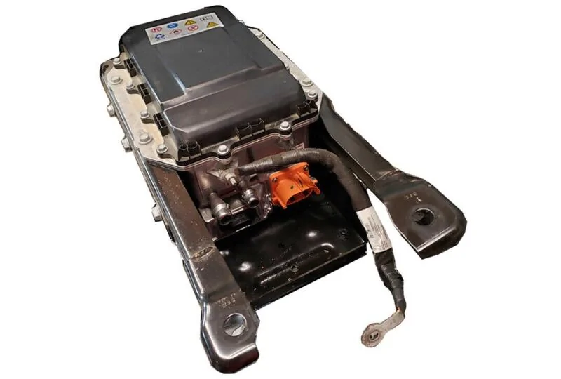

Isn't the OEM 48V AGM? If so, the charging / maintaining algorithm would need to be changed.
Afaik, the battery pack under the vehicle is a 48V lithium and the one under the hood is a single 12V AGM. Can't figure out the rated capacity.
Wow, just found a new "con", lol. The replacement OEM 48V battery (68381513AA) is $2,050 for a new unit. However, the going price for a used one is under $700, though buying an old, used lithium battery seems like a gamble in itself.
But the big "pro" here is that it really doesn't matter at all if you bought a brand-new Wrangler v6 eTorque and trade it in before the 8-year EV/hybrid portion of your warranty expires, right? 😏
https://store.mopar.com/oem-parts/mopar-power-pack-unit-battery-kit-68381513aa
I haven't seen knock off/refurbished etorque batteries but I know my buddy got one for his early mild hybrid escape for $600 when Ford wanted $3k for a new one. Hopefully as the early etorques get past the warranty period the aftermarket steps in.
