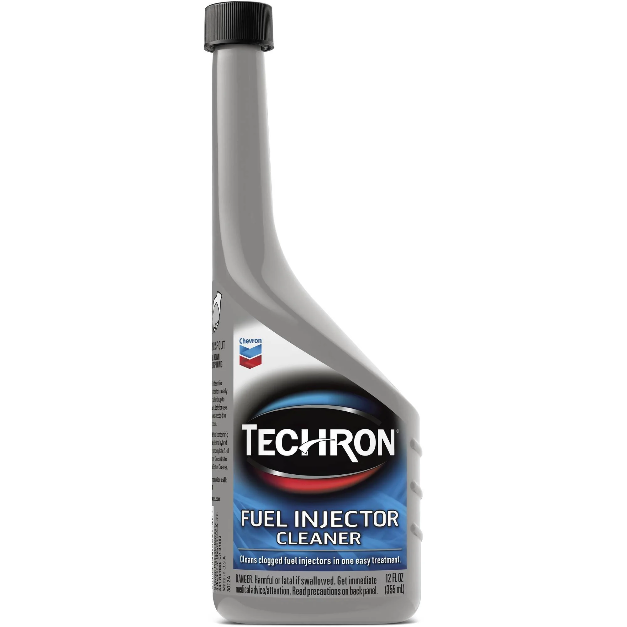

87 Octane is all that is needed. As for additives, of which I have never been a big fan of. But, every 5000K, I do add a bottle of Chevron Techron to my gas tank. I feel that it helps to keep the Fuel Injector Nozzles clean.

Chevron 87 with Techron has never let us down. JL or otherwise. Always is our first choice. No ping. No knock. Never had reason to use anything else.
Chevron high test is excellent if you have a vehicle that calls for 92 and up. Ethanol free. Quality fuel for very high performance engines. Chevron diesel is also an excellent fuel.
We use all 3. We recommend all 3.
