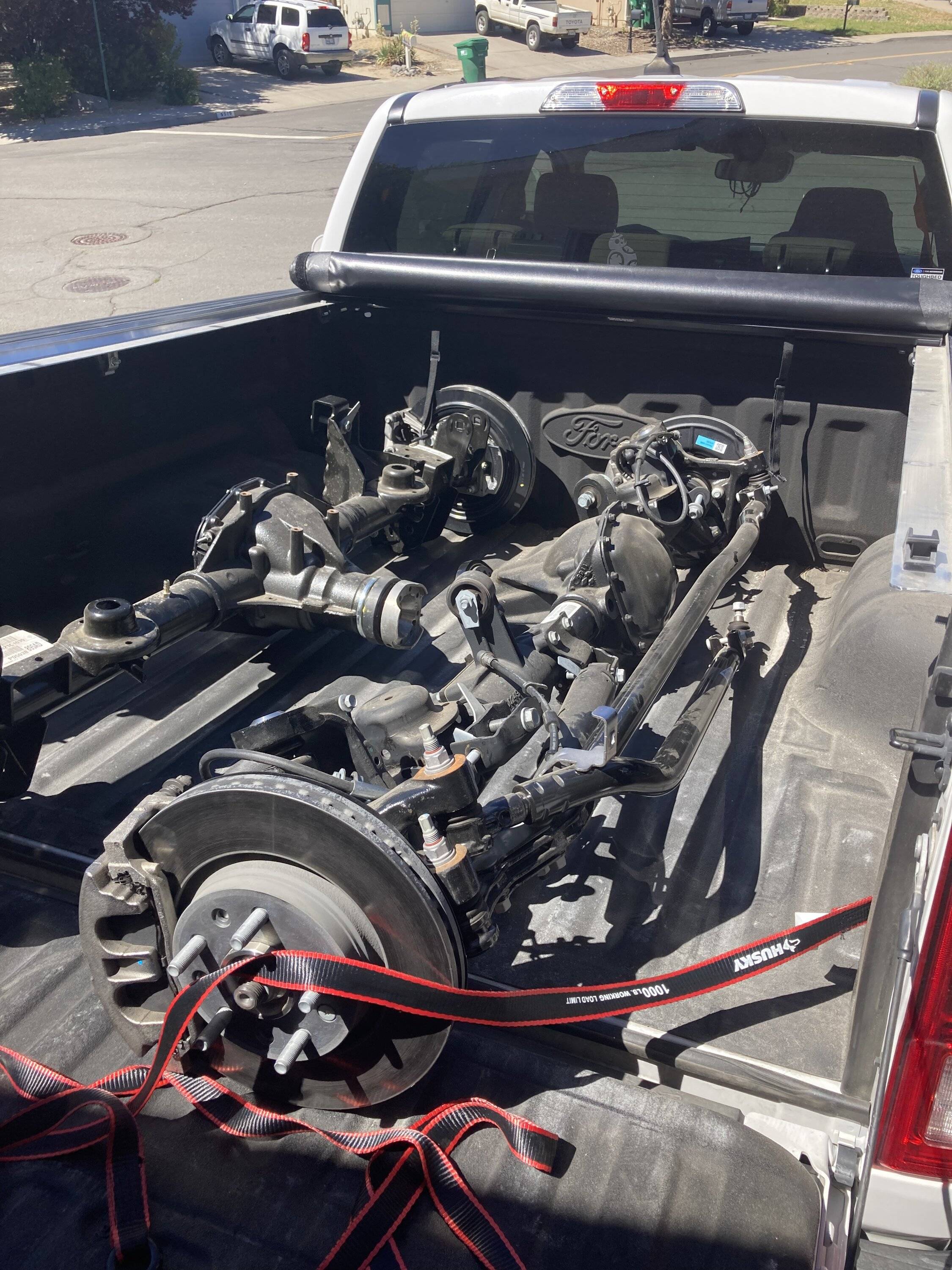

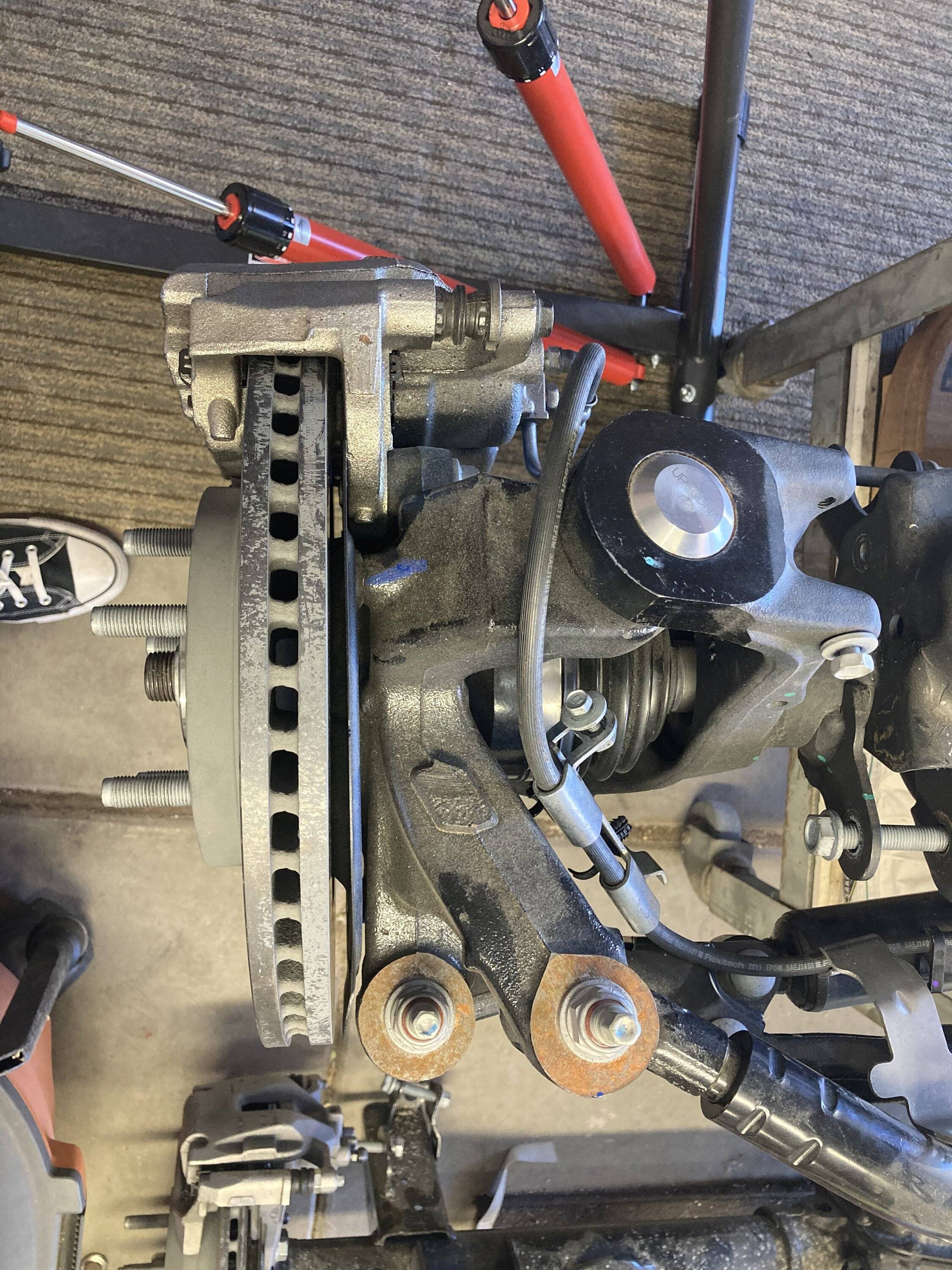

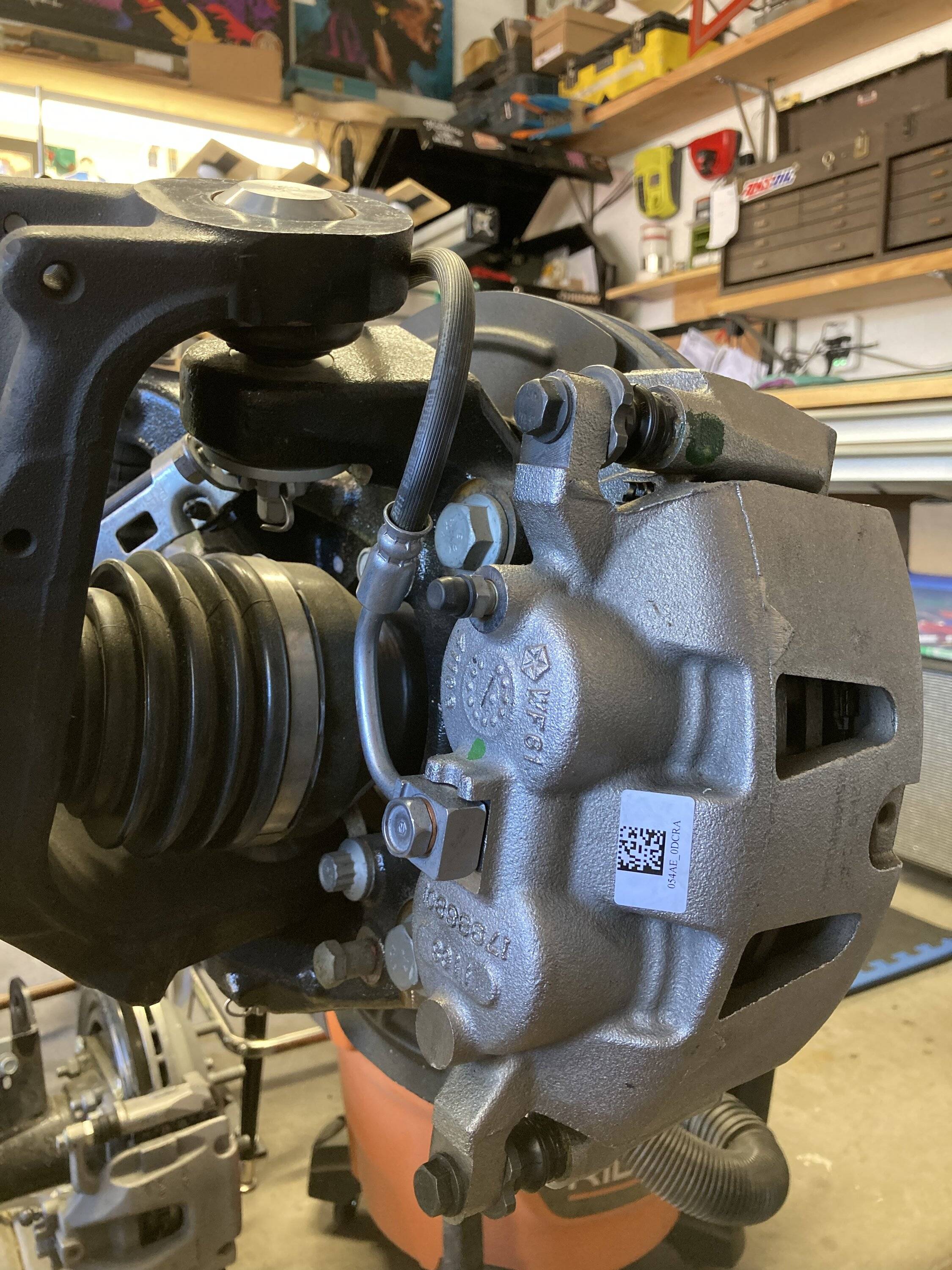

Just got a set of 392 takeoffs with 80 miles on them and I tell you what these things are gnarly! Beefy indeed!
I knew most of the upgrades these have when compared to stock Rubicon Axles but I didn’t realize these have CV joints!

Nice. You got the brakes and everything..

Wonder how those CV boots will survive long term...

TBH I've never seen the RCV in person so hard for me to say.
I am betting they are not and are just regular CV boots which are not very durable. The RCV boots are about 1/8" thick and are pretty tough. Unfortunately, the RCV boots will not fit the Mopar axles, so you are stuck with them.
If not doing any serious rock crawling, it will probably be fine, but is something to monitor so that you do not have a failed joint due to lack of lubrication.

Do you know if they need to be lubricated like the RCV's? Around every oil change or tire rotation

No; I am almost positive they are "sealed" and need no lube. The RCVs (which is one of their shortcomings IMHO) sling grease as part of normal operation and is the primary reason they have to be lubed periodically.
I had a set and the shop tore the boots on installation. I pulled them to replace the boots and never reinstalled them (just sold them). I will be going to the Dana CrMo axles for the front next winter(during downtime).

Cool thanks again for the info. I will ride these for as long as I can then switch to a CrMo set at some point
