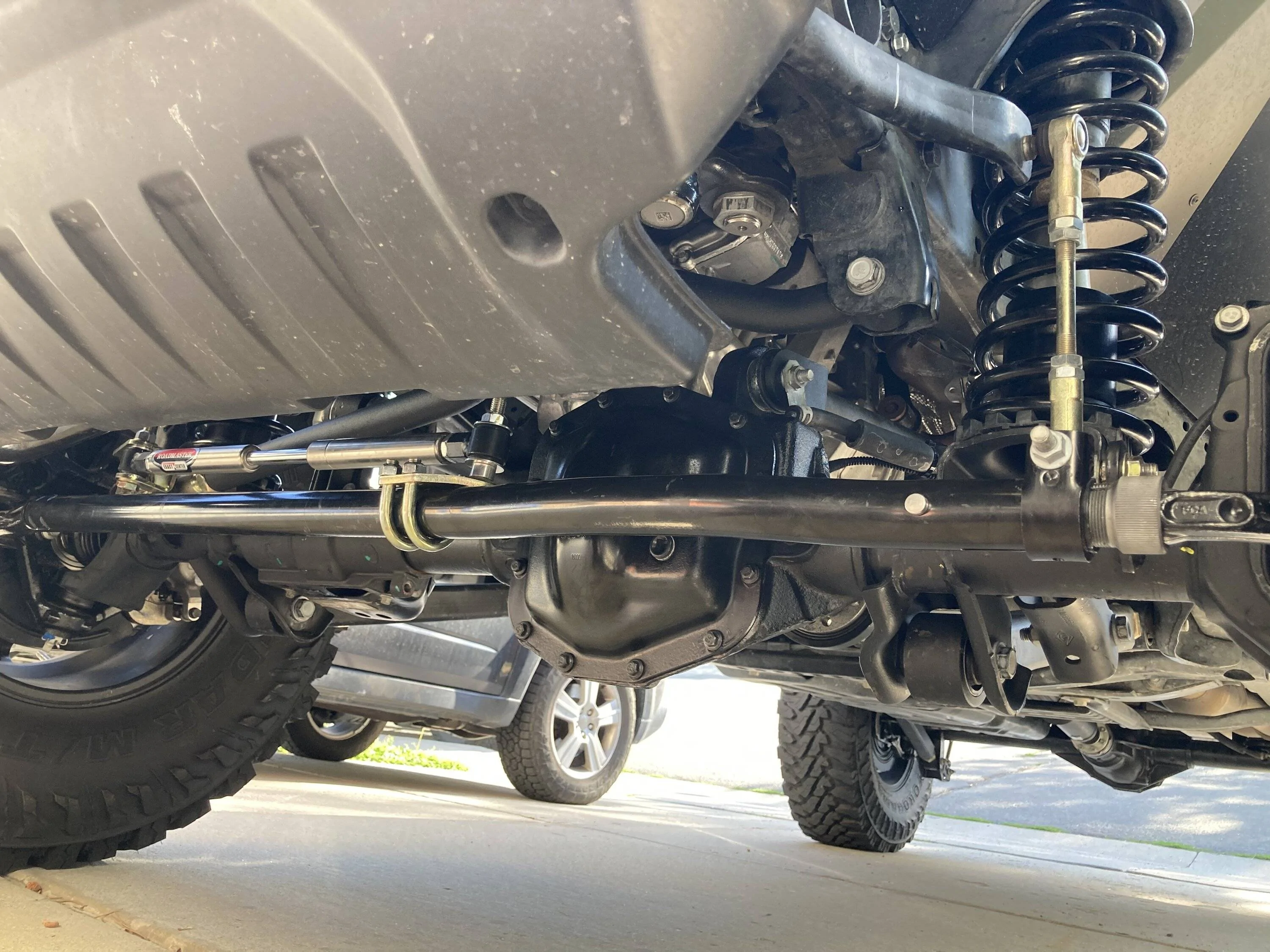

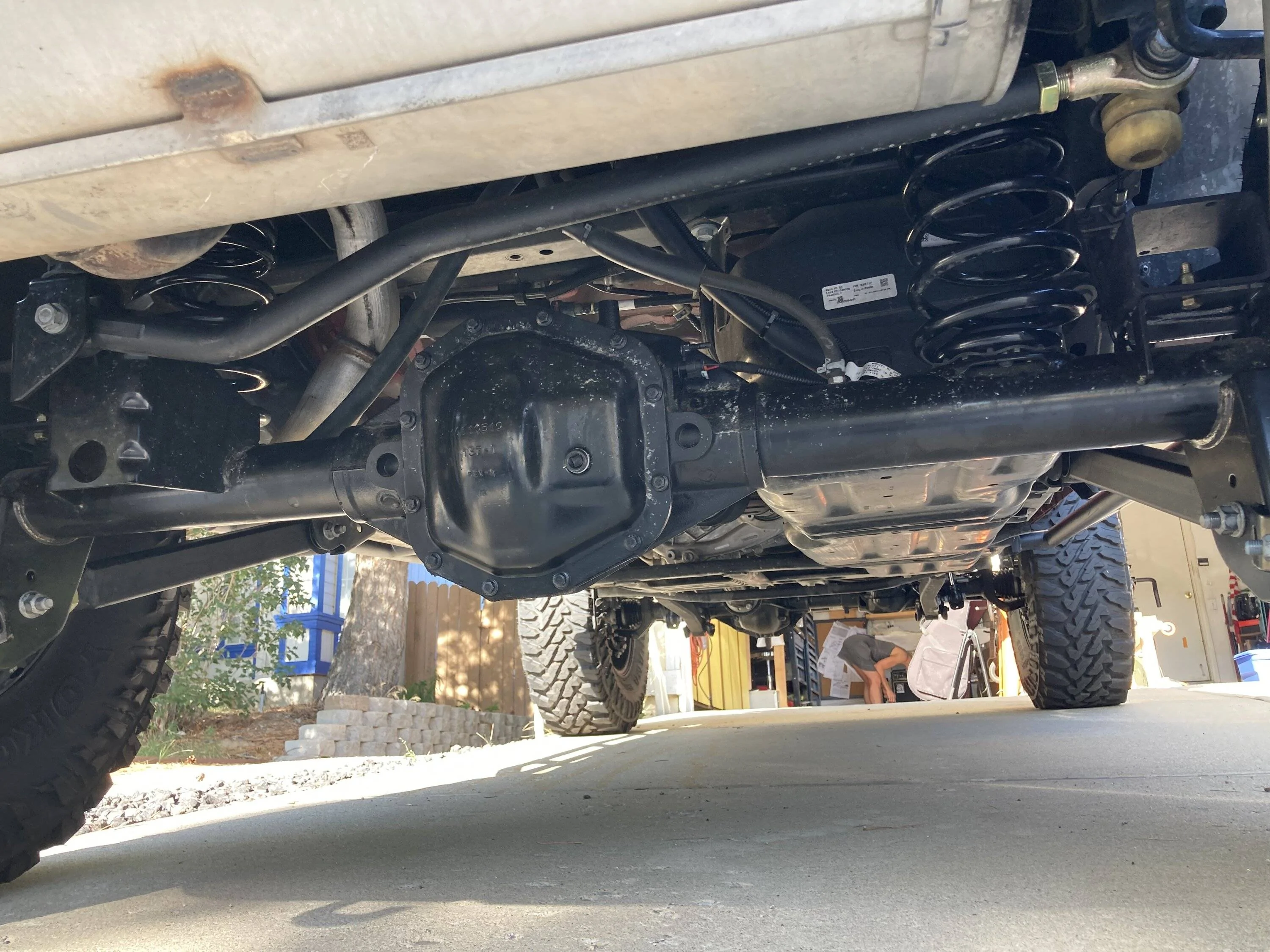

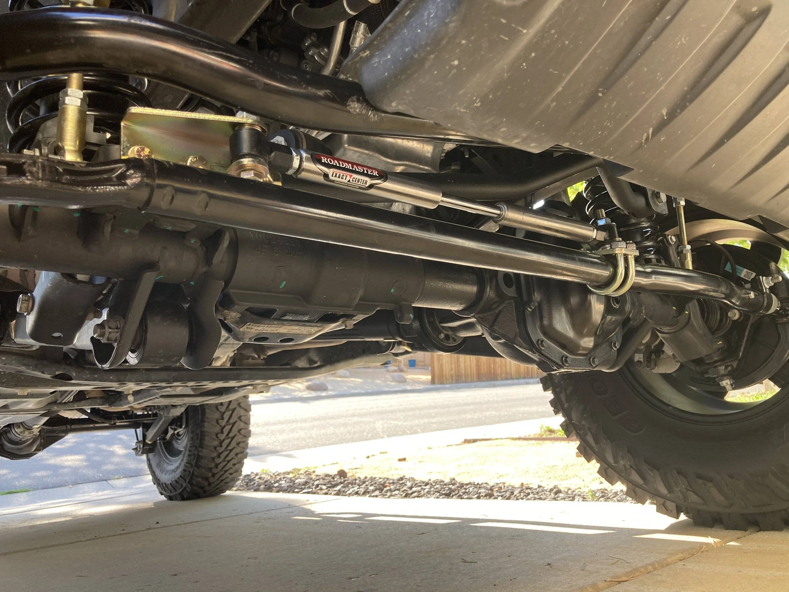

I just installed a 392 front axle into a JLU Sahara. The front pinion flange is thicker with a recessed thread, so you'll need the longer front yolk bolts from a 392. The front drive line worked great. It still has a good amount of compression at full bump.

Nice!! Looking to pick up a set of 392's for my 2018 jlus. A few questions.. The tazer will fix the gears and lockers. What did you do to remove the serv 4wd? My PLAN is that I will remove the fad solenoid out of my sport axle, plug it back into the connector to the transfer case wiring, wrap it up and tuck it away somewhere? Anything else I may be obviously missing?

The Tazer did allow me to adjust all those parameters, although when I had them installed I had the Lasfit switch bank installed at the same time as well as having them regeared to 4.88. The only thing we ran into was needing longer bolts for where the axle meet the driveshaft, I think the flange was longer or larger on the 392 axle. Other than that it was a pretty straightforward swap.
As far as the FAD goes they left it off when we swapped to the 392’s. And I’m not sure about the serv 4wd. Hopefully that helps you out, the only other thing of note was as far as I’ve gathered it’s almost impossible to use the factory locker switches from a Rubicon on a Sport, I can’t find anyone who was able to do it and I didn’t have the time or money to try to get it to work so I went with an aftermarket option in Lasfit.
If you’ve any other questions I’d be happy to try to help.

you just use a Tazer and set it to no FAD. No need for the solenoid, just wrap up the wiring and call it good.
