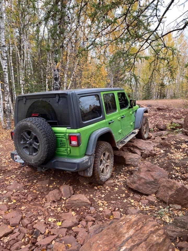

Any other advice people have or have experienced would be greatly appreciated. Photo for example of local trails.
