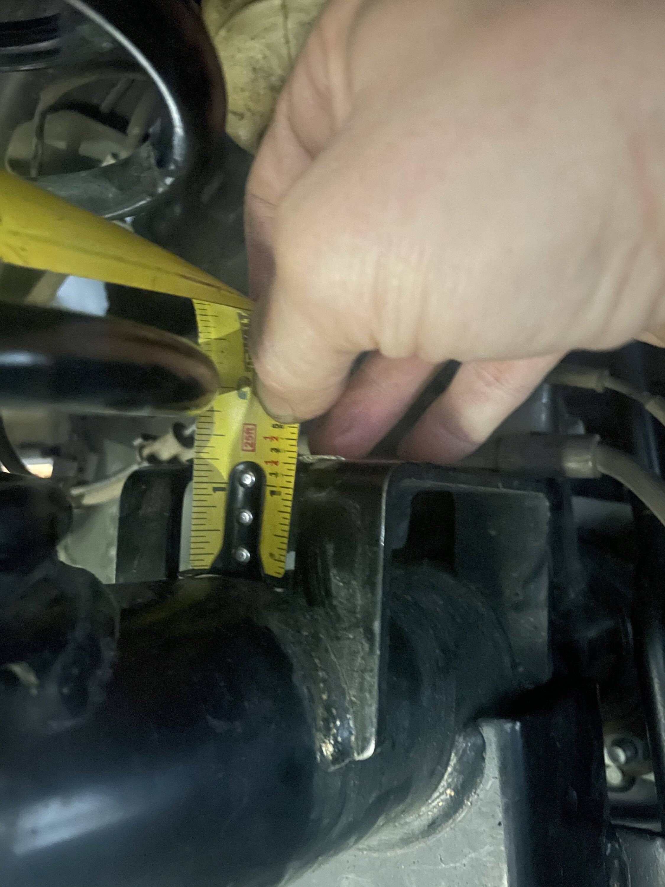

The 392 uses the Gladiator Mojave front axles with the thicker tubes and cast iron knuckles. The rear axle has thicker axle tubes and modified suspension hard points.

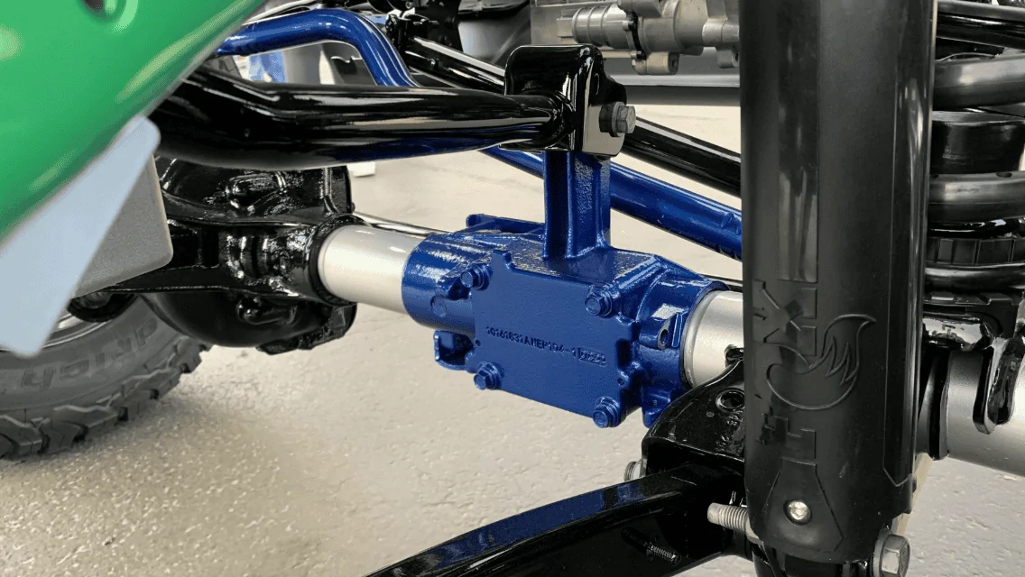

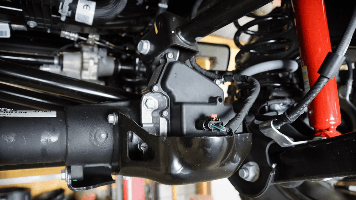

Also removed FAD from the front axle on 392’s to improve strength

Thanks for replies. I just found a thread that covers the 392 front axle pretty well and agrees with info being posted here. I hope the Rubicon selectable FAD can swap into the 392 auto FAD housing. Looking forward to swap threads into non-392's. Cheers
