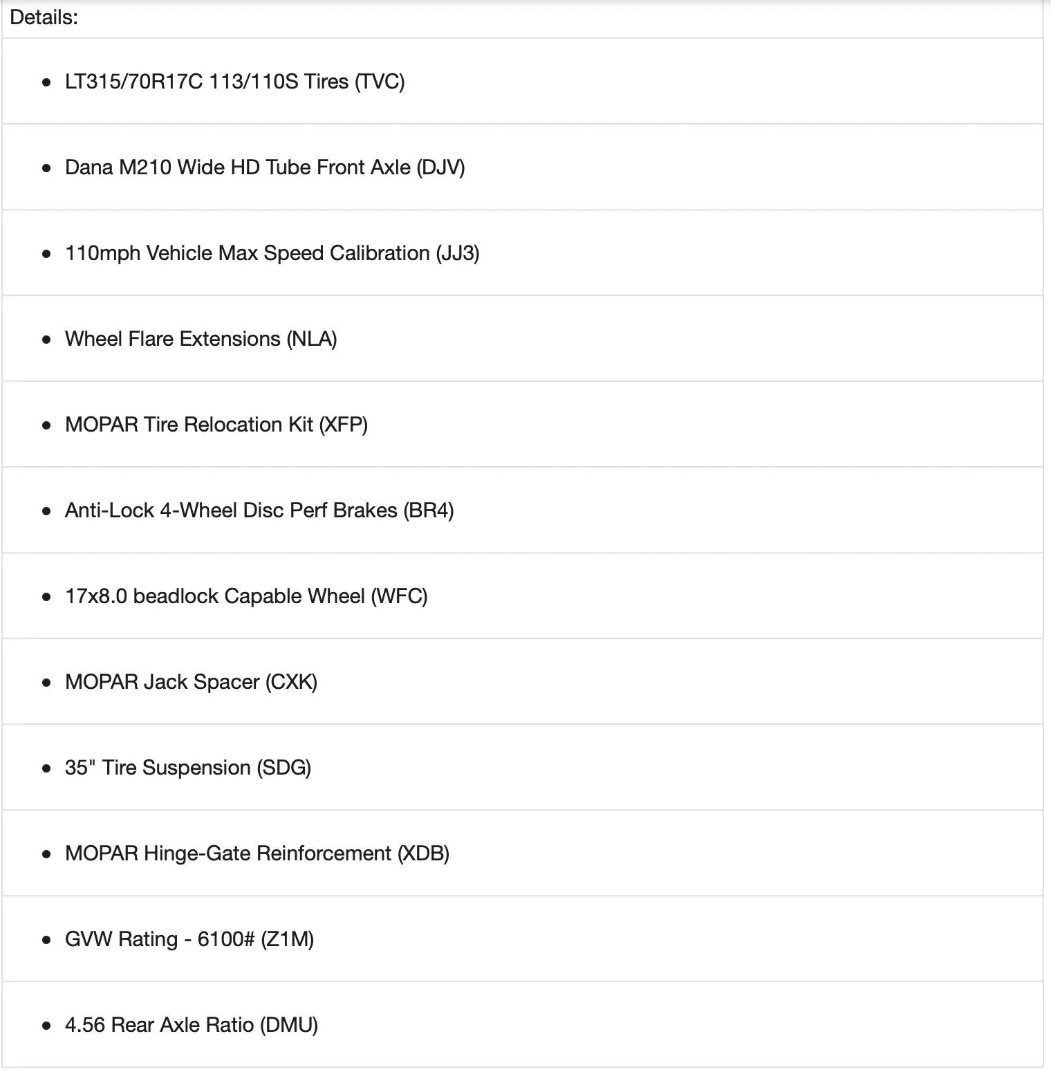

Do you have a link to the differences between the DJV and DJF front axles? The rear axles are the same DRF.
I think what @Stormin’ Moorman might mean what many others have asserted, if you're after 37's or higher, just get the regular Rubicon.
I'll bet we won't see that before 2027. It makes too much sense and the bean counters are risk averse. Unless the Bronco is available with 37s.
It’s been discussed, essentially thicker tubes on the axles, bigger brakes, and iron steering knuckles.

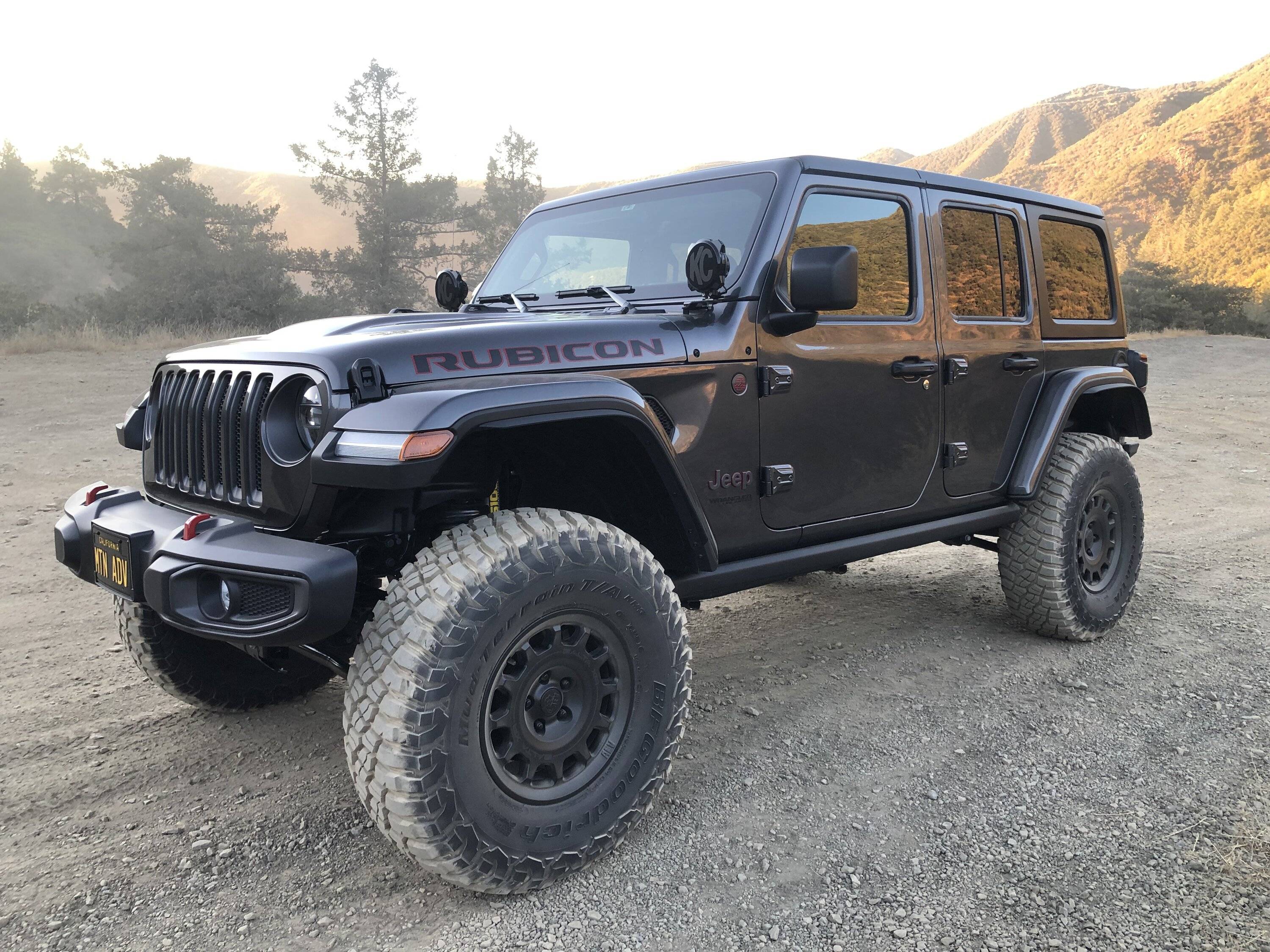

Everyone is different, but it’s got value for a lot of people. I saved money on my rig with the XR and had it on 37s within 2 weeks of taking delivery.

The XR also bumps up the GVW from 5800lbs to 6100lbs.

All it really means is the XR is around 300lbs heavier.

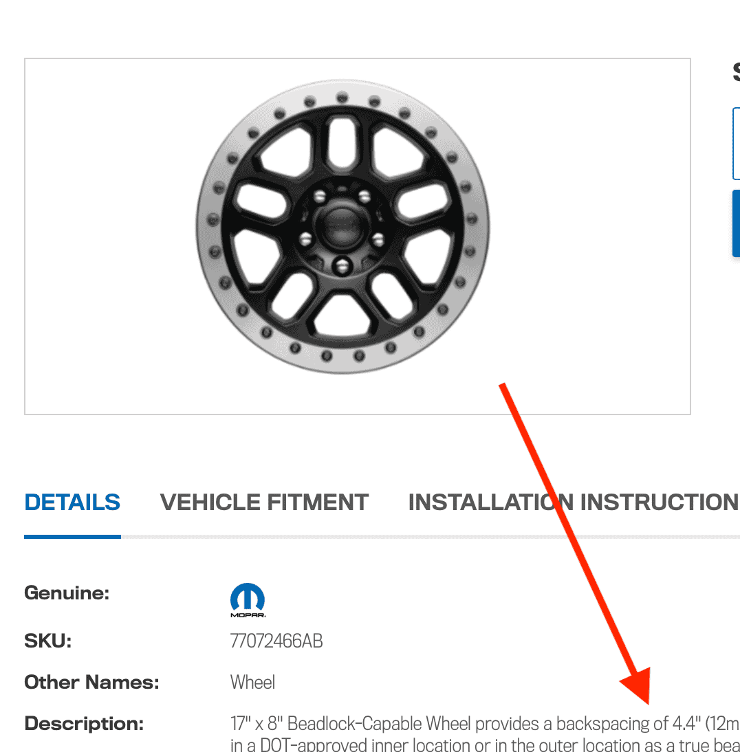

Not sure not the lift, it's one of my questions for the first owner to take delivery as well. If the wheels are the same as the Mopar accessory wheels offered in the aftermarket its 4.4" BS
But that is a mistake. My brother bought these wheels and we measured backspace with a level and backspacing is 5 inches don’t know where they got 4.4.
Roky
Roky
Oct 4, 2018
10,712
29,475
I don’t know why, but Jeep measures backspace to the inside of the bead lip instead of to the outside of the rim, above my pay grade as to why. But whatever Jeep says is the backspace I just been adding a 1/2” to it and noticed that gives me the actual backspace number………
