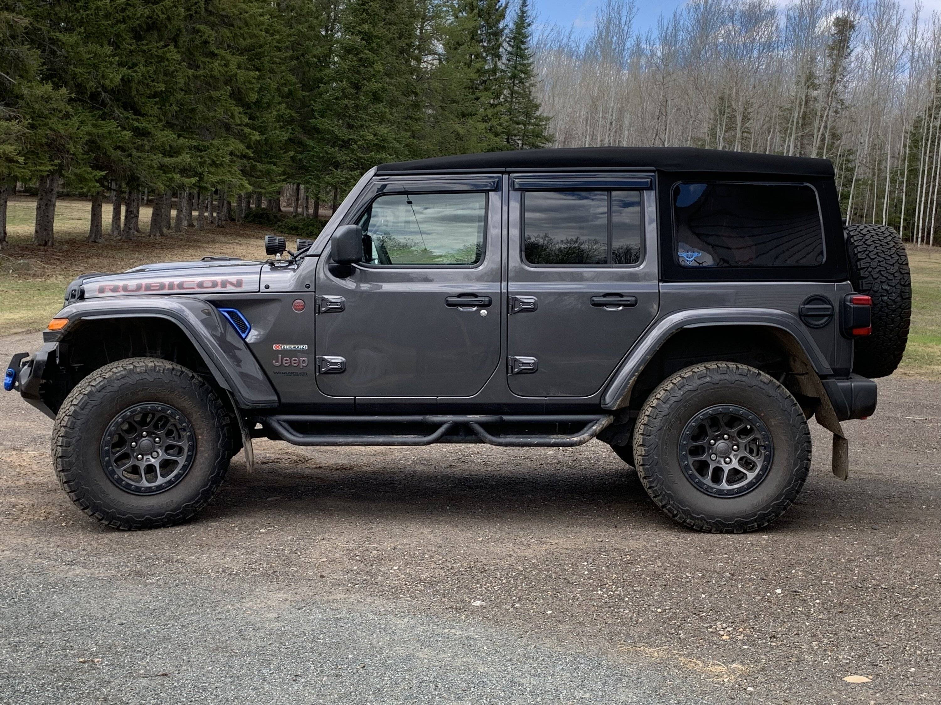

I put 2.5” RK springs in instead of spacers to compensate for bumper and winch. Gave me a bit extra if I choose to go 37s next time. The 35/4.56 is a nice combo.
Did you change anything with the shocks when you changed the springs? Love the way yours sits and have the steel bumper and winch as well
Yes I swapped out shocks as well for Metal Cloak RockSports.

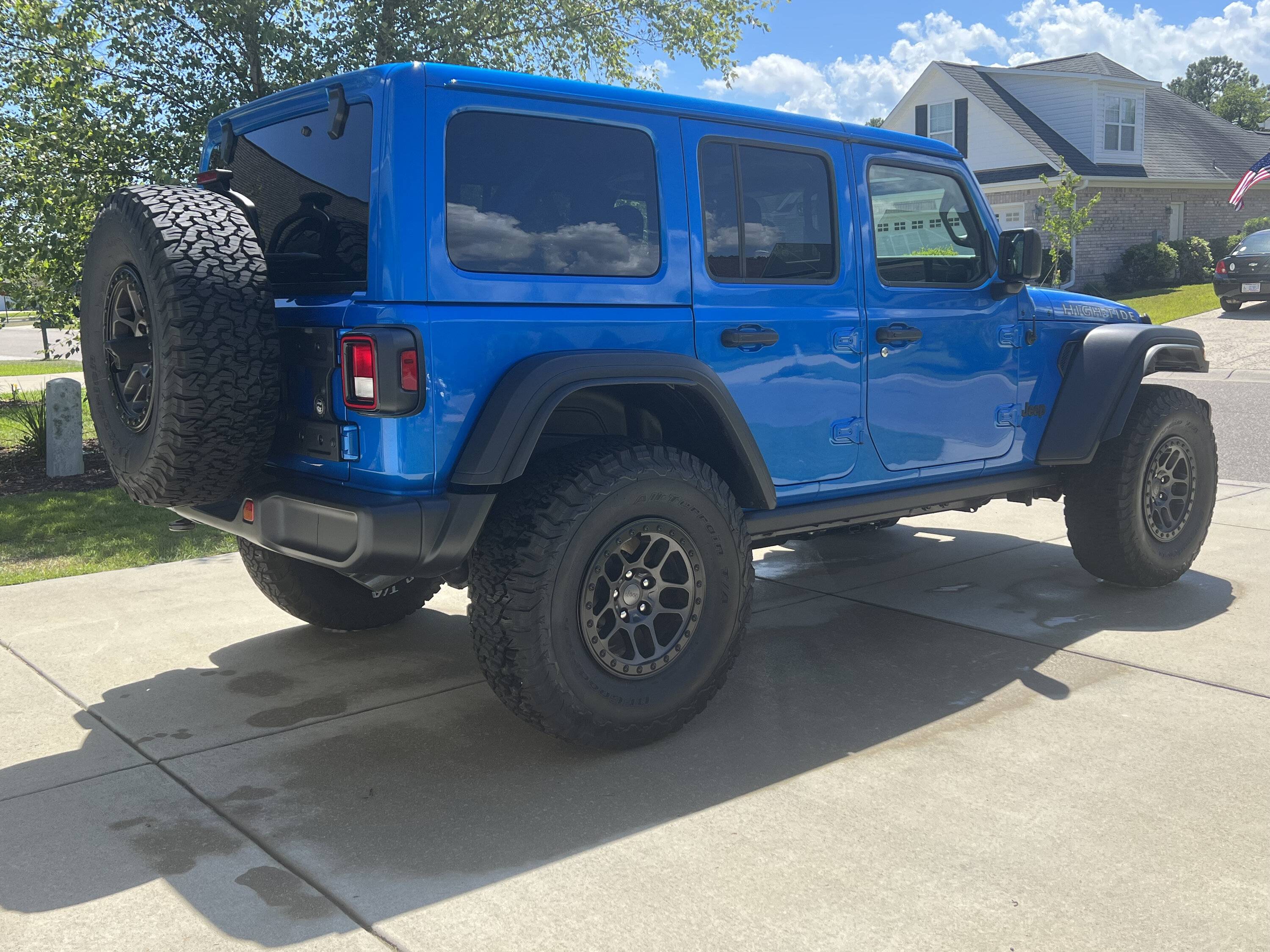

37" BFGs work great on the Extreme Recon package. They sit at 35.5" mounted, the stock 315/70/17s measured just over 34". Had to move the mounts up on the tailgate bracket. The 4.56 gears are perfect for these tires.
Did you change suspension or add lift before throwing the 37s on?
