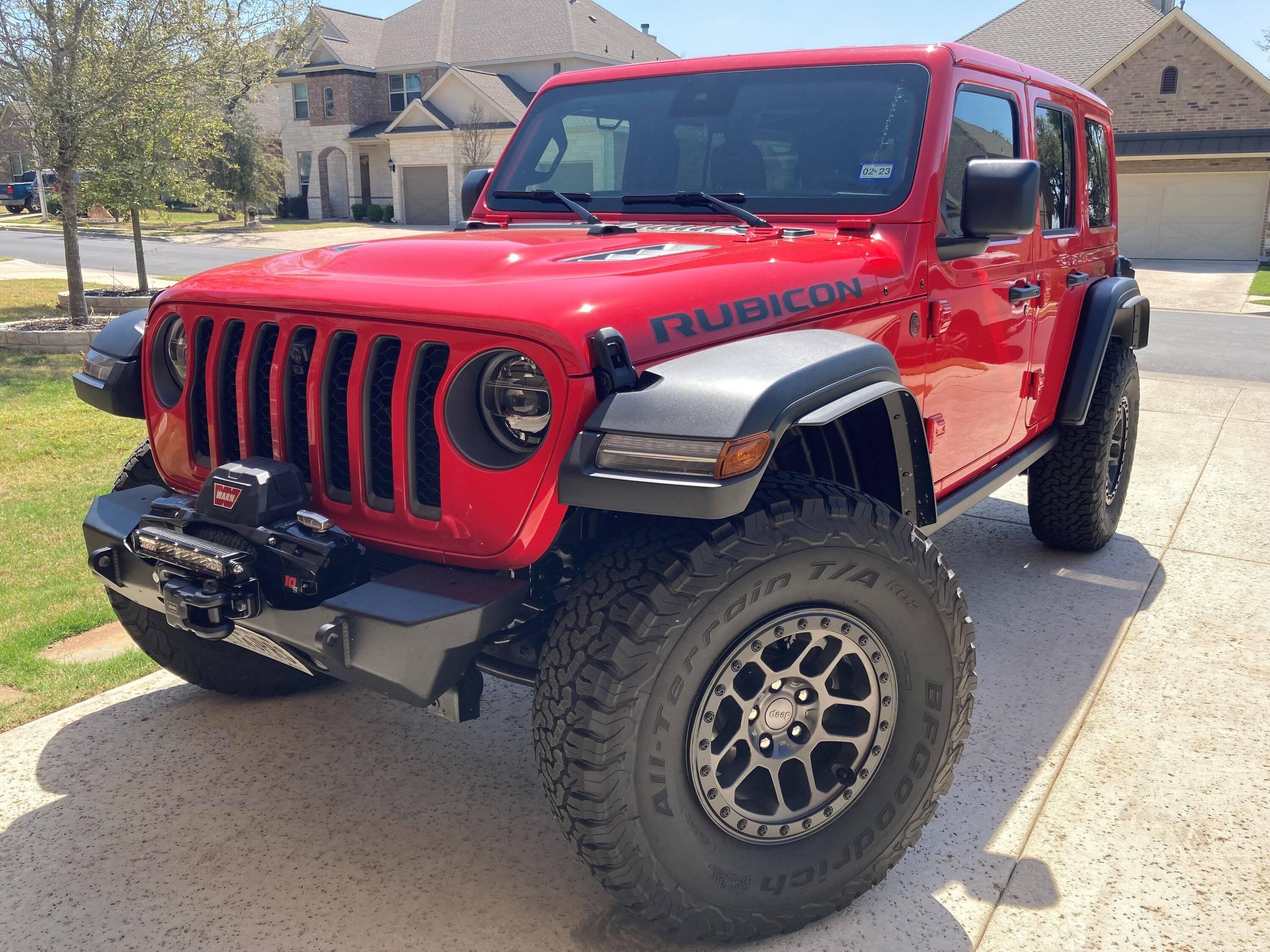

37" BFGs work great on the Extreme Recon package. They sit at 35.5" mounted, the stock 315/70/17s measured just over 34". Had to move the mounts up on the tailgate bracket. The 4.56 gears are perfect for these tires.
