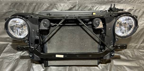

I used common sense.
This is what is behind the grill.
So increasing the width of open airflow will have much less impact than the increase in the restriction of airflow vertically.
The new grill is shorter and even includes another trim piece on the bottom to further block air from going below it and through the radiator. The design of the JL grill is misleading as the outer 2 slats don't really have any substantial airflow going through them. So the only advantage of the new grill vs the old for the middle of the grill where the radiator is mounted is the removal of the 4 bars that separate the middle 5 slats.

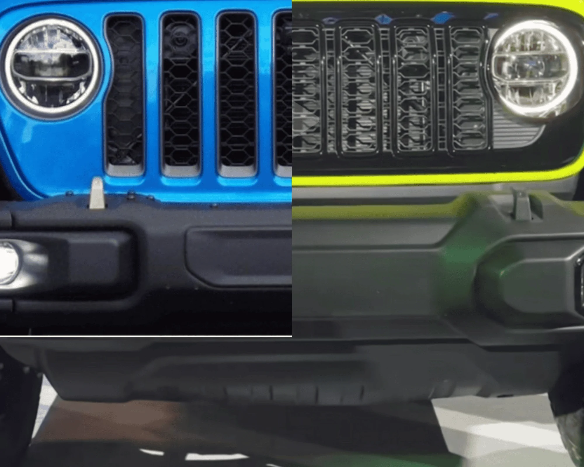

Back when this topic first came up I made this post and rough photoshop attempt with my phone.

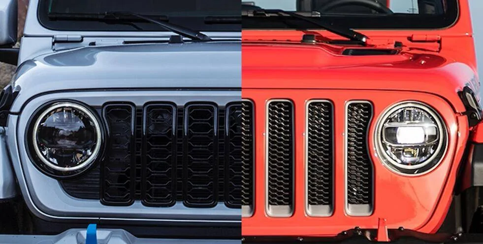

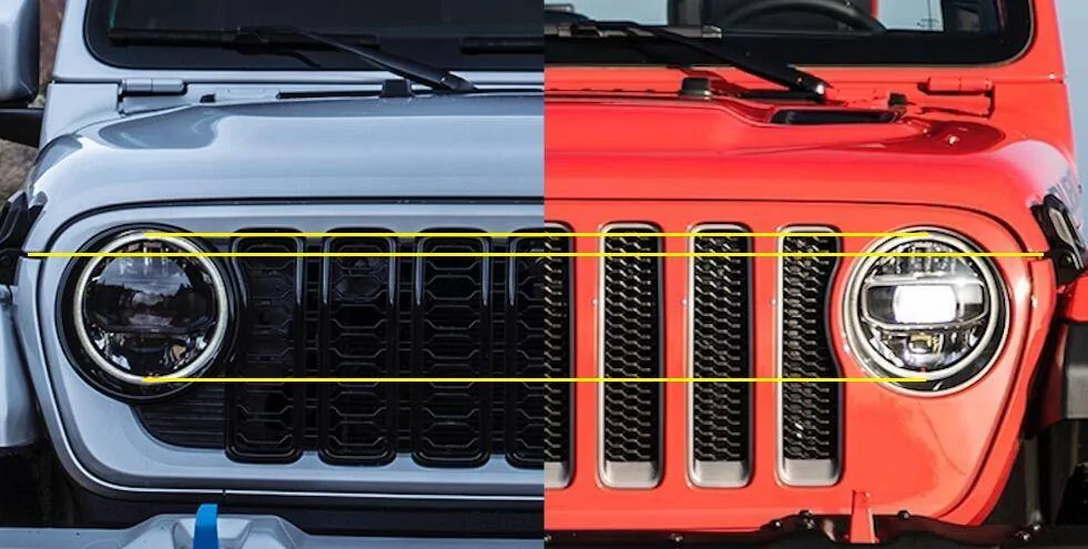

I literally just did this but got different results... Hard to find photos from exactly the same angle so I tried to match headlight size & hood opening gaps.
Cool, you definitely did a better job of that than I did. I had a hard time finding the correct pictures and shared angle as well. If yours is more accurate than it looks like it would have gained a bit more. Not a whole lot, but an increase none the less.
