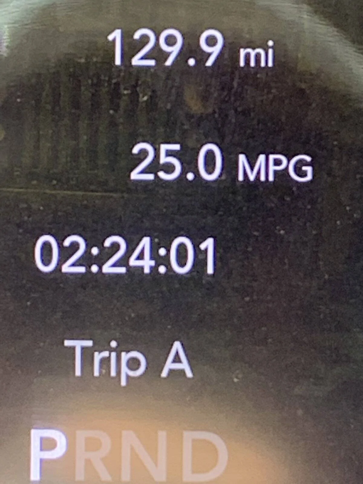

Currently on this tank with 50/50 city/hwy. Not bad for a brick.
Jeep Wrangler JL 13.2 mpg with 37s.... F0B7E9D9-F6B2-4606-AD40-254AF8CC995D

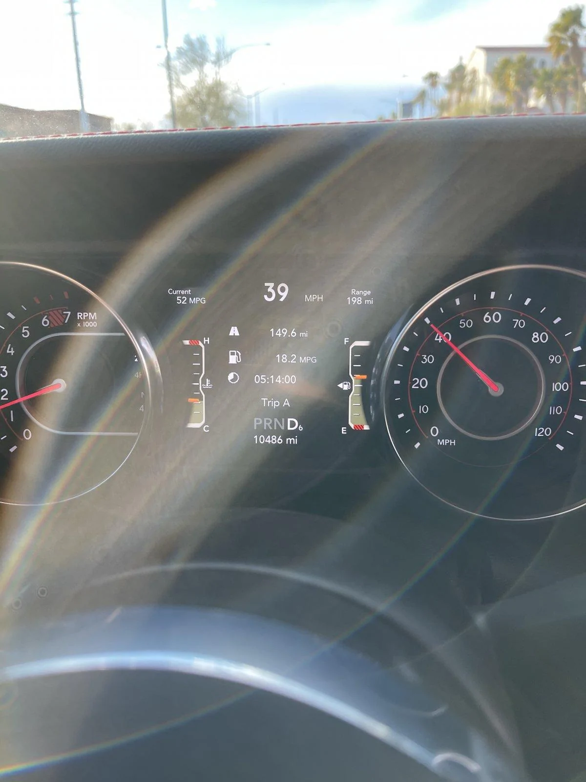

I’m on 4.10:1 gears with BFG 37x12.50R17 at 32psi. I verified my tire size by doing a circumferential rollout C/π = d, programmed my flash calibration tool to the true diameter, verified speedometer with GPS.
I don’t push hard on the throttle and do interstate between 65-75 mph. Currently, I’m getting 18-20mpg on Highway and 16-17mpg city. I’ve been monitoring for the past 6 months.
Jeep Wrangler JL 13.2 mpg with 37s.... 8B997D95-0090-4033-A66D-AE4BFB3249C1
